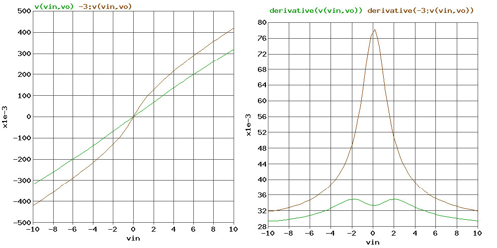

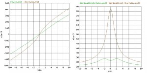

I hope you are feeling well. I'm taking a back seat on this stuff when, I guess, people are invested in a different way of looking at things. Anyway, here is a picture trying one more time to show what I am talking about. This is the simple voltage transfer funtion error of a simple CEF (Vin - Vout) for two bias levels and their derivatives. The distortion is related to the derivative once this output stage is put into a conventional op-amp configuration. The lower plot on the right is biased near the "Bernie Oliver" point where the translinear Vin vs Vout function becomes linear. In the first case there is considerable distortion without any switching necessary. Class "A" just keeps flattening this transfer funtion till the distortion matters less and less.
Where I come from crossover distortion has nothing to do with switching off of one side or the other of an output stage.
Hi Scott,
I wasn't aware that that I had said anything to contradict that. I was a little more excitable a few months back and I could have said things without thinking them through. The doctors have cut my Prednisone back by 50mg a day so I am somewhat more civel now. I am sorry if I was harsh with you and some others here. Roid rage is real.
