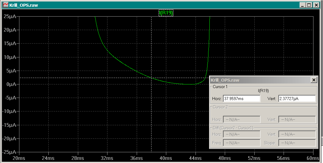

It has been 28 days since I posted the requested files. It looks like no one is going to use the models you posted, so I learned enough about LTspice to run the file Andy_C posted earlier. I have attached my results. I ran the file as posted by Andy, then just for fun, I ran it again with the bias resistor changed from Rbias to 4200 ohms. That is what the text in the lower left indicates the value Rbias is. I was not the least bit surprised to see that if you zoom in on the wave form and do the math, it appears the transistors do not turn off. That is what I have claimed all along. What does surprise me is that changing the bias resistor from Rbias to 4200 ohm changed the results. Does anyone have an explanation for why this happens?

I just tried this out after receiving an email from another poster. There is no difference at all between using .param Rbias 4200 while specifying the resistor as {Rbias} versus specifying it directly as 4200. If there were, LTspice would be broken. I did try it myself.
It does make a difference where the marker is placed on the waveform. If it's in the middle of the approximately flat bottom portion of the trace, you get a few uA as shown in the PDF file you attached. This is shown in a blowup view in the attached graphic at 5 uA/div, 38msec into the sim, same as your PDF in post 138. Compare this with the PDF attachment of your post #138, which is at 30mA/div. That one shows 3.6uA in the data window at the lower right. So it looks like we're pretty close. Thanks for taking the time to do the LTspice simulation.
Edit: The reason the .param was in there is to optimize distortion per the earlier discussions. If you do this:
.step param Rbias list val1 val2 val3 val4
and do a sim with distortion, the LTspice error log file will contain the simulated distortion values for each of val1, val2, and so on.

Oh, just one more thing. I was wondering why I was getting 2.3uA and you were getting 3.6uA at time 38 msec for the same simulation. In looking more closely at the PDF file of your post #138, I saw that you changed the emitter resistor value from my 0.22 Ohms to 0.1 Ohms. This changes the bias current in the output devices from 262.2mA to 347.5mA. The original 262.2mA was the one that minimized distortion per your earlier direction for bias adjustment. After making this change to the higher bias, I got extremely close to your 3.6uA value at 38 msec. Then the current went to a minimum of about 2uA, rather than going to zero as my plot above shows. Maybe it was this change, and not the 4200 Ohm replacement that made the difference?
I need to correct one thing I said earlier. I said I only ran the 4 ohm and 2 ohm sim in LTspice at 1K. The actual frequency I used was 20Hz.

That is a good thing. I probably didn't have the marker at the same point both times. For later runs, I zoomed in close and found the minimum by moving the marker slowly across the wave form.
I changed the emitter resistors to 0.1 ohm because that is what I used in my sims in Intusoft and that was what I had posted in post 127. With my sims in Intusoft, I got the lowest distortion at 202.8ma bias. I changed the bias resistor to get that value with LTspice. That value ended up being 882 ohm. I havent checked the distortion with LTspice yet. I will try to do that today if I have time. I think the small differences in results between Intusoft and LTspice can be attributed to the different models used in the two programs. The change in Rbias was probably made necessary by the use of different transistor for the bias transistors. Does that sound reasonable?
The fact that the results were that close, even with these differences, gives me more faith in the results that can be obtained with simulation.

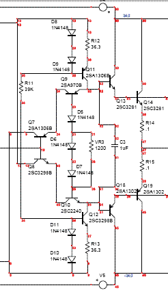

Sorry to jump in late and sorry again if I'm just being thick, but ....
Ignoring for a moment the arguments about charge being sucked out of the output device's bases etc, what the heck is going on with Q7, Q8, Q9 and Q10?
As far as I can see, Q9 and Q10 are being driven at their collectors😕. E.g. Q8's emitter drives Q10's collector:scratch:
For a minute there I thought maybe Q9 and Q10 are supposed to be running saturated, but a quick count of the Vbe voltage drops all round suggests not.
Can someone please explain what's going on there? (or if it was explained in some previous thread, just point me in the right direction)
As far as I can see, Q9 and Q10 are being driven at their collectors. E.g. Q8's emitter drives Q10's collector
Well, it would not be an easy task for anyone to come up with a more nonlinear output stage configuration than this.

as already stated, the "non-switch arrangement" does not do any good in any respect, therefore should be abandoned. As for the Darlington stage, the drivers should be class A biased and the output transistors should be reversed biased, because the drivers alone cannot shut off the base current of the output transistors, moreover, even a small leakage current causes disturbances (the cut-off problems will remain to some extent in any case).
Compared to the single device, the Darlington pair means larger distortion as a price of larger current gain, due to:
Double nonlinear base-emitter junctions
Doubled base-emitter voltage
Limited bandwidth
More phase shift
Slow switching speed (about three times longer turn-off time)
High saturation voltage
LTSpice hasn´t indicated this? Of course not. Being a particularly incompetent tool, it simply cannot, but maybe is an amusing toy for people having much time to waste.

The posted circuit has a bandwidth of over 1MegHz. There is one degree of phase shift at 97KHz.
You seem to frequently make statements criticizing other peoples circuits without any insight into how they operate. You don't like my circuit. That's fine with me, but you would be taken more seriously if you knew what you were talking about.
In the idealized case crossover distortion has nothing to do with the output devices turning off. The logarithmic Vbe modulation between several amps and several micro amps is enough. I still don't get the fixation with "does the output device turn off".
