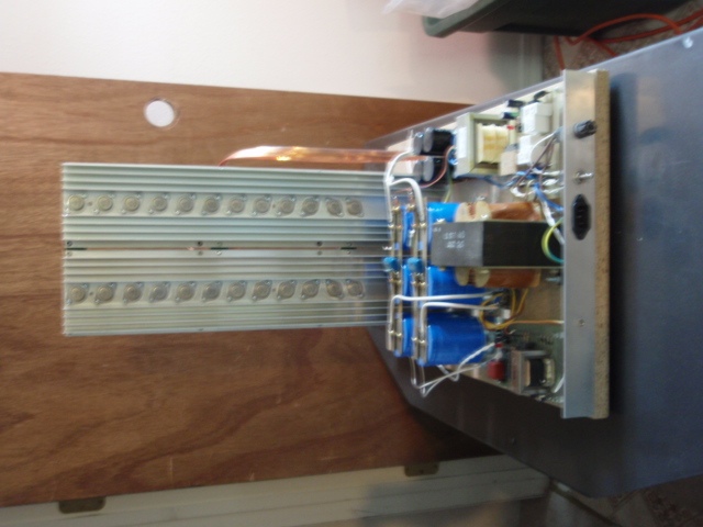

Here's my power amp prototyping board. Right now it's set-up for TO-3 output transistors but I can bolt an aluminum angle to the heatsinks for TO-3P's.
The big power transformer is 90VCT at 1.4 kW. The small transformer is a Signal split-bobbin transformer with a 120 VCT secondary at 0.85A. There are circuits for output fault sensing/speaker protection and soft-start.

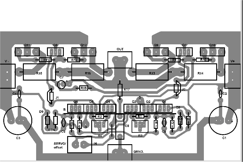

Here is the PCB.. you can use any devices for OP or drivers,
to-126 or 220 (just "flip em' around") ECB/BCE.
Nifty SMD bias in 1 X1 " board with trimmer.
http://71.203.210.93/pdf1/Electronics/Projects/Audio_amp/Krill/
File is ... krill_pcb_artwork.zip (1.33meg)
ALL modifications are included BUT can be omitted if desired.
Schema explains options.
Any errors, please notify. (but I doubt it. 🙂 )
OS
OS

Whats up,chris.. You can use any of the to-3p or to247's
for op , 220uf or 470uf decoupling caps , LED or diode CCS,
decoupling AT CCS.
Just a "universal" OPS board ... I might even try a pair of
OPA445's to drive these.
Please don't bother with the large .BMP's , just the
krill_ops_artwork.zip ...everything is in there!!!
OS
