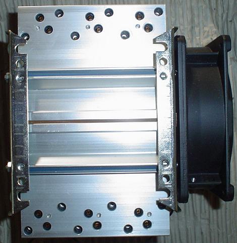

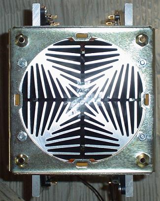

Last time i was there i bought a number of both A and B models, as they were so affordable.
I've used a large B-type assembly for the A100 boards MikeW gave me, still need to build a case big enough to hold the 12" high heatsink setup.
Pictures of the A-model were also posted at the KSA100 thread, well over a year ago.
As most others, i've had to wait so long for the CRDs of the KSA100 that i started other amp projects, still need to finish the Krill the moment the active project list is blank again.
As you can see from the picture, these are not stacked modular ones as in the sheet Samoloko linked to, but have a single heatsink in each quadrant.
Better this way, less temperature diference between the two ends of the heatsinks.
(i'll use all 12 output device mounting positions, i'm not going fancy TO3 on the KSA100 and there's both a thermal and Hfe advantage to use 12 instead of 8 Motorola metal can devices)
