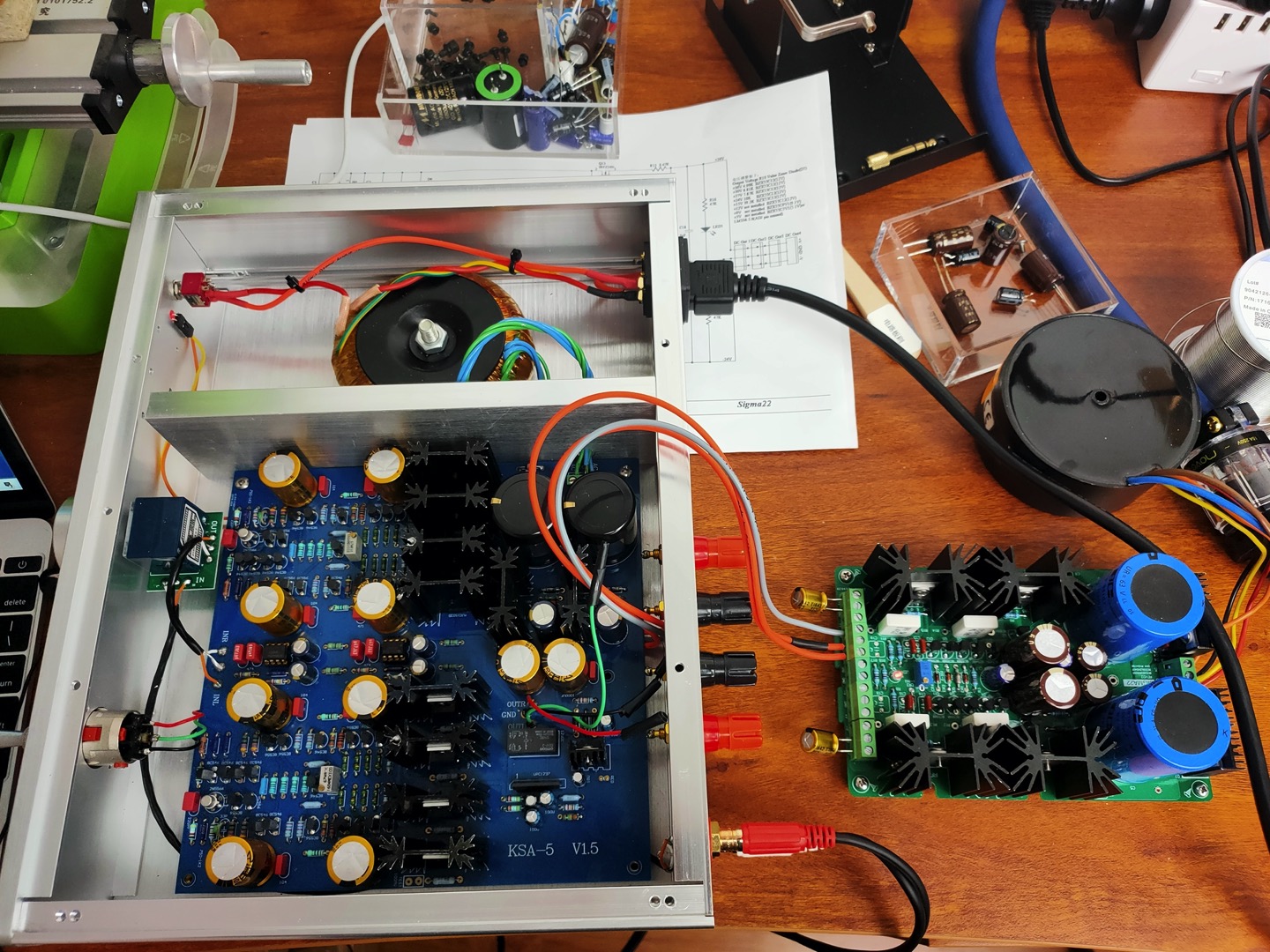

Greening KSA-5 clone: a weekend project
I built my KSA-5 clone back in 2013 but was never satisfied with it. I made every effort to make it look and perform well. It was well within the original KSA-5's specs, yet, although it worked well with my 32ohm Grado headphones, it could not compete with Musical Fidelity's X-CANv8. Connected to a pair of 8ohm speakers, the clone would become rather confused with anything but simplest music. Because of this, the amplifier fell into disuse and was gathering dust on my rack.
Until this weekend.
This weekend, I finally got around to make KSA-5 work for me. I kept the overall topology and the PCB, only changing some passive parts. The results are quite remarkable:
Until this weekend.

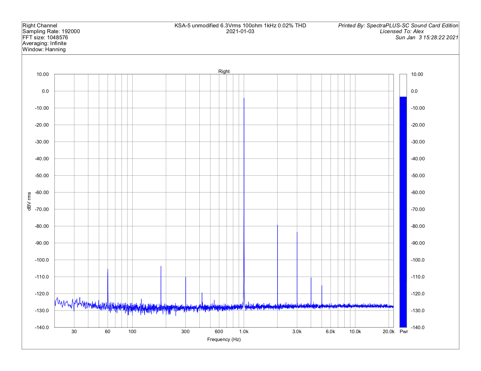

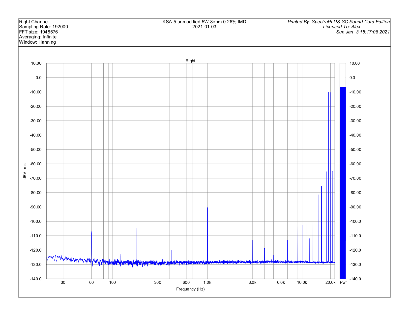

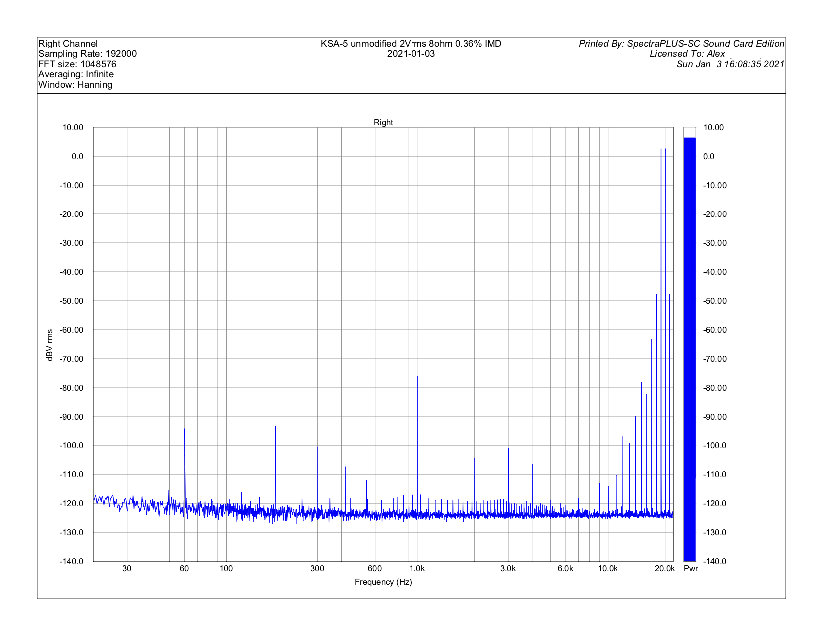

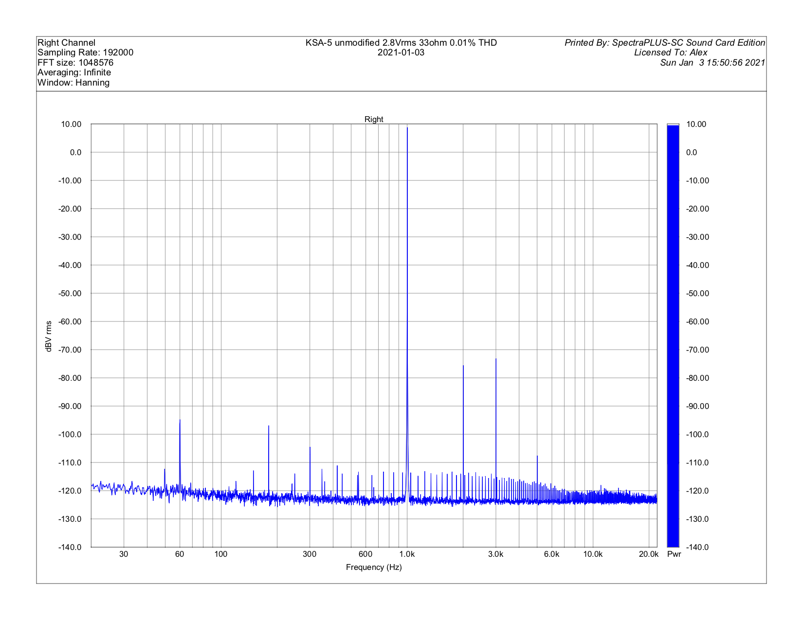

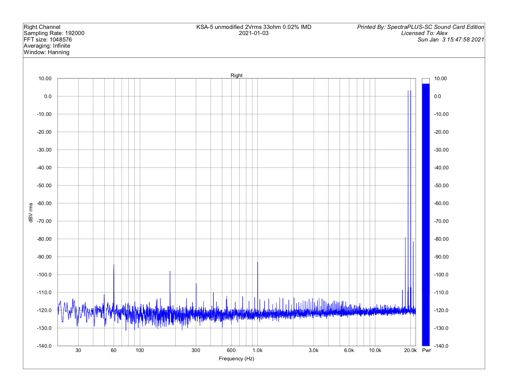

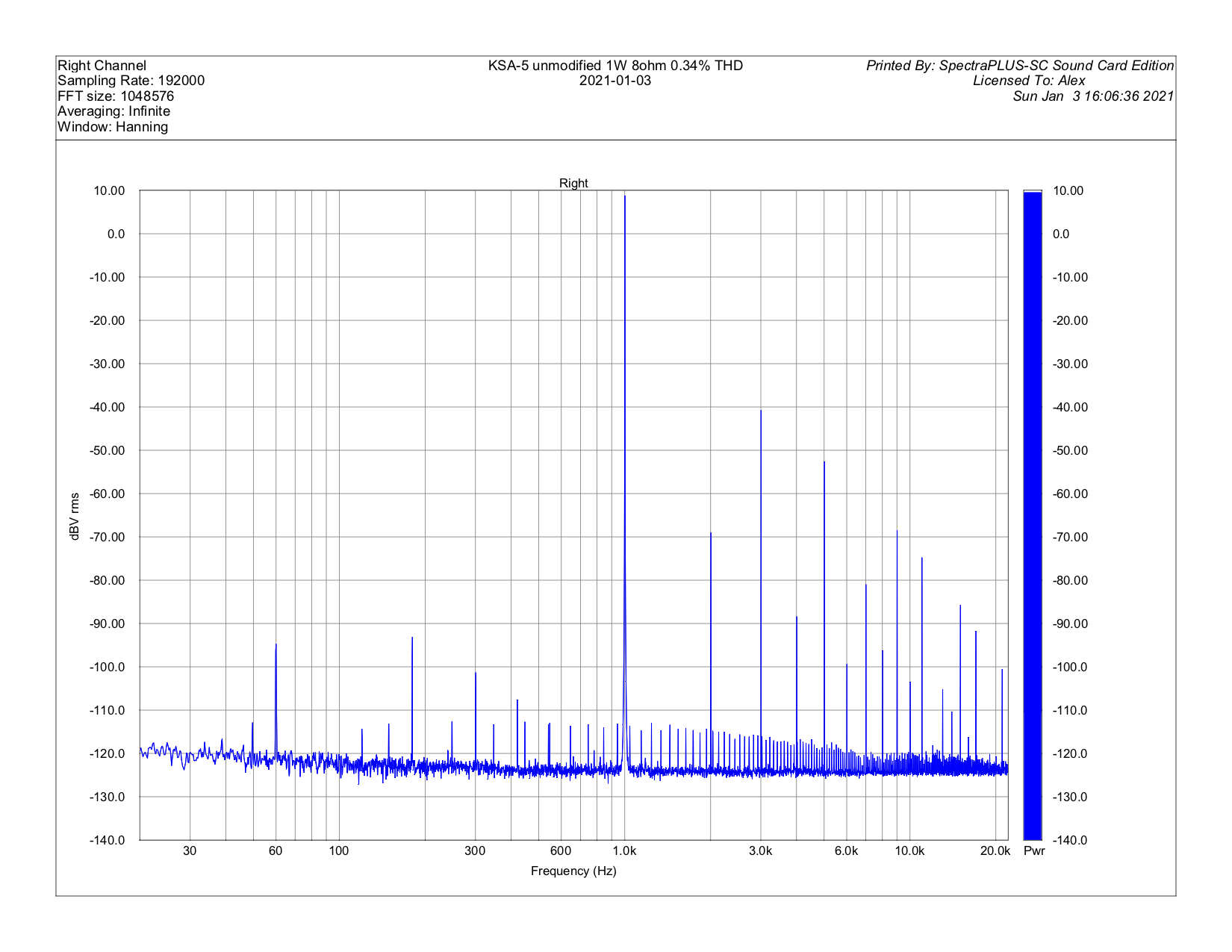

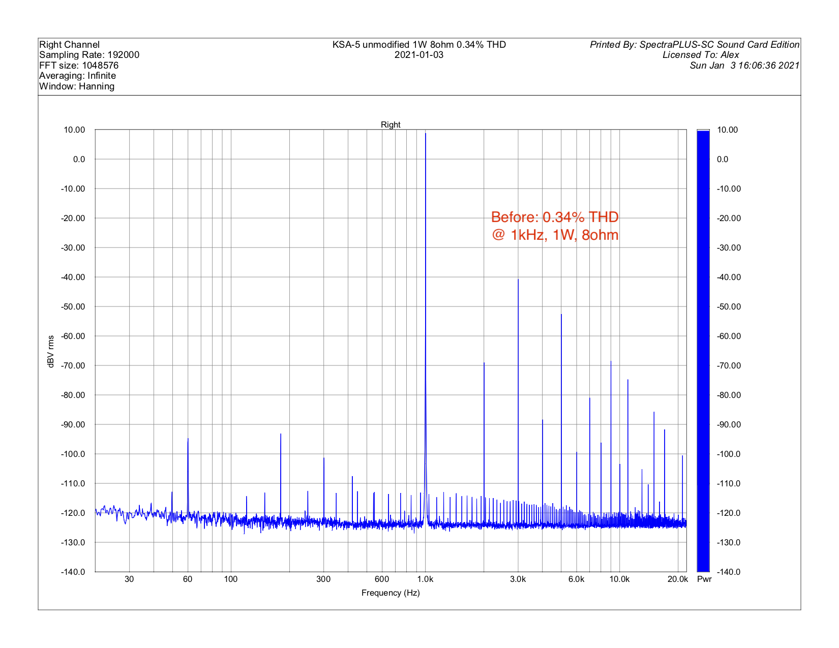

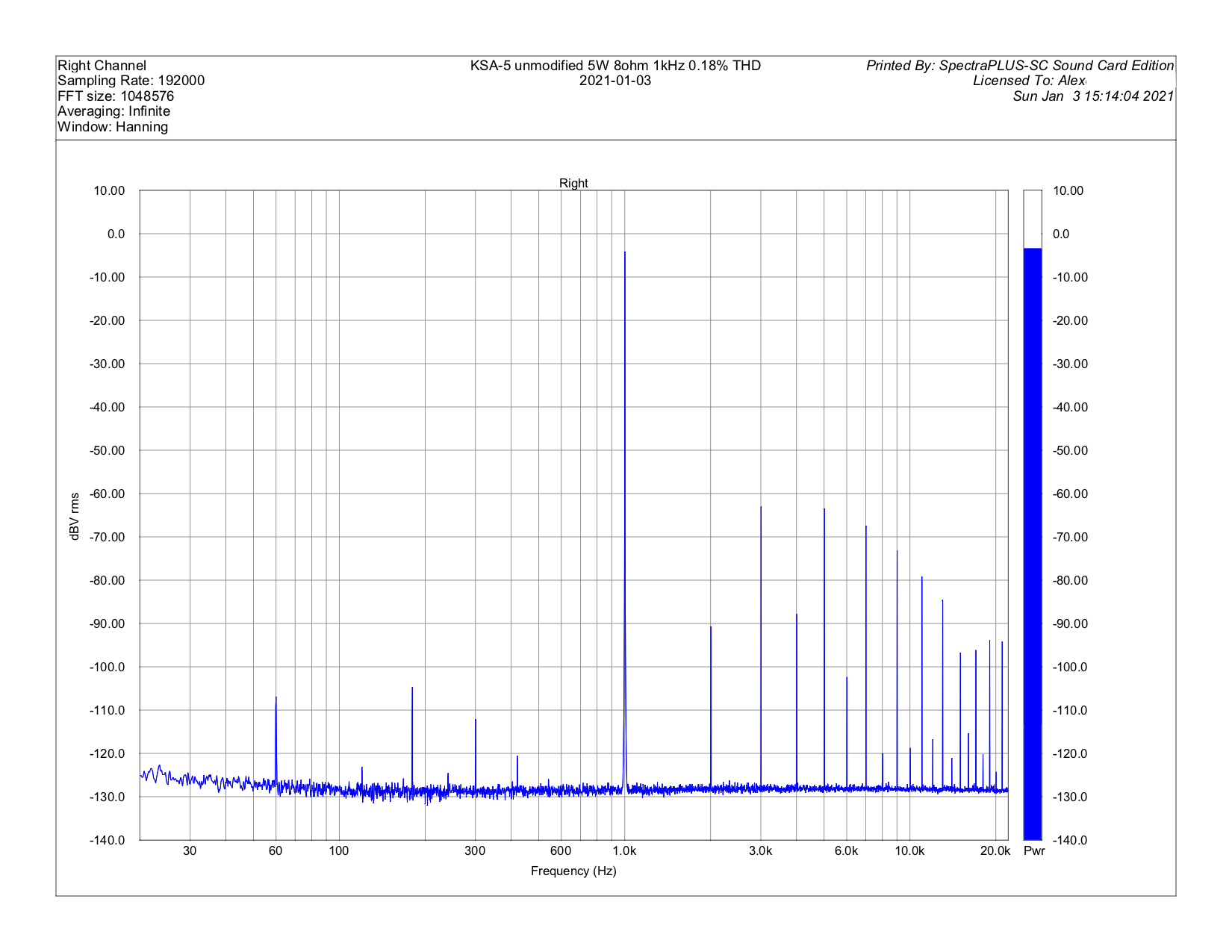

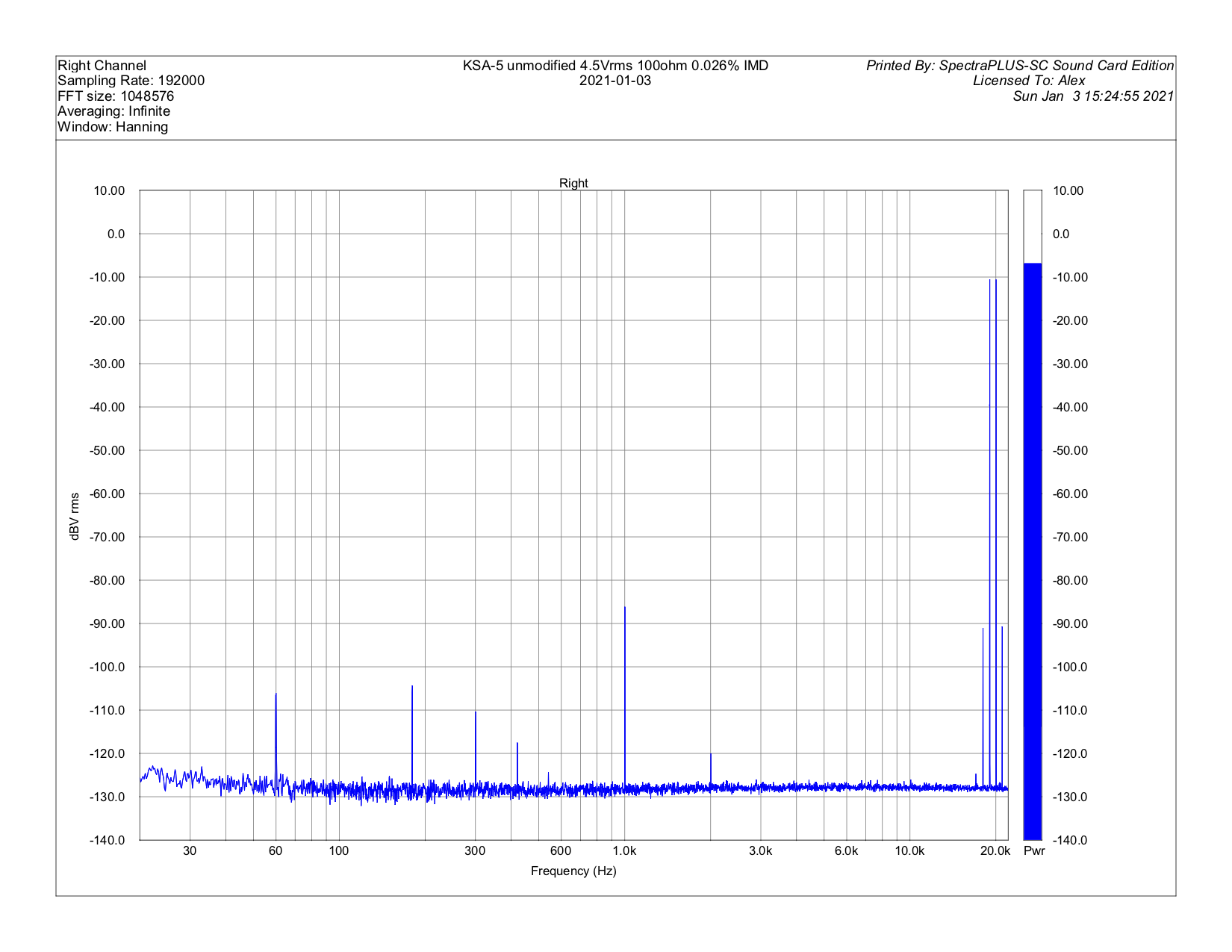

Distortion performance of unmodified clone
The measured distortion performance of unmodified clone confirms what was clear in listening sessions. It works ok with high impedance loads but is completely confused with lower impedances - see the charts.
Even with a 100ohm load, the distortion at 1kHz is 0.02%, or -74dB, equivalent to 12 bit resolution.

So KSA-5 never leaves Class A with a 100ohm load. Once it does, the distortion soars. No wonder the owner's manual warns not to connect the KSA-5 to any loudspeakers 😉

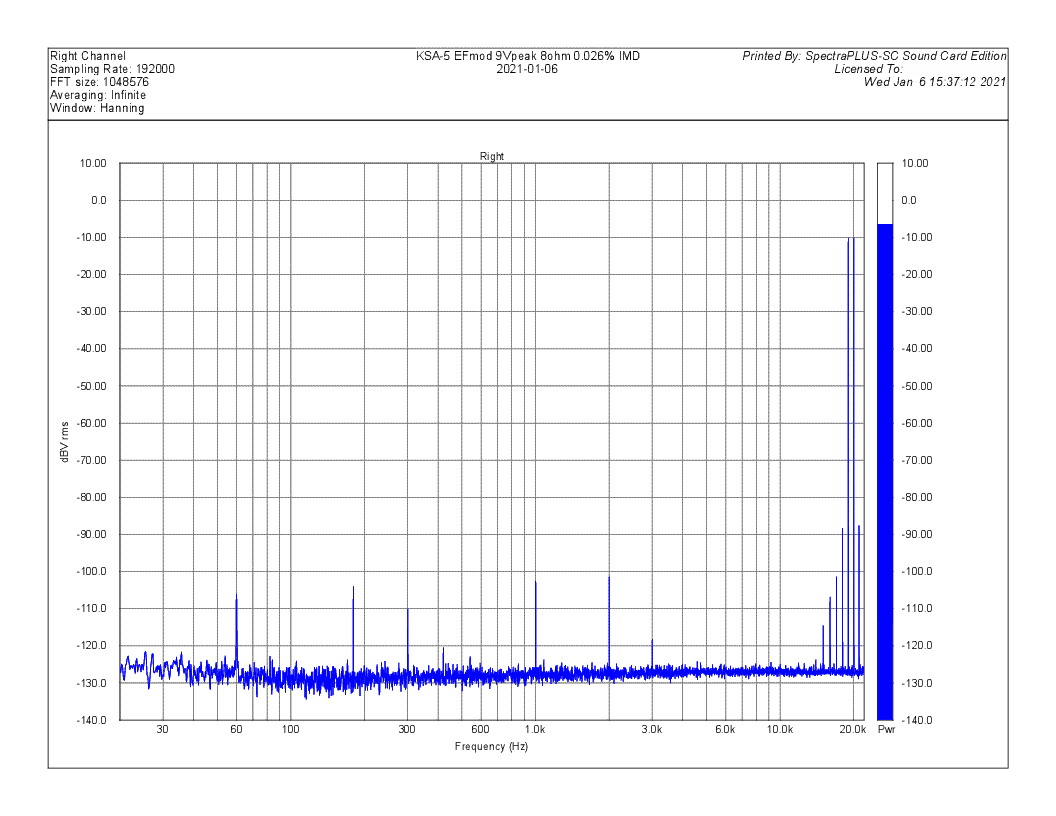

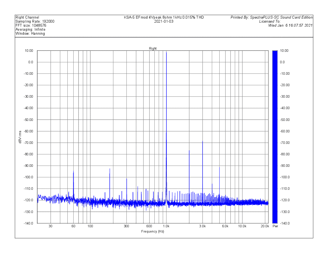

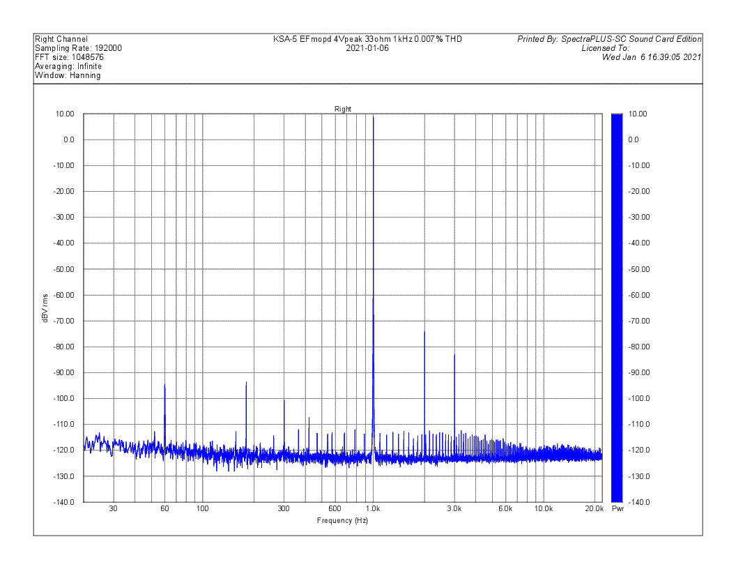

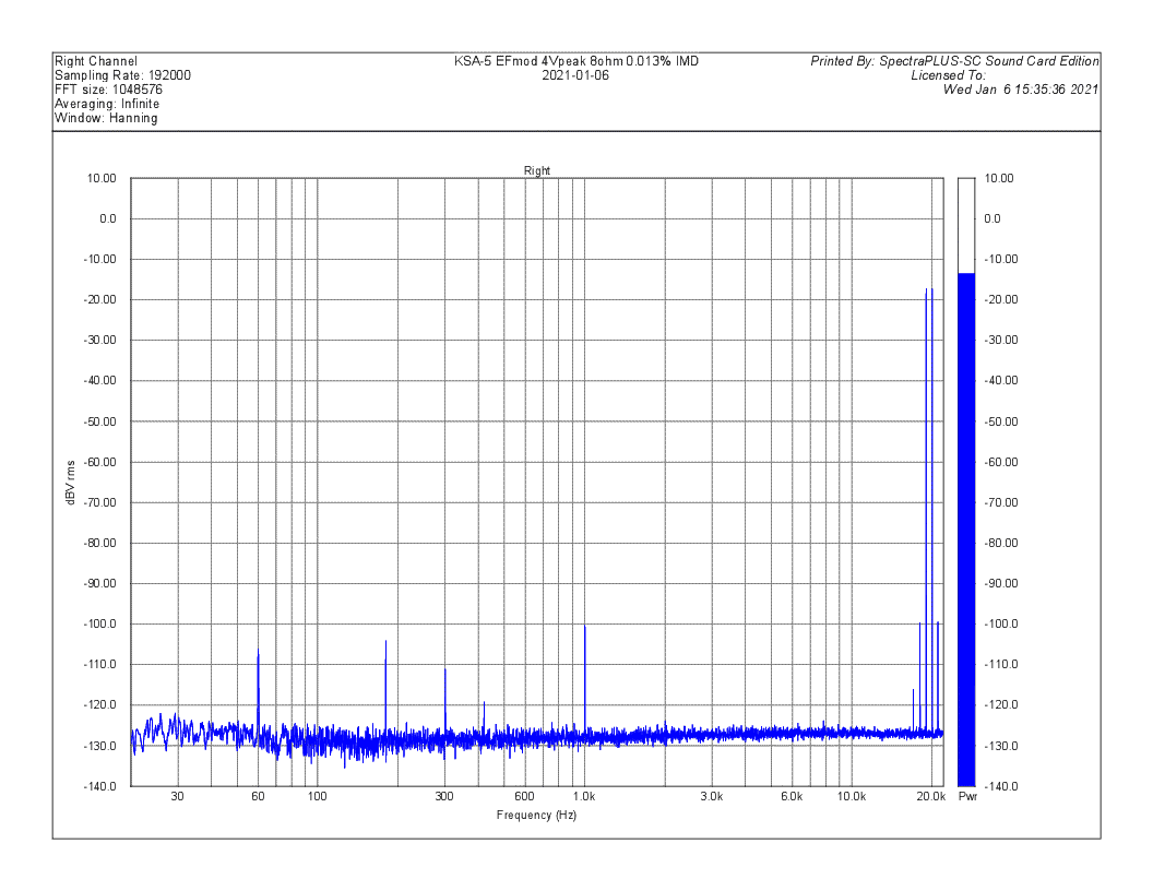

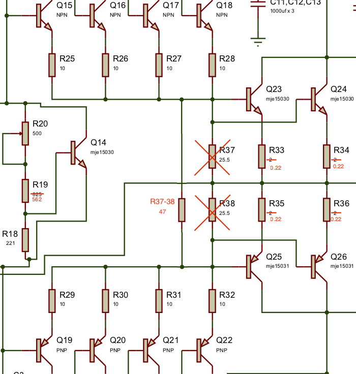

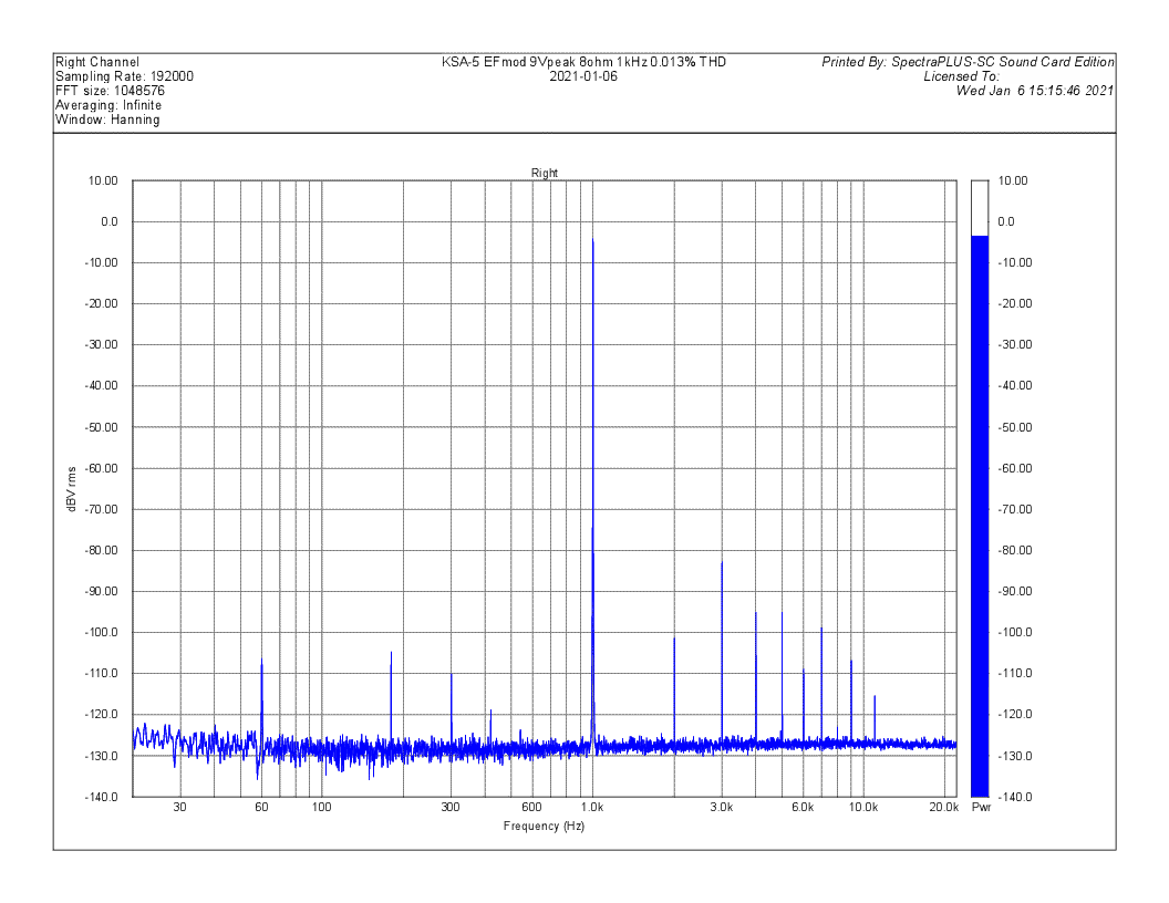

Let me first modify the output stage. The mod affects only the performance with lower impedance loads, and even there it can take us only so far, but it is a start. The front end modification that increases the feedback loop gain will be posted separately.
The changes are simple:

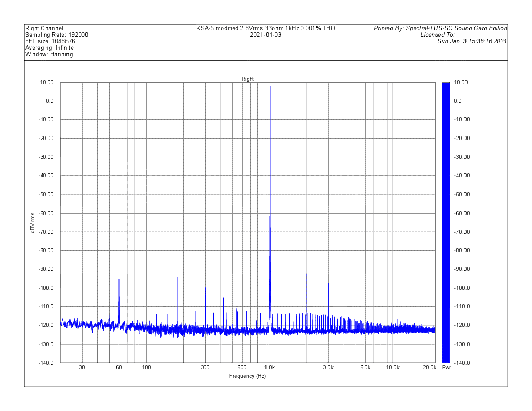

The distortion into low impedance loads is improved (see also attached spectra):
- R33-R36 are replaced with 0.22ohm 3W resistors
- R19 is reduced to 470..560ohm to allow proper biasing
- R37-R38 are replaced by a single 47..51ohm resistor
- 8ohm 1W THD 0.34% -> 0.015%
- 8ohm 5W THD 0.18.% -> 0.013%
- 33ohm 2.8Vrms THD 0.01% -> 0.07%

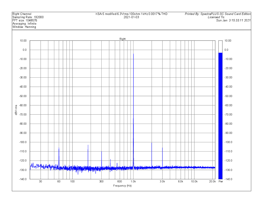

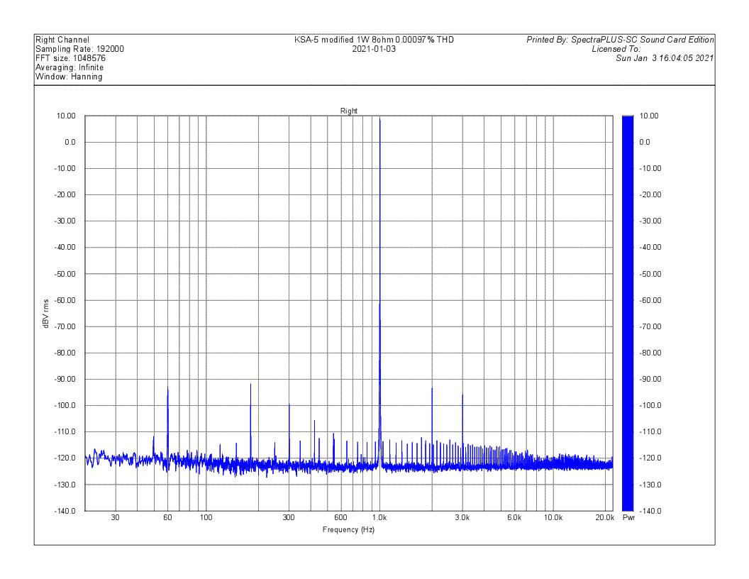

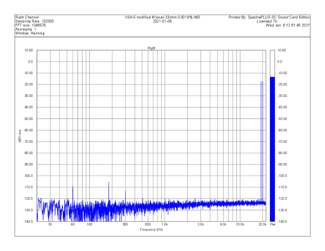

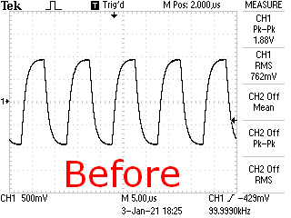

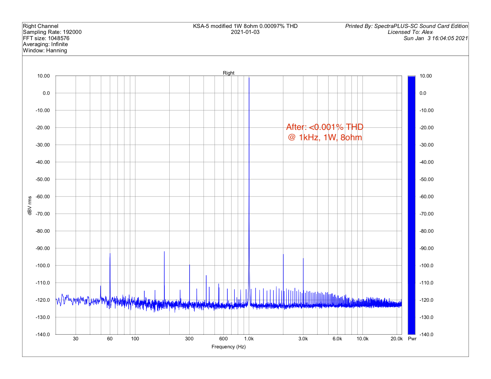

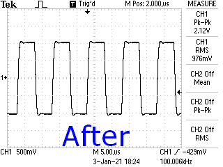

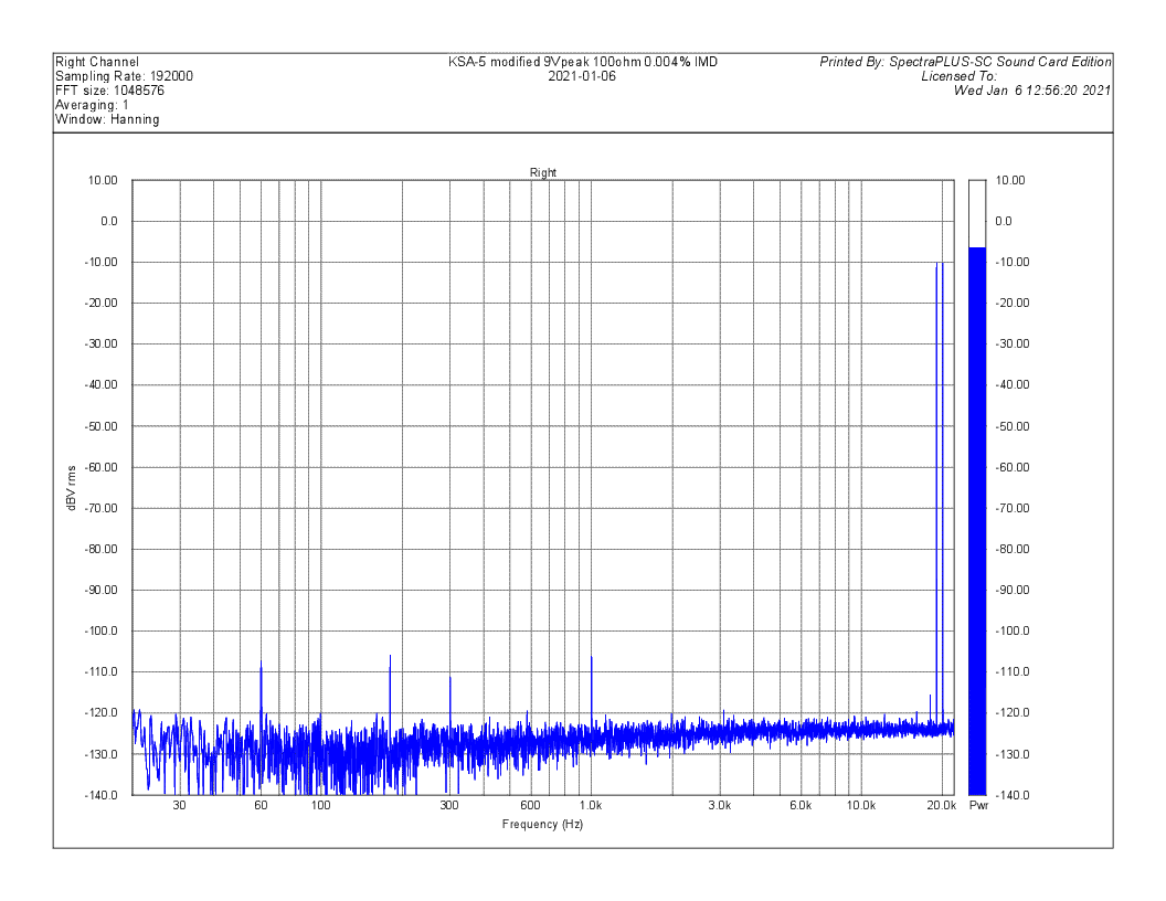

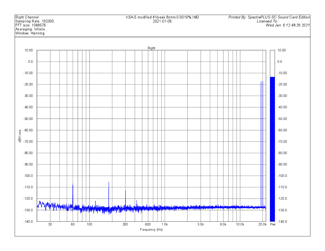

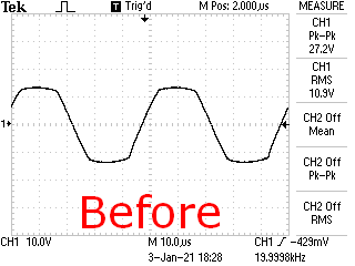

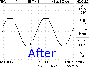

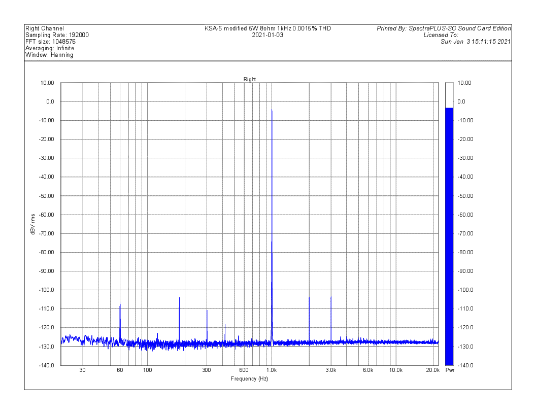

I completed the full (output stage + loop gain, details will follow shortly) modification of the second channel, took some measurements and briefly listened to it.
I tested the modified KSA-5 with Sennheiser HD595 (50ohm), Grado GS1000 (32ohm) and, for the heck of it, with B&W 602.5 8ohm floorstanding speakers. The amplifier performs flawlessly in each case and is a massive upgrade over the original. In a brief head-to-head comparison against Musical Fidelity X-CANv8, the sonics were somewhat different, but without a clear preference one way or the other.
On measurements, the amplifiers now has at least 50dB of loop gain across al audio range and a correspondingly low distortion - more than two orders of magnitude lower than unmodified - across different loads. The level distortion is similar to that of the input JFET buffer alone or, say, to that of First Watt B1, which is a JFET buffet. In fact, I believe that buffer is what now limits the distortion performance.
Measurements (THD @ 1kHz and IMD @ 19+20kHz) with 8, 33 and 100 ohm loads are attached.

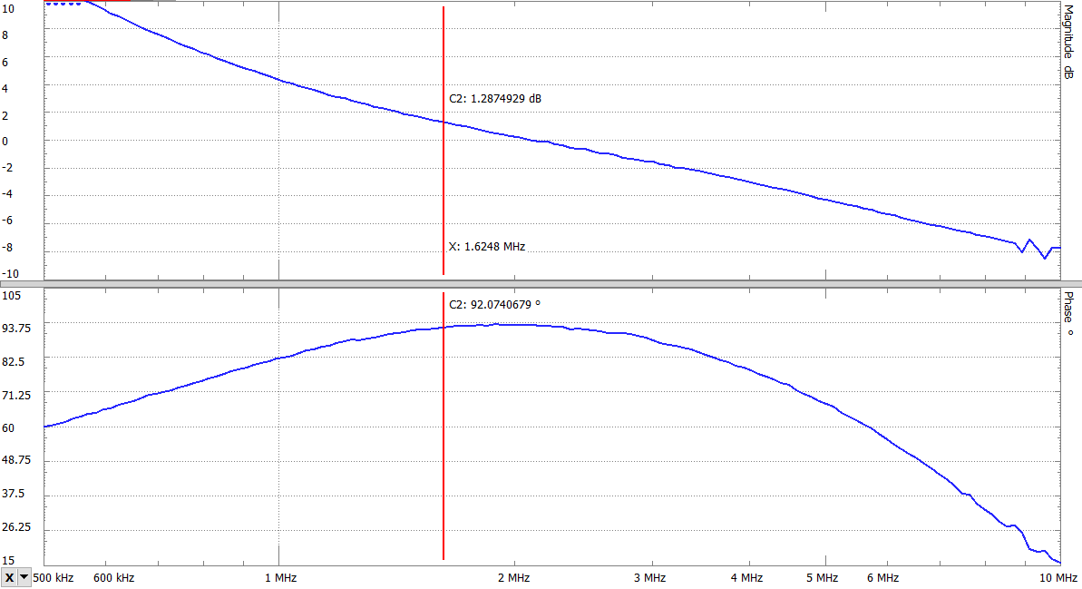

Stability with the high loop gain is not a problem, either. The amp clips nicely, handles fast square wave very well, and has ample phase margin - see attachments.
