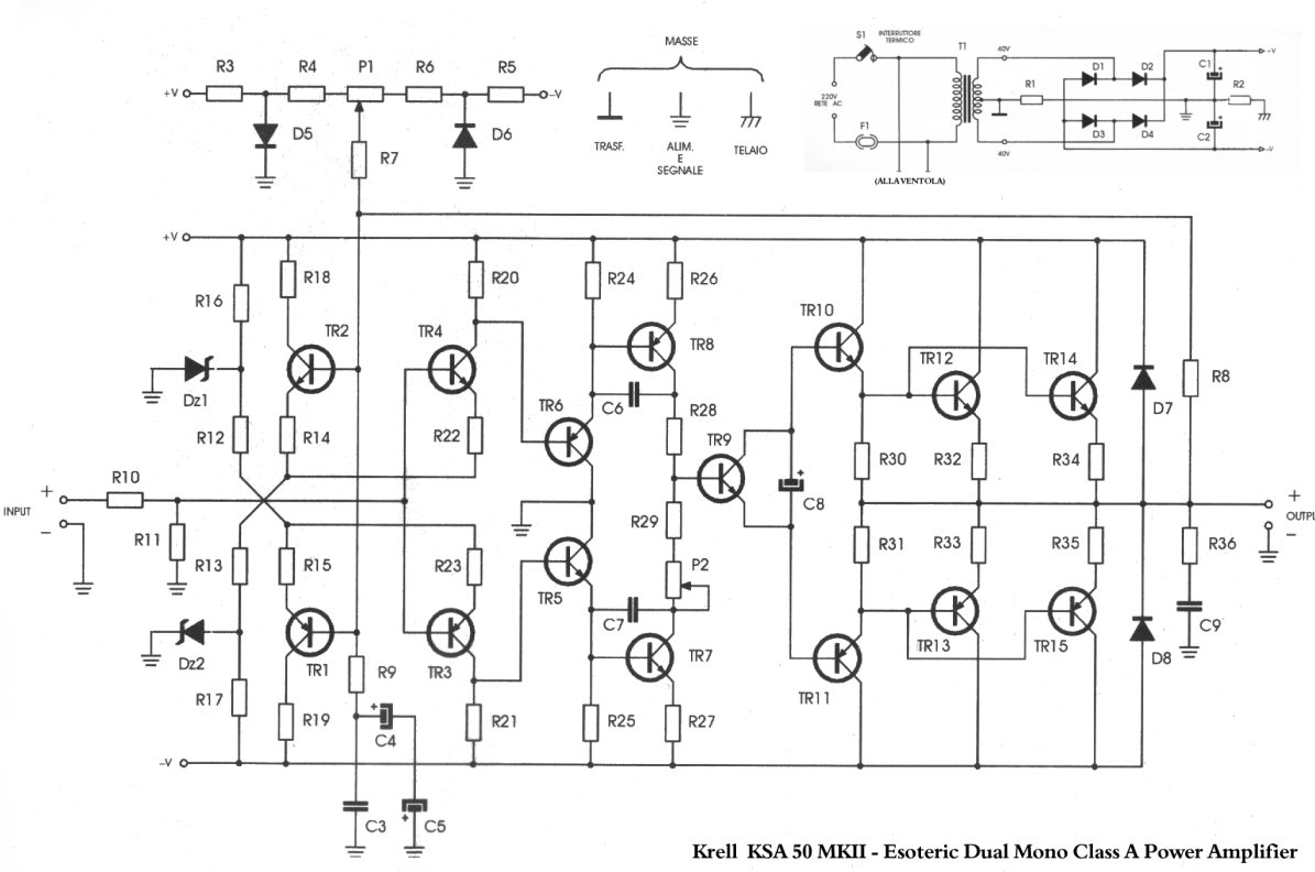

Anyway, here's another schema I found. Looks similar to what we have already:

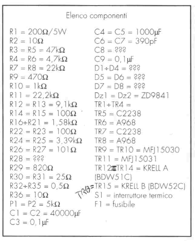

BDW51/52C's are the Krell logo devices?
Those are older than Dan the Man, at only 125 watts i can think of Motorola's that were better from those years.
That's the one we based everything on... Thats why it's almost spot on 🙂 It (to me) looks like the most authentic.... also with the part list... also authentic..... in my eyes anyway, the other one (i posted before) was made in Nov 2004.... however i'm not sure how right it is..... i don't know that the differences would give a different sound anyway, so it may not matter... what does matter is that our amps sound pretty good 🙂
Aaron

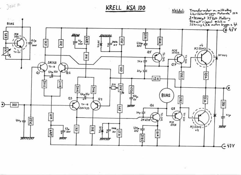

[edit] according to the schematics i have for the KSA-50 and KSA-100 off the same site (the one i posted a few pages ago), they are identical! Everything but the resistor values, and 1 set of caps is turned around... Leads me to believe something is up with the "newer" schematic... the KSA-50 and KSA-100 mainboards look very different.... the KSA-100 i thought had stacks of diodes in it, etc but there are hardly any in this version....i'm confused as to how it could be so different?

Here's a KSA-100 one i also have... which is interesting...
