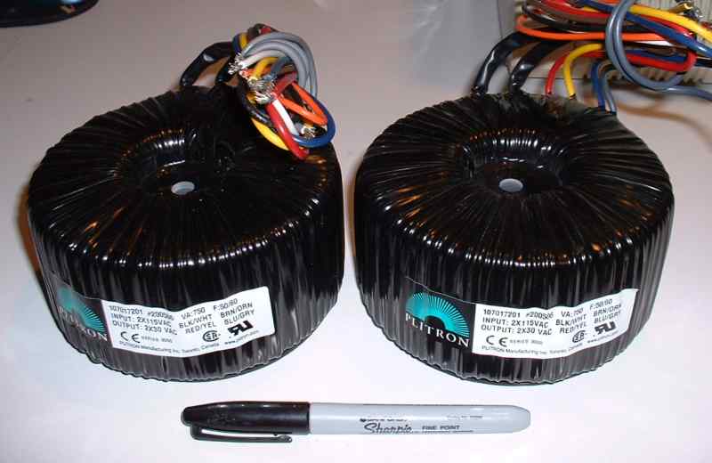

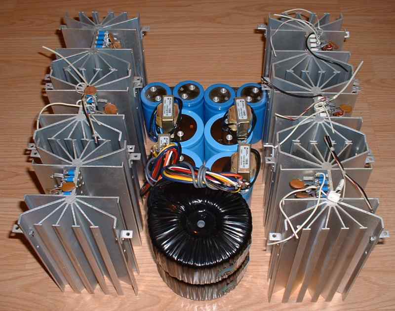

Here my big parts for the amp. Two big 750VA Plitron transfo, 8 caps and 1.5mH, 5A chokes for a CLC filters, 6 big heatsinks (2 fets per heatsink) and two 10A EMI filters.
I'm planning a dual sections central casing (like Lamm amps).
I 'll put the soft start PCB, EMI filters, dual rectifiers per channel, the first Caps section and the chokes under a bottom section.
Then the two big transfo, the final caps and the PCB on the top.
I'll try also the build an balanced receivers pcb to have balanced and single ended inputs.
The total width will be 16.5 inches. So the complete amp will be 19" rack size.

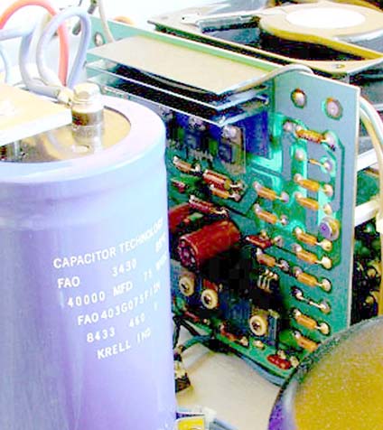

Can anyone tell me the values of c5 and c6 on the original kas50 board. The ones I have removed from my amp are marked roe 1000/16 s8 ek, acording to Lloyd Macleans drawings they should be 100uf. My amp is a 240v type but I am assuming all the boards are the same. also the bias on my amp is about 440mv but acording to the same drawings it should be 620mv.Lloyd if you read this post maybe you could comment.
Finaly can anyone tell me a supplyer for 40000uf 75vdc caps.
Many thanks Iain

They are 16v 1000uf caps...
Can you look at the board and tell us the writing on the C6/C7 - they are near the "drivers" on the main board and are usually a dark purplely/red colour.... This is a value we have been desperately seeking as to what it actually is!! Can you help with that?
THanks
Aaron
"Can you look at the board and tell us the writing on the C6/C7 - they are near the "drivers" on the main board and are usually a dark purplely/red colour.... This is a value we have been desperately seeking as to what it actually is!! Can you help with that?"
I don't think we are all that desperate! The values specified on Jan's drawing works just fine. At least one person in this thread has used 39 pf caps in place of the 390's. I used 330pf in mine, it sounds just like a Krell! The original Krell KSA-50's and even the KSA-100 Mk-2 did not have the 100 pf caps, C107 and C108 as per the drawings on Lloyd Mclean's site here......http://home.ca.inter.net/~lloyd.maclean/Krell/Krell.htm
You could probably leave them out without any problem.
Mark

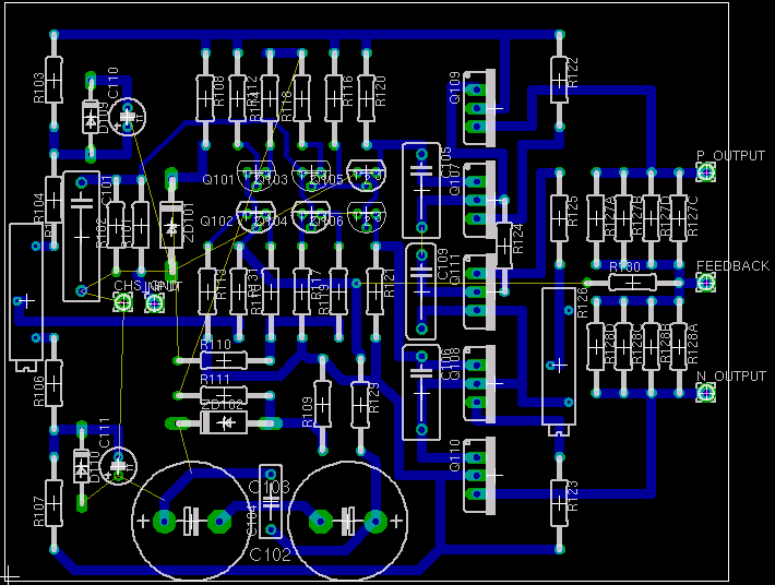

Well, my original plan was to etch my own pcbs with Jan's design, but as I am still waiting for some parts, and some parts I have are slightly different to the reference design, I thought I would have a go at rolling my own...
Below is the result. It was a little difficult fitting everything in with the free version of Eagle, but I like a challenge! This is still a work in progress however, so don't just copy it and use it. I have swapped the trimmers for Bourns, and R127 and R128 have facility for mounting several lower wattage versions in parallel. I tried to get all the power transistors in a nice line for heatsinking, as on the original, and I also lost the 100p caps on Q109 and Q110. If needed, I will just solder them on underneath. R124 is also mounted on the bottom. Oh, and the I/V protection has gone. ;)
I am thinking of using a double sided board, with the whole of the top layer, (apart from the feedback trace) being a groundplane. Any opinions?
