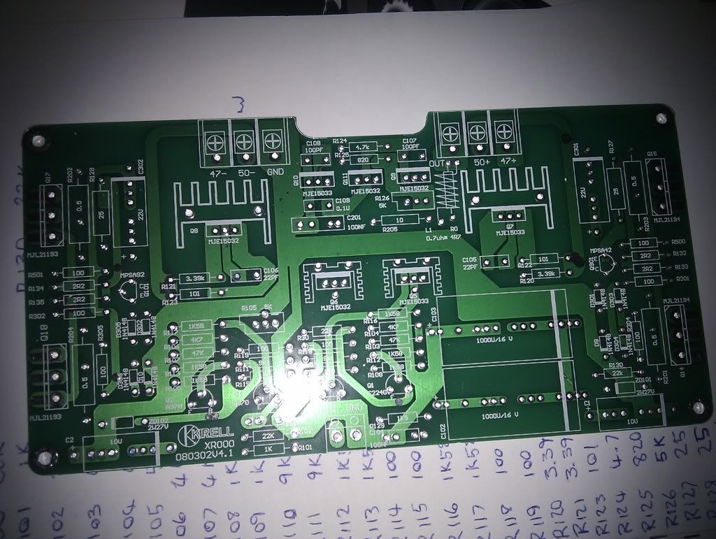

Hi, I’m probably going to look stupid here but I’m relatively new to electronics in general.
I’ve been looking at starting an amplifier project and reading through this thread with interest.
Could someone please explain why the KSA50 based boards from tubeshunter on eBay have +/- 47v and +/-50v?
Thanks,
Charlie

Probably because they are not KSA50 PCBs.
They might be copies of clones of a particular version of the KSA50.
Perhaps a higher voltage for driver stage and lower for output stage ? Like the KSA-100?
Have you bought them ?
Did you get a circuit diagram?
Hi, yes I have bought them, but I haven’t received them yet. Any opinions on giving them a go or should I just sell them on and buy something better? What would be the best way to go about providing the two different voltages?
I’ll let you know what they come with when I get them.

How would I go about creating a power supply with the two voltages needed?
For a mere 3 Volts difference chances are you don't need 2 different voltages at all; likely that only the frontend runs a little higher to allow the outputs closest swing to the rails (maximum output).
Especially bipolar outputs don't really need that as they swing to within 1 V of the rails; only a noticable issue for mosfet outputs with their 3-4 V turn on VGS.
When you got the schematic one could check for sure.
Thanks I was thinking the difference of 3v probably wouldn’t matter too much, probably bigger fluctuations in the mains in my house, lights go dim for a few seconds sometimes and power cuts happen all the time! Hopefully they will come with schematics and more info.

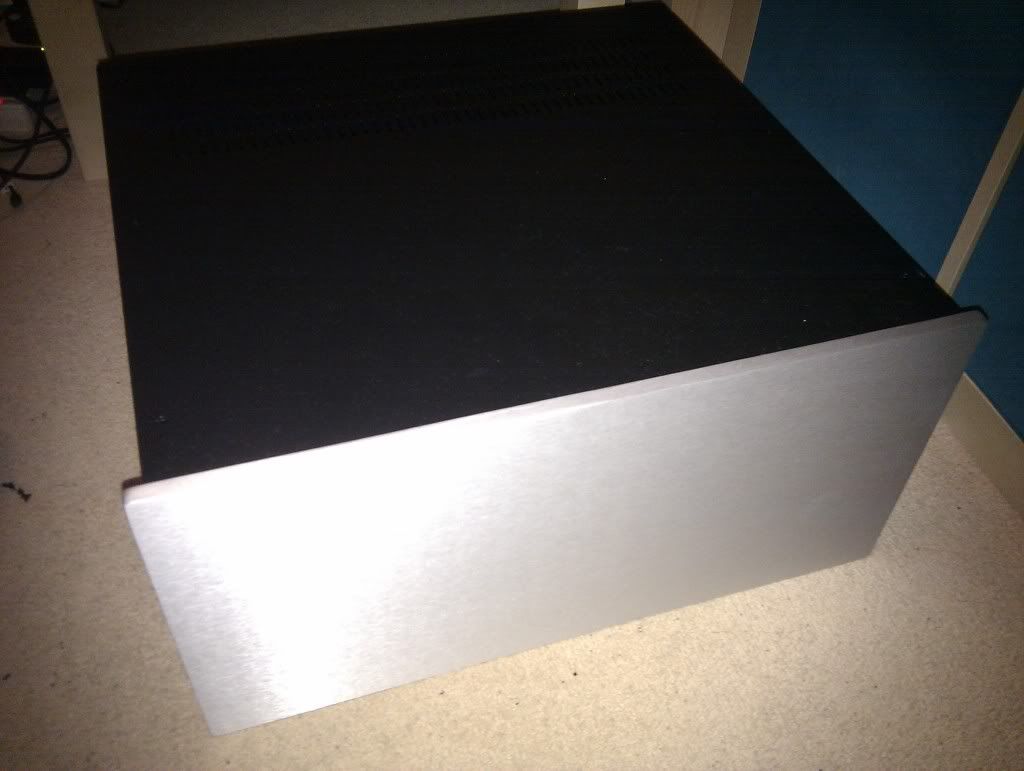

Hi, the Chinese boards arrived today, they look quite good quality but they didn’t have anything with them, not even a packing note. I’ve emailed the seller to see if they have any more info and a schematic.
I’ve been trying to make a parts list and comparing it to the boards in this thread, seem quite a bit different, might give them a go anyway though.
Modushop.biz case also arrived today, looks lovely!
