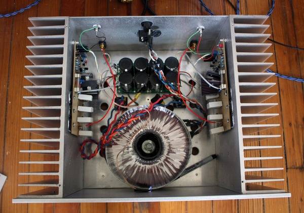

Re: My hot KSA-50 clone
While a lot of people here have made the Krell clones, I don't recall seeing that one and the components and board don't look quite right....And the link you posted does not indicate that the same board was implemented by a 'member' here, as far as I can tell by looking at the pics (which appear not relevant). What do you mean 'suggested bias'? The bias is as suggested on the krell clone wiki.
What are your DC voltages and give us a close up of those boards!
Yes, and are those pics accurate? Is there STILL a pen under that transformer? Why?
I do not think that anyone here made that thing...but I could be wrong. I think someone may have claimed to build that based on something here but it appears to be way off.
But again, I could be wrong.
audiophile321 said:Still looking for the correct schematic and suggested bias for this version of the KSA-50 clone. I'd like to talk to the builder if he sees this. I've attached a pic of the interior.
Thanks in advance for any help.
Jim

Hot running amp
Hi lgreen,
The seller on audiogon did tell me that the amp was build by a member here, but who knows? I've been crazy busy for the last week and haven't had any time to dig in to this amp. I will try to upload a close up of one of the boards tonight and check the supply rail voltage.
The amp was damaged by the shipper and the back panel got caved in which isn't the end of the world as I'd like to upgrade the RCAs and speaker terminals any way. The toroid isn't tightly mounted and I assumed this was from rough handling by the shipper but that may explain the pen in the seller's pic I'd attached.
The seller didn't include the pen with the amp, should I feel jipped? 🙂

Re: Hot running amp
Well, the case seems ok...but maybe not for a ksa-50. Lets see some pics when you have a chance.

Ksa-50
Well since there are only 4 boards like that...I would say someone dissassembled my 4 channel Krell ...🙁
Wonder what happened to the case...transformer...heat sinks..

Hot KSA50 measurements
I finally got to check some voltages in my hot amp and here's what I found:
Supply voltage is +/- 36VDC
The emitter resistors are .47 ohm and the average volt drop is 330mv and closely matched.
There are 3 pairs of output transistors per channel so if my calculations are right the total dissipation at idle is 153 watts per channel.
This all seems correct to me so I'm thinking the heat sinks aren't large enough to safely run at 50 watts class A.
Any thoughts?
BTW, measurements were taken after the amp had been on for 15 minutes and temperature had stabilized.

Hot amp
Hi zlast,
The output transistors were 165F on the right channel and 185F on the left, the heat sinks as I recall were about 20 degrees cooler. Also of concern, at least one of the right driver transistors is getting to 200F (I can't get a good measurement on the lower one)

Re: Hot amp
why are L & R operating at different temperatures?
The driver dissipation is dependent on the Re value between the drivers.
To reduce driver temperatures either increase their heatsink or increase the Re.
