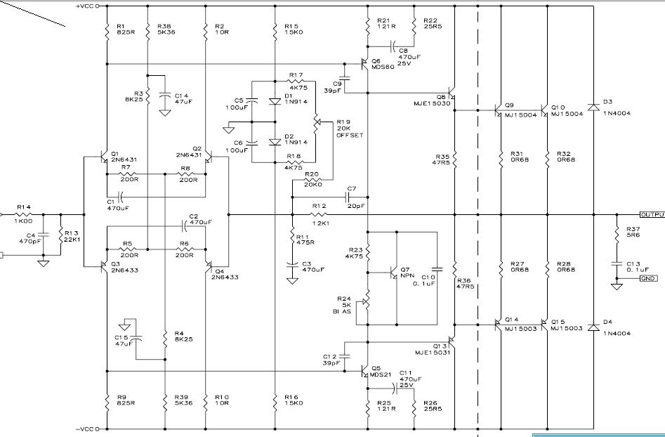

this is the 1983 version of krell..i will use bc546/556 for inputs and mje340/350 for the driver of mje15030/31 and finally for the outputs i will use mjl1302/3281 or njw1302/3281..because i dont have mjl21194/21193 now.someone says mjl21193/94 is one of the most reliable transistors for class a mode..but i will try quarter class a mode.
it depends on the load and the peak output current.umut1001 said:krell ksa100..can it drive 4pairs of output transistors with only a pair of mje15030-31?
If you use no lower than 4ohm speakers then 1pair of drivers can feed any number of output devices.

why delta audio circuit has cascaded mje15030-31 ? what is the purpose? the lower count component is better.isnt it ?
I cannot see cascaded 15030/1.
I see 15032/3 as the VAS stage and 15032/3 as the driver stage.
I also see 15032/3 as the EF stage preceding the VAS, but I consider this a bad selection of device for this duty.
yes i made mistake its 15032/33.. is the Post #7698 more reliable for my application? it has lower quantity parts.i will use only 2pairs output transistors..thanks

Yes it can, but you do not need to use four output devices if you are going to use class AB. Bias output at about 120 mA, it will run warm but stable.
You will not hear unmatched transistors, use the 1503/1 as you bought them, adjust off-set to minimum and it will be fine.
You will find off-set drift with temperature so do final adjustment when amp is at stable temperature after say 1/2 hour or so.
umut1001 said:yes i made mistake its 15032/33.. is the Post #7698 more reliable for my application? it has lower quantity parts.i will use only 2pairs output transistors..thanks
Since you will operate at a moderate supply, I find that the BD139/140 has a "nicer" sound as VAS. The purpose of many output devices is to spread SOA over multiple transistors, this is especially valid for long term or DC use such as class A.
When running class AB then SOA is dependent on instantaneous current, the demand on the output devices does not even approach the continuous demand of class A.
Finally to check bias setting and correct operation of Vbe multiplier, measure the current through output devices at idle, then heat the heat sink with heat gun. When heating then current through devices should drop the hotter it gets, if it increases then you have a possibility of thermal runaway situation.

umut1001 said:this is the 1983 version of krell..i will use bc546/556 for inputs and mje340/350 for the driver of mje15030/31 and finally for the outputs i will use mjl1302/3281 or njw1302/3281..because i dont have mjl21194/21193 now.someone says mjl21193/94 is one of the most reliable transistors for class a mode..but i will try quarter class a mode.
The circuit you show here is pre-1983 and the KSA50 that started the KRELL as an audiophile amp of its time. It is an enjoyable amp to listen to but it can over emphasize electronic generated music in the high end.
Output impedance is only a few mili-ohm and this would support its "solid" bass due to the highly dynamic control of the speaker. There is nothing critical about the design and to use the silly values of resistors shown on the circuit is totally unnecessary, use readily available resistor values, you will not hear or measure any difference.
Make sure your supply capacitance is large preferably 22mF per rail and 35 amp bridge, which will give you very pleasing results.
umut1001 said:is there any other replacement for mje15030/31/32/33?..
You can use TIP 41/42C but they sound a little harder. If you plan to use it at the low voltage end (40V/Rail) then the BD139/140 is a good sonic choice and you can make the VAS from MPSA56 and MPSA06.
