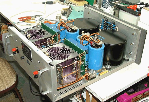

Nice sinks 😀stein2 said:This is just a smudged 35k image...![]()
Same sinks I used on KMA 100's
[IMGPo635.jpg]
Regards
David

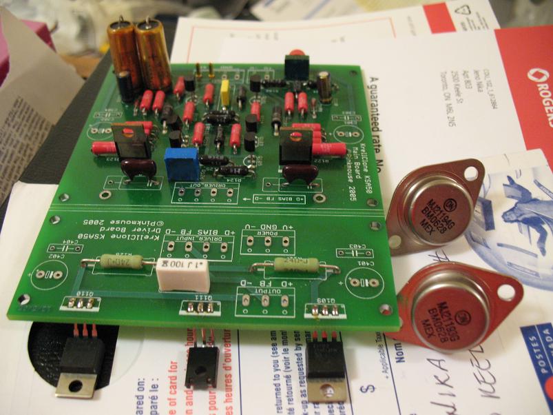

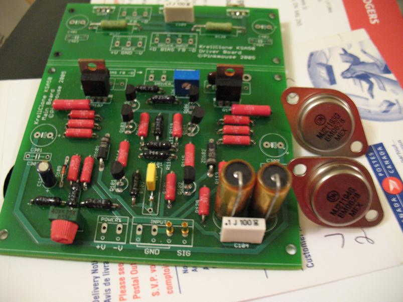

HI
Up for sale a pair Krell KSA-50 PC boards (from grop buy made by Pinkmouse2005)
The PC board stuffed all the resistors like Holco ,PRP some Kiwame . All transistors are closly matched ,soldered by WBT silver solder .
Also I include with the kit 6pair MJ21193 / MJ21194 TO3 metal case .
I use ERO Vishay , Panasonic FC tipe (10uF 50V),some silver mica and Wima capacitors
The bord vas carefully ansemled , never powered up .I change my mind I build in the amplifier case a Aleph4.
So I only I sell these because I need the money for my next project .
My heatsink is way to large 15" tall 45lb for the Krell so I desided to biuild in a Aleph 4 .
I ask for the pair kit $170 plus shipping plus pay pal fee . It cost me much more the exotic parts , matched transistors etc .
I try first on the forum after 2 weeks I will post it to the Ebay .
If you are interested please write to mathelaszlo2@yahoo.ca

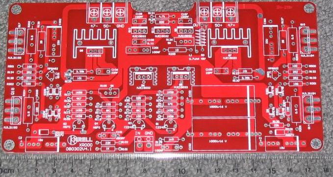

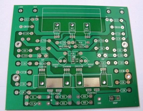

hi..i want to ask you something about the differences of these circuits..i want to make krell amp..my friend made krell ksa 100 with four output transistors and two mje15030-31..but there is cascaded mje 15030-31 transistors in ksa50 circuit..what are the sonic differences between them..thanks

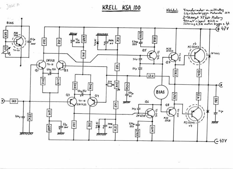

umut1001 said:and this is the circuit my friend made..he used 2pairs of mjl21193/94..i am asking the sonic differences..did anyone made both of them and listen to? thanks
Hi Umut,
in my honest opinion, few DIY Krells will sound the same as the DIY community has made modifications over the years, some for better and some for worse.
A Krell is not necessary the best sounding amplifier in any case, but if you are looking for the original sound then build the original amplifier.
The KSA 100 circuit you show will not give you the 100 watts at class A biasing with a single set of output devices as you will be over stressing them, unless forced cooling is used.

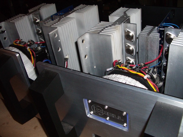

Have a look at the original KSA100 guts.
hi.i will try it semi class a or quarter class a mode.not fully biased class a 🙂 .i am asking the why delta audio circuit has three cascaded mje15030-31s..because its hard to match them..i bought 4 pieces of matched mje15030-31..i will use it with my westra speakers.theyre capable of 70watts rms 120watts nominal power..i dont know who draw the picture of krell ksa100..can it drive 4pairs of output transistors with only a pair of mje15030-31?
