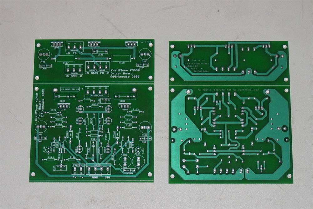

Pinkmouse KSA 50 Schematic
I just picked up a set of KSA50 Driver/main boards by the Mouse. Jeez man these are great quality!
They are dated 12/5/05. I'm poking around post #1700 there was still some tweaking and I was wondering where I could find the proper schematic and bill of materials to match these boards? I am currently using the wiki but it is very slow when I use it. Could someone point me or link me?
gaborlela, it was very nice to meet you and thank you! Cheers to the DIY as I just met a new audio enthusiast friend!
Shawn. 🙂

Use Jan's parts list which was generated for his pcb. Just drop all the current limit nonsense. His list is the closest to the original values of parts used by Krell.
Jan's site is www.deltaaudio.com
Mark
