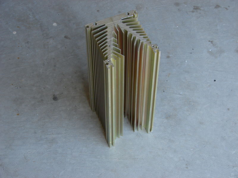

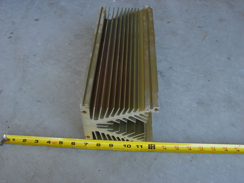

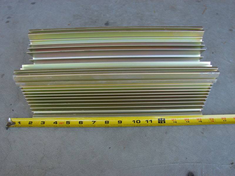

I am still attempting to acquire the mental strength to start the Aleph X up again and replace the burnt out parts.
Heat sinks?
I still have em, but have no time to find or ship... I look forward to moving back to La and being a welfare case where I get money and do nothing... 😀 THAT WAS A JOKE!! I just hope I can balance work and home in my next location.
Hi Troy,
are you planning a 13.5inch tall case?
or do you plan to saw the lady in half?
Two or three of those 6.2inch sinks running across the back of a monoblock will be impressive.
Good luck filling in the claims forms😀 😉
Why do you have to show them if you got no time to ship?Heat sinks?
Just to tease me/us?
always wondered
I've always wondered about the grooves/channels on the sides of those heatsinks.
Are there little I-beams available that will slide in there to hold a bunch of those next to each other? Are the sides different- meaning one side will mate into the other side of a 2nd piece?
