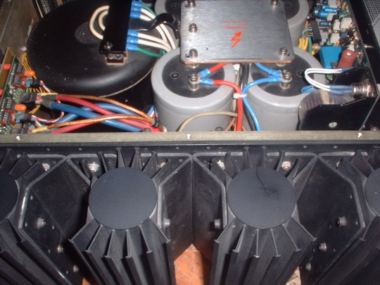

Nice. What's it based on?
zeonrider said:Look nice !, but look Clone of all clones !
