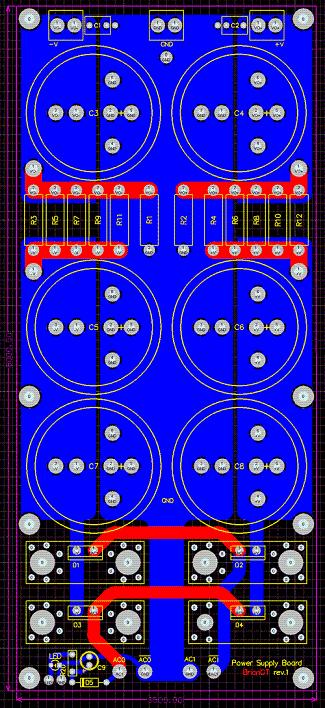

Before I hook up the big toroid to the briangt PSU boards, I just wanted to comfirm the wiring.
The 29V secondary wires (2x2) go 1 to +v and 1 to -v and the middle wire (0V) goes to the GND pad on each board
Correct?

as you said the +ve & -ve feeds go to the PCB.
The 0v common from the PSU goes to a Central Star Point that becomes your ground reference.
All other grounds and returns come back to this same point.
And use a light bulb in series with the mains supply to the PSU BEFORE you connect the amp.
Check your open circuit voltages and polarity.
Keep the light bulb in circuit and couple up the amp and switch on again.
Expect the bulb to glow gently due to some bias on the output transistors.
After you have checked your voltages again, remove the light bulb from the PSU supply and try again.
Now set up your bias in gradual steps and allow about 5 to 10 minutes between adjustments for the heatsink to warm up.

Alright, so I was looking at the wrong end of the PSU PCB (i thought that seemed a little too easy). There are 4 pads for hooking up power to the PSU board, AC0, AC0(with a line over it), AC1, and AC1 w/ line over it. I only have three wires (29V-0V-29V) and 4 pads... What do I plug in where?
Thanks,

is Brian's PSU a dual rectifier type?
If so, it needs two separate secondary windings i.e. 0, 29 + 0, 29.
You can separate the centre tap but you need to open up the insulation and split the secondary at the centre tap. Wire in an extra connection from the secondaries then bring out the pair of wires that were the common (0Vac). One becomes 29Vac and the other becomes 0Vac.
Just before you go measure the secondary winding voltages and if needed add an extra turn to match them up exactly.

Hi Andrew!
There are 2 rectifiers per rail. 4 total.
I guess running a jumper from where 0V is terminated to the other pad wouldn't work?
I'd rather modify the board or go point to point for the PSU than mess with the toroid. Its an epoxy filled monster.
So what, if anything, can I do to the board to make it work?

googler
Just solder the center tap wire in the AC0 (with line) or AC1 hole.
I don't see any difference whether the connection of the two secondary windings are made inside the trafo or on the board.

Thanks guys!
If I wire the outer wires of my secondaries to the two outer pads (AC0 without line, and AC1 w/line) and the center tap to either of the middle pads (AC0 w/ line or AC1 without line) will I need to flip the polarity of the caps on the right side of the board?
Thanks again
Brad
Thanks again
Brad

Yeah, but isn't the left side the -V side so you want the + cap at ground (center) and the right side is +V so you want the - cap at ground (center)??? Looks that way from post #5971.

Connect one outer lead (29V) from your transformer to AC0.
Connect the centertab lead to either AC0 (with stripe) or AC1.
Connect the second outer lead (29V) to AC1 (with stripe).
Place all the capacitors on the board as the silkscreen says and you will have a correct working symetrical power supply.
Regards

lgreen - there are only 4 diodes on the board
Gewa - I'll wire it the way you suggest.
