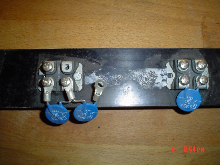

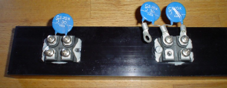

I use the setup as rectifiers for test PS's, these IXYS's do 200 amps, 600 amps peak, handle +500 watts each. ( NP stated he still makes a mess with thermal paste too)
Too much thermal past is just as bad as not using any at all. There is a correct amount for achieving best efficiency. Just like too much butter spread on a sandwich will give you a bad case of gas😱 .

This thread is great, but don't critize people and their thermal compound! Its just a messy test board (that happens to look a lot better than most of my finished products).
OK OK, its Jacco, nevermind. Don't see any pink standoffs in there, must have been his early work.

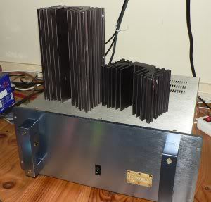

After reading a lot of this thread im thinking of building my own ksa-50 clone.im very curious if a well-built clone will outperform my ksa-50(mk1)
im planning on using two 400va +/- 22Vac transformers, reason is i already got one so i just need to buy one (yes im dutch😉 )
i like the idea of not using fancooling because i really hate that fan in my krell, poor s/n ratio when listening to low volumes.
I've got some massive heatsinks but will these be enough to take it to a reasonable (mkII) bias-level wihout using a fan ?
here's a picture of them (this is for 1 channel-i have 2 sets)
Also, do i need to limit inrush-current with these transformers ?

Being Dutch in this case isn't going to pay off😉 . Those trannys will leave you about 10 volts too low per rail but they would make a nice Aleph 30!. (22 X 1.35 = 29.7) volts DC. I generally use 1.35 as the multiplier to account for doide loss and so on. Some ise 1.4 as the multilplier but that generally doesn't hold true.
You need about a 56 vct 400VA transformer(29 X 1.35 = 39.15) per channel to make it to the +/- 37 volt give or take range on the stock KSA-50. This size tranny will work fine when biased for 50 watts class A.
Your KSA-50 shouldn't be all that noisy either.... is your fan ok? Perhaps going bad?
