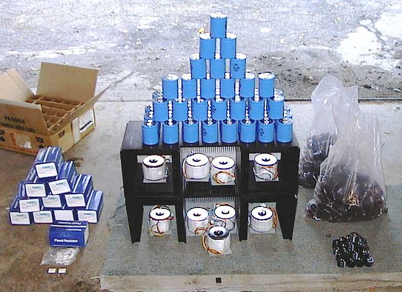

found it...
...as Troy correctly surmised, it was behind my most recent sculpture, a picture of which I have attached.
I call it "3.4 farads sitting on top of 16 heatsinks, weighed down with 500va toroids..."😀 😉
very original I think, though destined for a short life...
The little black square on the front edge of the carpet fragment is an mjl21194, just for scale...
The plastic bags to the right of the sculpture are full of icky little 4700u/50v caps, for when one of the 68000/50v is just too much...
The blue boxes to the left are panasonic 0.68ohm, 10w resistors.
Some people collect stamps, what can I say, I've been called insane, but at least my friends get nice hand me downs...

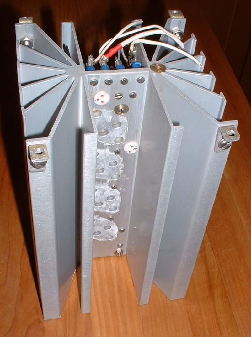

This is the radiator I'll use. I got 6 of these 5"X4.5", lenght 8''
From the Wakefield catalog I think that is 0.8 deg C/W.
I'll put two transistors per heatsink, 3 heatsinks per side.
From my quick calculation, with supply of about 38V (Transfo of 28Vac), PWR = (37V - 0.55V) * 1.1A biais = 34W.
So for 30C above ambiant of 20C (heatsink temp of 50C), the heatsink is 30C/34W = 0.88C/W, so a 0.8C/W should be Ok.

Thats a very similar sink to what I used on my overly biased Aleph 2's. On mine I used 6 per monoblock that are 6" tall. Very similar to what Krell did. They are among the most efficient sinks made. Wakefield is a pain in the you know what to deal with but they are also available from M&M Metals and they are very nice to deal with. Total cost on mine(unanodized) was just over 300 bucks U.S. with the shipping. Here is the link......
http://www.mmmetals.com/pages/mediu..._heat_sinks/high_power_extruded_heat_sink.htm

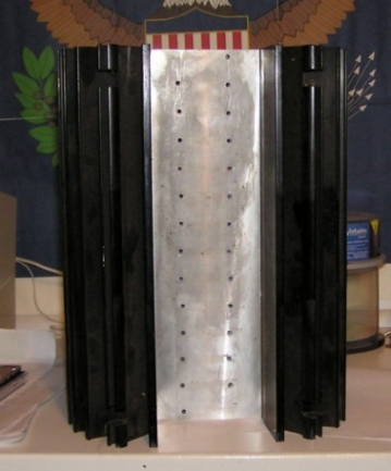

About radiators...
Hi All-
I spoke with Steve @ Apex.jr last night about another project I have going on and he said he just bought some heat sinks.
I am trying to get a picture of them so I can see if they would work for us too.
He has these on his site too, but I will wait to see the others.
http://www.apexjr.com/images/APEXJRTUNNELHEATSINK2.jpg
http://www.apexjr.com/images/APEXJRTUNNELHEATSINK1.jpg
