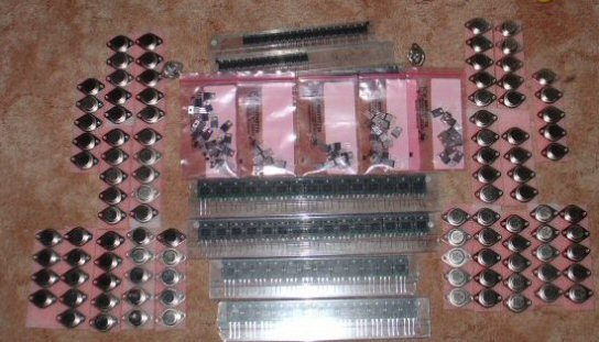

Some parts?
I've got wiring by the truckload here (well, a couple of 10m spools will be enough, and some high quality OFC rca cabling)
But i've had a few more transistors arrive today 😀 Let's just say there's a "pretty penny" worth of transistors here 😉 It's to go into 5 channels.... There's another 60 transistors (30 pairs) still on their way, it's to give us some choice for outputs, i'm going for TO-3 21193/94's i think 🙂 Cut a 94 and 04 (15004?) open and the 94 looks nicer... Maybe a SMALL (i mean microscopic) build difference, the plate the chip is soldered to is smoother with less imperfections 🙂
I'm looking for some copper bar stock (about 10ga thickness) for wiring it up, etc... Trying to organise heatsink looks right expensive (1m long piece by 250mm wide with 63mm deep fins) about AUS$150 !! But i'd need 2m for my amp (333Hx500W (that's 2 pieces side by side on 3 panels of the amp))... Should be good for ~250+w (at a low guesstimate, possibly more) per side... So here's my picture so far..... will get a wiring one up tomorrow 😉
Aaron
Aaron
