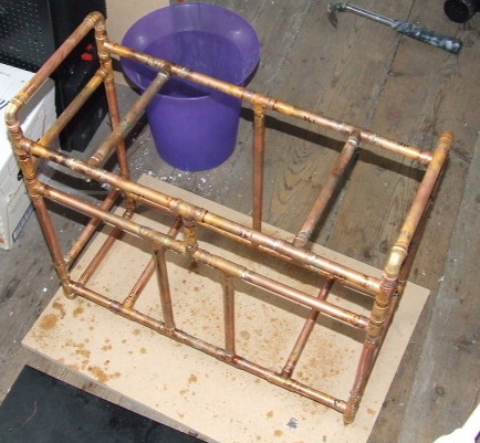

Roll cage complete. A bit of cleaning up to do, then I can start installing stuff.
