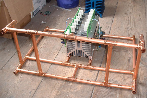

Pinkey... My Kitchen sink drain is clogged.......
So is that for water cooling or are you making a statement? Either way its alot of nice copper that you better coat with lacquer so it doesn't tuen black....
Mark
Mark

Mark A. Gulbrandsen said:P...are you making a statement?
A statement - just think exoskeleton... 😉
Either way its a lot of nice copper that you better coat with lacquer so it doesn't turn black....
Still pondering the final finish, I might go verdegris.
