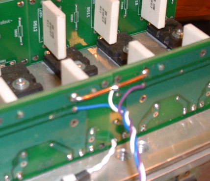

I've populated my boards (PinkMouse), assembled most of my hardware, and am ready to begin assembly and wiring the components. I have some very basic questions regarding the assembly. I'm using 'Dual-Mono' with separate transformers, rectifiers, and caps. Keep in mind, I am a structural engineer with limited background in electronics.....so some of this may seem very obvious.....but I want to be safe.
1. I haven't decided whether to use BrianGT power supplies, or separate rectifiers and smoothing caps. The caps I would use are three or four 22000uf 100v caps from K-Amps per transformer/rectifier. My transformers are 28v+28v at 500VA. Any suggestions regarding resistors across the rails for a CCCR, CRCC, or some similar configuration? Is something like 3kR at 5 watts appropriate? I'm also planning to place an LED and RLED across the rails on each channel's power supply.
2. I know there have been some discussions regarding powering the main board separate from the driver board for power saving, and for possible use of a regulated supply at the main board, but is it okay to simply wire them both directly to the output from the power supply....full voltage?
3. I do not see a direct connection to the output boards from the power supply? Is it correct that all of their power comes from the driver boards?
4. Which pads on the output boards are connected to the D+ (or D-) and FB outputs from the driver boards?
5. Which pads on the output boards provide output to the + and - speaker binding posts?
Thanks for any suggestions, Robert

4)D+ Goes to Drive+, and D- goes to Drive -, FB runs back from the positive output post of the speaker terminals, or from the point indicated below
5) For the speaker output from the boards, connect a thick wire between the thick top traces on the PCB opposite the devices between the two boards, then from the centre, take off the cable to the positive binding post. The negative post goes directly back to the star ground point.
The pic below shows the principle, but note that I have yet to attach the speaker output cable, the one you can see is the feedback.
