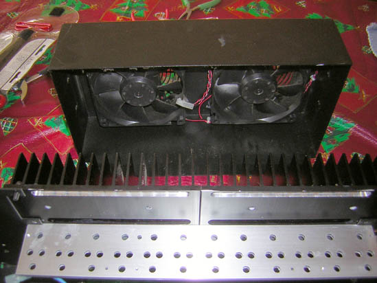

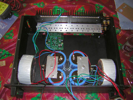

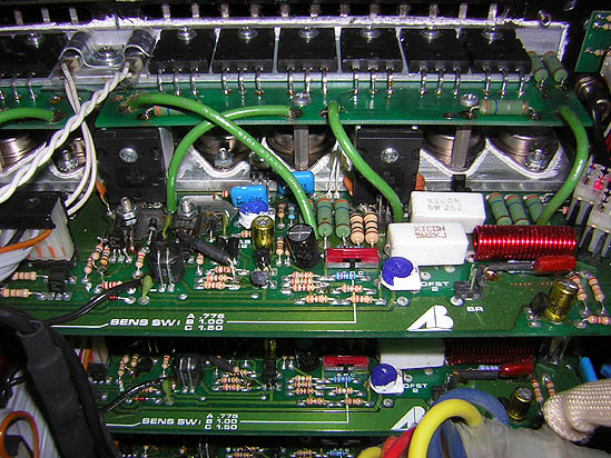

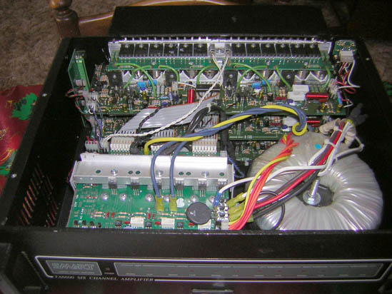

Having been so busy with work lately I decided to persue another method for a chassis for my KSA-50 and to finally get it "wrapped up". Yesterday I aquired a Smart 6 channel Cinema amp that has about the right size chassis. The sinks are a tad small however they are covered by a fan enclosure contianing two 4" DC fans. So I thought this ought to work just fine..... For those curious I didn't trash out any great or classic amplifier by any means. I'm not a Threshold chassis converter so to say! These amps have a long history of unreliability and a 6 in one channel amp just doesn't have a place in a cinema where if one channel goes it might take all 6 of them down and close that screen until the service man(yours truely) arrives. Well that is just what kept happenning to these wonderful amps which were built for Smart Drevices by AB systems. The amp itself is a rats nest of wires and a kludge in and of itself. It was a pleasure to lay this amp to rest! The next post contain some some photos of the before amp and of my planned layout for the KSA-50.... any input on the layout would be greatly appreciated!! BTW: I will be using the MJ21193/94 TO-3 devices salvaged from this amp for my KSA's final build. That will give me an extra 50 watts of disipation per device over using the MJL plastic pack devices, thats an extra 600 watts per channel of available disipation!

Looking good Mark, though I'm a little peeved that you might finish yours before I finish mine! 🙂
Are you going to repaint the chassis?
Mark A. Gulbrandsen said:My layout but if anyone wants to interject a better idea please speak up. I'm certainly open to ideas....
I think that's better too have physically separated heatsinks for left and right channels.
just thinking how difference in C/W value of L/2 and 1L isn't linear (L of heatsink ,off course)
edit-just looking at layout of that amp-no wonder that is unreliable
btw-that fan case reminds me on old Altec amps 😉
It has a black texture powder coat that looks ok. I am planning on making a new front panel though. Not trying to beat anyone here, just get My KSA-50 back in operation as I really need a second system here now....
Well, left and right channel do have seperate sinks but they are tied together using the alumnium angle that the TO-3's mount in. This also strengthens the sinks. I believe that with both fans doing about half speed it'll be livable... plus the TO-3's can take quite a bit more heat as well.

Those heatsinks will be scalding hot with 3 pairs per channel of TO-3's, I wish (for your sake) that they were bigger but hey nothing you can do about that. Make sure you put in some feet and drill a hole or 2 for your bias sense/compensation transistor as I did not see a spot for it on your mounting bracket.
It will be heavy on the front side, so front handles will be a plus.
I'm jealous!
