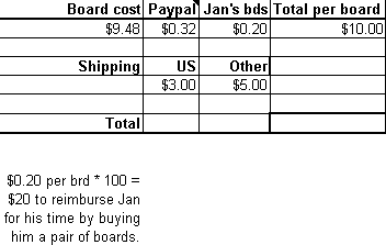

I have a paypal account which I just cleared and emptied for this GB.
I will be ordering the boards next Friday and you are welcome to pay ANY time before then.
stgrab@yahoo.com is the paypal account, and cash is always welcome. 😀 Email for address. Remember payment MUST be recieved before COB next Friday.

I'm getting ready to pay for my boards, but would like to pay shipping as well. What do you think, like $4.00 or less for boards shipped USPS in USA?

Just to clarify - shipping - are you SURE $5 is right? I'm ordering 8 boards, so i would like to know before paying, once i know this i can paypal you no problem
