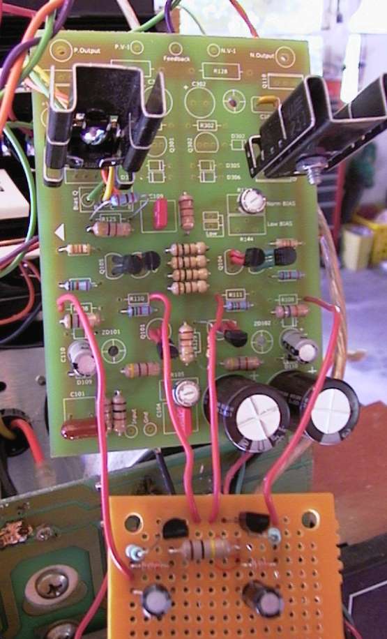

Here's my current front end solution, as you can see a wire to +ve, another wire to -ve and one each to the degeneration resistors for the long tailed pairs...
I ended up deleting 4 resistors from the main board, plus the 2 zeners, then added 3 resistors, 2 zeners, 2 caps and 2 transistors, on their own little board...
If I were going to respin the board I'd probably opt for the next level of complexity in what are a linked pair of ~3ma CCS...these are emitter follower CCS, adding one more transistor to each would improve it's technical performance, basically by DC feedback...
From a measured perspective the benefits are obvious, the amp's vital stats become totally stable across a very wide range of rails...PSU hum dropped by 10db, and the random noise floor seemed to drop by 3-5db, but this could easily have been an unintended layout change, it's a rat's nest right now...

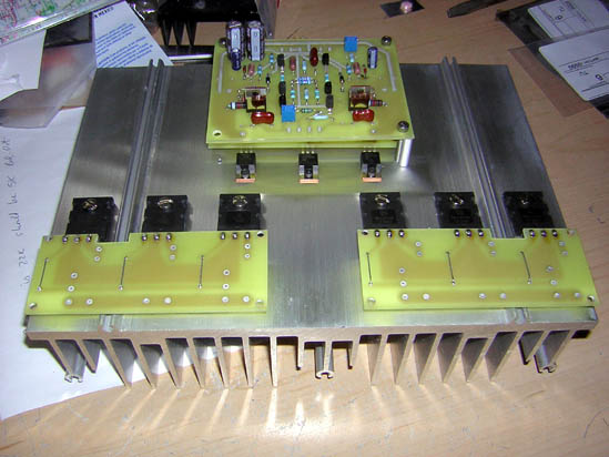

Here is a photo of the new boards all mounted up on the sink so far. I should have this up and running later tonight. Broke off one tap but that will dissolve when it goes in for anodizing.
One thing we may want to think about changing is the clearance between the screw mounting holes and the traces on the main board. Things get just a little too tight up by the pre-drivers. I'm not a fan at all of using nylon spacers and screws to mount boards but in this case I will have to in order to play it safe, I also generally use 6/32 hardware for doing this. The final position of the min board will be 1.250 inches above the driver board. This should give plenty of clearance Clarence.

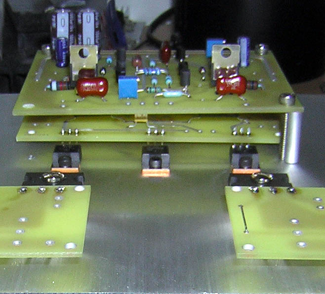

Closer shot showing driver board located underneath main board. This will allow me to drop the 4 wires directly down from the main to the driver board and then from the driver to the output boards. This is looking good for keeping wire length to a minimum. Some may choose not to break off their driver boards but to just jumper it over from the main board, making things even easier, but I didn't have the space on the sink to do this. All in all this will also make future repairs or mods alot easier to accomplish.
Mark A. Gulbrandsen said:Closer shot showing driver board located underneath main board. This will allow me to drop the 4 wires directly down from the main to the driver board and then from the driver to the output boards. This is looking good for keeping wire length to a minimum. Some may choose not to break off their driver boards but to just jumper it over from the main board, making things even easier, but I didn't have the space on the sink to do this. All in all this will also make future repairs or mods alot easier to accomplish.
Are the Drains on the driver FETs all common?

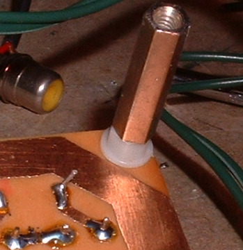

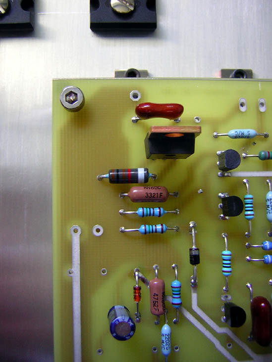

Showing the very slim clearance at the pre-driver corners between the foil and the mounting holes. What da ya think on this Al? Seems just a tad close for me with this kinda current available from the supply. I didn't feel safee placing my metal standoffs over the screws si the screws are just clamping the standoffs down for the moment till I get some nylon ones......

No FET's in this amp,. just bi-polor devices. There isn't really anyting common on these drivers anyway. I don't have the insulators installed on any of the devices yet...... have to go down to the dungeon and find em.

Mark A. Gulbrandsen said:Showing the very slim clearance at the pre-driver corners between the foil and the mounting holes.
Can you post a pic of the other side? I'm thinking of both the solder resist and plastic standoffs.

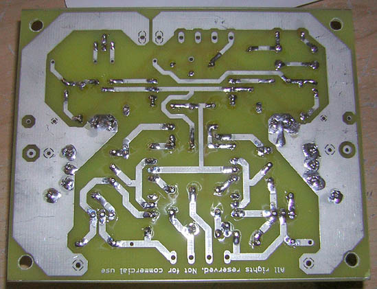

Al, Here is a photo of the back side of the board. I have drilled the 4/40 holes for 6/32 clearance which is the next size up. There is not really even enough clearance for the 4/40 hardware with metal standoffs. I hate nylon, especially in hot running amplifiers. I doubt that nylon would even make a commercial rating were it used for this purpose in any amp.

I would appreciate more clearance in every corner of the board.
The top holes have too little in my taste as well.
NO nylon spacers or studs please !

Well, These boards are great but there is one problem that has got to be fixed even if it does mean more $$ charges from Advanced and that is that the hole size for both the driver and rail supplies to feed the boards is juat way too small. I can't even use my favorite 16 GA Teflon convered silver wire on these boards unless I tack them on the back... not a good thing indeed. Also normally I use 12 ga Teflon wire for the rails on the output devices and the output of the amp itself. These holes are way too small
. But would be fine if one were using larger gauge ribbon cable.... and thats not what most here use.
The holes on Jan's boards were just right and we ought to move those over to this board as well.

Mark, what are those wire sizes in metric, (or even mil)? It should be just a case of changing the drill file to sort the problem.
