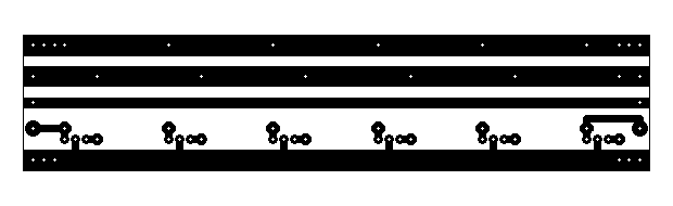

Hi All-
I'm not a draftsman so I won't begin to try and draw the output boards.
But if we can make them the same length as the main board I can probably have them made with the main board as a "snap apart" piece for the same or very slightly more.
I will get price estimates this week on 25, 50 and 100 boards.
