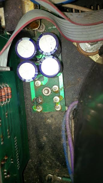

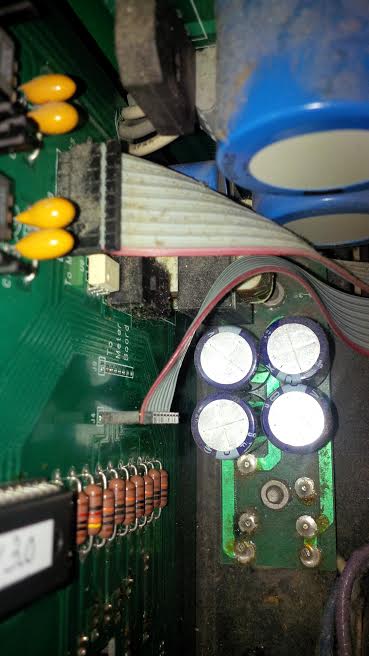

Good day,
When turning on my Krell KSA 300s, we heard the sound and saw the light of arcing, and the amp turned off together with the shut down of house's main power supply circuit breaker.
I disconnected the power cord to the amp and saw the circuit connecting to the power transformer broke. Please see the images attached, one in normal operation state and one in broken state.
Could you give me advice to check and repair my amp? Thank you.
