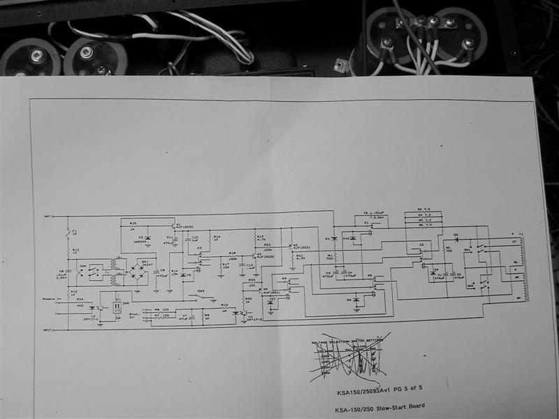

Looking at a KSA150 / 250 schematic, I see that they use K2 as the slow start relay, this shorts out those resistors you mentioned. There are a number of other switches and relays in the current path. The switches determine 115 - 230 V operation. K1 looks like the main AC contactor. F1 is 1A on this diagram and supplies the standby power for the protection and soft start circuits. Q1 is the regulator for this circuit, look for +11.4 ish volts on the emitter of Q1 or anode C11 / C12 or one side of R16.
Hope that helps. This schematic is on paper, so if you want it, I can email it to you. It's too big to attach.

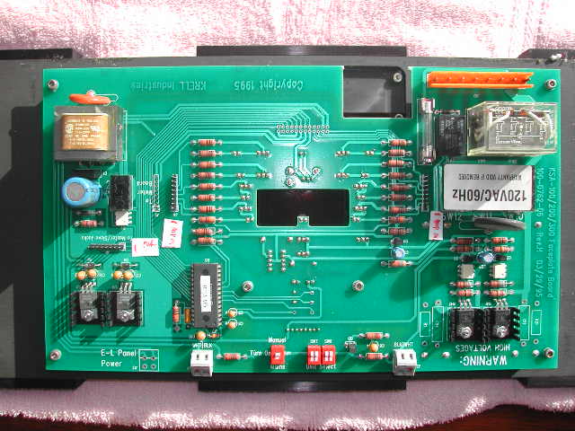

Over the weekend, I did some troubleshooting and I was able to fix the problem. I would like to share this information with the members of this forum.
Troubleshooting sequence:
- From the attached “slow-start-board” picture, I did some troubleshooting. This is the board that is located behind the front face plate.
- I checked the diodes, resistors, capacitors and the transistors. They all checked fine.
- I also checked the rectifier board (picture not attached) that contains the 2 big rectifiers and the 4 small capacitors. They checked fine too.
- Then I go back and re-check the “slow start board” again.
- This time I did some visual inspection and I noticed that there are 2 cold solders on the 8 pins male connector - labeled as “J10” on the board (the 2 pins that has the black and white wires going to the rectifier board). "J10" is located on the upper right hand corner of the attached picture.
- This explains the “sizzling” sound at turn on, since there is a huge in-rush current during the turn on sequence.
- Sure enough, after I re-soldered the 2 pins and put everything back, the amp is fully functional again. I do not hear any more sizzling sound during the turn on sequence.
- I have also tested the amp by playing loud music for about 6 hours continuous and it did not shut down.
I believe the reason the 2 pins of the connector “J10” is developing a cold solder is due to the following:
- The black and white wire coming from the rectifier board is a hair too short.
- Over a period of many years, because of the constant wire pulling tension on the 2 most outer pins of the “J10” connector, it tends to “pull” the pins away from the solder joint once the amp is heated up and consequently caused the cold solder.
