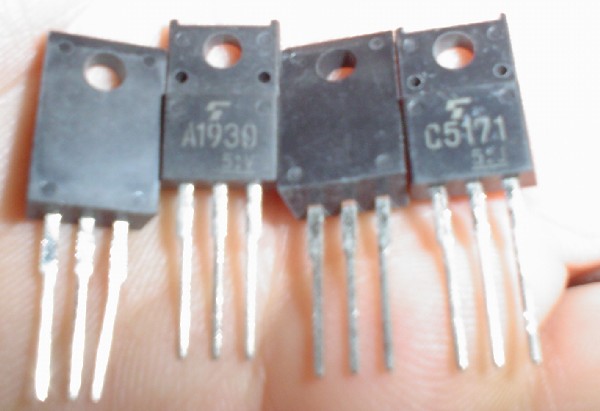

If you are interested Mark, I can ship 4 pair of the Toshiba 2SA1837/2SC4793 if you would like to test them against yours. PM me your address if need be.
Jakko, I had an information that said those 2SA1837/2SC4793 was a direct replacement for the older 2SA938/2SC2238? Correct me if Im wrong please.jacco vermeulen said:

Flodstroem said:2SA1837/2SC4793 was a direct replacement for the older 2SA938/2SC2238?
In terms of Vce, hFe and safe operation area(max current), Yes.
Other parameters, No.
In one case the replacements are an improvement, in other cases they are not.
Just as there may be a type from a different manufacturer which is better than originals or same brand replacements.
