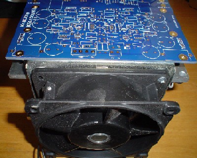

OUTPUT1 & OUTPUT2
the KSA100 mk2 power schematic shows the connections between the main board and the output board and the Zobel on the output including the two outputs (1&2).
The main and output schematics show the two connections "OUTPUT 1 + OUTPUT 2"
The main board PCB that we have has the two output connections in place at the corners.
Why is the 100mk2 wired this way?
What is gained by having the parallel links between the main and output PCBs?
Why two connections?
Why is the global feedback taken from the drivers rather than from the output?
How do we wire up the output stage to best use this arrangement of dual feedback?

OK, here are the answers as I gathered from rewiring an original Mk2:
The NPN and PNP boards were separated quite far from each other at the sides of the heat tunnel sinks. The way the Mk2 is wired is to keep the wires short to each section, as the board is about as wide as the tunnel. As you'll see the board's output connectors are 4 on top of each other at each side, so that the four wires leading to each output board can be tucked neatly together.
The global feedback cannot be taken from the outputs due to the mentioned separation. There's no real difference.
Unless you're using the same tunnels, the best way IMO is NOT as Krell has used do to symmetry issues. The board is laid out for separated NPN and PNP sections, so keep it that way.
I'd say use 1" standoffs for the boards and mount the devices (NPN left and PNP right) as close as possible or even perhaps partially underneath the boards. Make sure all 4 transistors have the same wire lengths.
For the speaker output Krell just took a random point, NPN on one channel and PNP at the other. This is IMO a very bad idea since the current from one rail now has to travel all the way to the board and from there to the other. Rather take a wire from each section to the speaker output or a similar innovative arrangement that is more symmetrical and would prevent the output stage current from returning to and through the board.

Hi P,
thanks for those clarifcations.
or
if only at the main PCB, that big trace from output 1 to output 2 on our Klone PCB would carry all the upper to lower current, but that prompts the question, where is the connection to the output relay?
If the Zobel is ONLY at the speaker terminals, does that mean the KSA100mk2 did not have the Zobel connected when the output relay was open?

you mean not the same as the output schematic?The NPN and PNP boards were separated
Are the emitter resistors of the upper NPN outputs connected to the Re of the lower PNP outputs? either at the heatsink or at the output relay?Krell just took a random point, NPN on one channel and PNP at the other
or
why? What tolerance?Make sure all 4 transistors have the same wire lengths
which board? the main or output or relay?prevent the output stage current from returning to and through the board
The original used 4 output boards/channel. Each housed two transistors and their emitter resistors, and the boards were mounted on the four corner flanges of the heat tunnel; NPN's left and PNP's right.
The two boards on the same sides' emitter resistors and DC rails were connected to each other via a thick wire, and from there to the corresponding pads on the board along with the two base wires.
All of this is preceding the output relay board which is completely separate. What Krell did is to tap the speaker out (leading to the relay board and subsequently speaker conn & zobel) directly from one of the four boards' emitter resistor joint. That is, the other rail's rear transistors had to push current via the fronts, then the board, and then the fronts of the other rail before it reached the wire leading to the relay. Two wires would have been better to keep this distance shorter and more symmetrical and to prevent the current passing through the mainboard, but the rear transistors still has a longer path than the fronts. This is why a fully symmetrical mounting is preferred.

I am certain I'll be using fans on the 100 and I'm pretty sure it will have to be a set of monoblocks.
