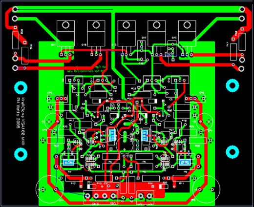

Okay, I've adapted the LTP pairs to be back-to-back, shifted the base pin for the few European types that have triangular pinouts, and added a fourth pin for 2SA/2SC types. Hope everybody is happy now. I had to use 0.5mm traces for a small portion but it will not be a problem.
I've also added the extra hole for triangular trimpots, thickened a few traces and holes, changed the footprints for the drivers to the flat-mounted TO220 package and added a jumper for shorting out the DC blocking feedback caps.
What I could NOT do was the diodes or bigger sized feedback electrolytics. Sorry. With a little ingenuity these can be soldered on the back for those who'd want to use them; I don't think they'd be popular enough to warrant serious adaptions to accommodate them. The driver part and all above it is still only preliminary, I'll make it prettier and more efficient and symmetrical later on. I'm also still pondering about where additional copper pours may be beneficial.
I'll try to see if I can adapt the board with the AAVID heatsinks for the predrivers.
There's only one big problem left: as it is now there is very little room left for the driver heatsink. Compared to the original, there's about 8mm less size for the driver heatsink, not a big difference, but the original already got way too hot. To fit flush with the top of the board, the maximum heatsink size is 25 x 120mm. The board and heatsink cannot be made longer as the clearance to the chassis lid is already very small. Wider will get in the way of the outgoing wire pads. Any increase can therefore only be in the z-axis, but cannot be too much or setting the bias will become difficult. The mounting holes can be shifted lower to make the whole thing lower and thus allow a taller board, but it all depends on the clearance to the chassis bottom.
Right now I cannot do much more until I have the details on what to do with this, how the predrivers should be sinked and what the exact board dimensions and location of terminals and mounting holes are.
Attached is a PDF with the the top and bottom side. I'll add the silkscreen layer etc. when the board is closer to being complete. Some of the stuff that appears to be overlapping would be the components that I made provision for different types i.e. only one will be used such as the MOSFET's. The silkscreen is also covered by the top layer in areas, but of course that will not be the case with the actual board.

Mark A. Gulbrandsen said:...I am going to hijack the old KSA-50 1st board group buy WIKI and turn it into the KSA-100 board WIKI...
Good idea!
PWatts said:Attached is a PDF with three different parts: the top side, bottom side and top silkscreen.
I think you linked to the wrong file! 🙂
Ok, Its here

A Question on the driver heatsink...
Do we all agree on #3 or #2. I asked for a quote on #3 because of its larger contact area.
PWatts.. What is the space between the C/L of the driver transistor mounting holes and the top edge of the board? I need to be sure this sink or #2 will work. I'm not worried about radiating area. Krell only had 3 fins on theirs and it was also quite thin. I think with either we will be in better shape thermally speaking. I just need to be sure that one or the other's mounting foot is going to fit between the top of the board and extend down to allow sufficient contact of the driver deices tabs. What color do you all want these sinks anodized? We have a local place thats reasonable and does very good work. Do we want to stick with the orignal blue color?

OK, people need to realize the following: I cannot go further until I have someone providing me the exact board dimensions and relative positions of the mounting holes and wire pads. The current board is merely an extrapolation I did from pictures I had and literally measuring on my monitor with a ruler and using reference sizes in order to find the scale. Not terribly accurate but within a cm or so. That is unacceptable, so I'm halted for the time being. I have a Mk2 coming in for service in the near future but I'm not certain about the details.
So, anybody have access Mk1 or Mk2 PCB?
Mark, if I assume the current board dimensions to be correct, there is about 14mm between the top of the board and the driver transistor mounting holes' centre (I assume that's what C/L stands for). Of course the heatsink extends down to about midway of the package, so the total length would of the sink would be around 22mm. When I have the correct dimensions I can give more accurate figures; these can easily be up to 30% off.
Is everybody OK about the predrivers? I tried the AAVID heatsinks Floedstroem suggested, but that would really screw up everything and seriously hamper the efficiency of the layout. According to my simulations the sinks can be fairly small, about 2W in total for all four. However, before people send the KKK to burn down my house if they do indeed get to hot, I suggest somebody build a prototype on a cheap dual-side board before having the group buy done. I would have volunteered but I just do not have the time.
If the predrivers are acceptable and I have the final board spacing sorted out, the design would be pretty much finished. I have to remention that somebody should PLEASE double-check both the diagram, routing, components, pad/hole sizes etc.

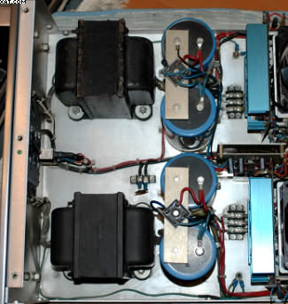

Power supply?
Hi
Is there anybody out there having a reference/Link to the DATE for the main transformer (for the KSA 100mkII)?
I need data specifications (winding-voltage + VA) or a model number (for the transformer, not the amp). I can have the Avel Lindberg to wind exactly the same original transformer and I would like to investigate pricing (price breakes etc...) for a small production run for a GB.

Flodstroem said:have Avel Lindberg wind exactly the same original transformer
Hate to dissapoint you, i believe the MKII had 700VA toroids.
Of course, the 3d stage KSA, the fan-less KSA100EUR overhere, had Holden& Fisher transformers.
Those have/had nice smooth rounded edges, still no idea what kind of core was used by H&F. I'm certainly not going to unwind one to find out.
How's about a nice MK-I transformer ? 😀 =>
(excuse me for cutting those bad French fans off the pic. Speaking of fans, any idea how much capacitor life/cash is saved by using a fan instead of passive cooling ?)
