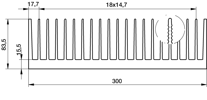

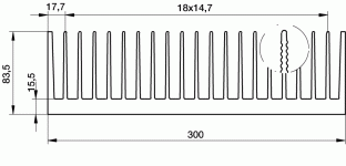

A high power Class-A amp that relies on natural convection air cooling needs 2.5"-3" deep fins, separated by 0.1"-0.2", lifted about 1"-2" off the floor to create a thermal pump to flow enough air mass to transfer and conduct the heat.
I would ask all builders to re-consider the single PCB design using natural convection air heatsinks like the KL-271 profile. One team engineered complete reference design would give high novice success and still allow experts to make modifications. It sounds like very few builders plan to use this PCB to replace old Krell PCBs, as these should be repairable.

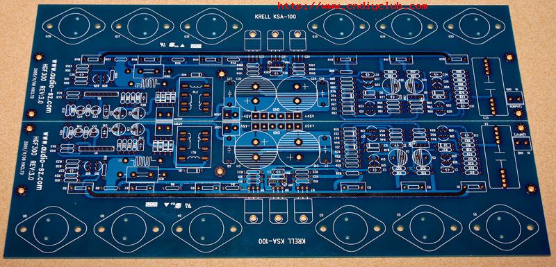

Attached image of "a" China KSA 100 PCB.
I owned both KSA100 and KMA 100, and the KMA100 was significantly superior, stronger bass, sweeter high frequency ...not sure why ...could be regulated power supply for front end driver stages ....which would also fit on single large PCB. Anyone else own both and can comment?
