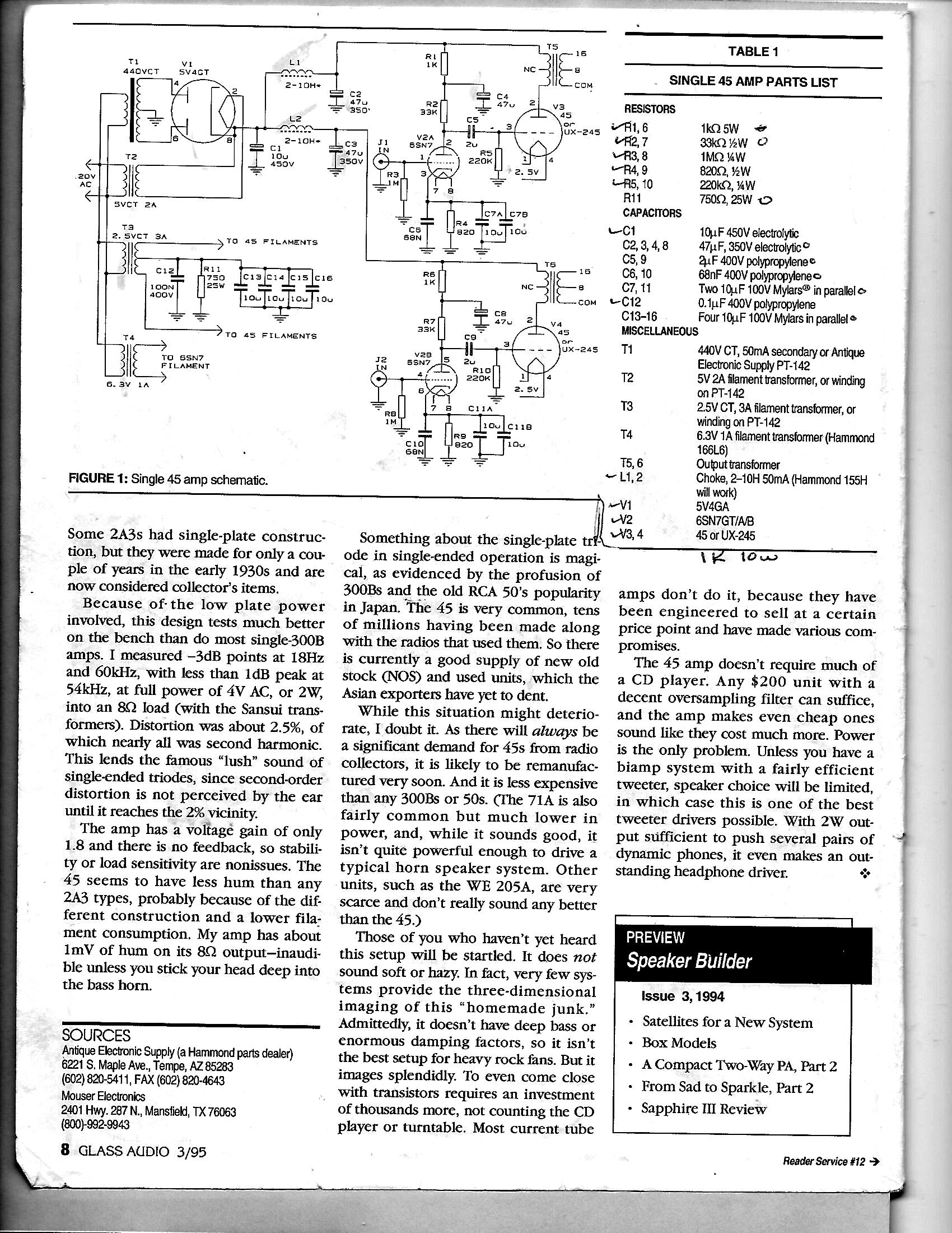

Was the Jeff Korneff 45 Amp schematic ever published online? Can anyone provide a link? As I understand it was based on the "Single Ended Glory" published in Glass Audio in the 1990's.
I want to try a 45 SET amp in my main listening room. They will drive my 104 dB horn speakers. I'd prefer to avoid kits, and rather source the parts myself, so I'm just looking for the schematic. I'm open to alternate suggestions, so please let me know if you think there's a 45-based circuit that out-performs the Korneff.

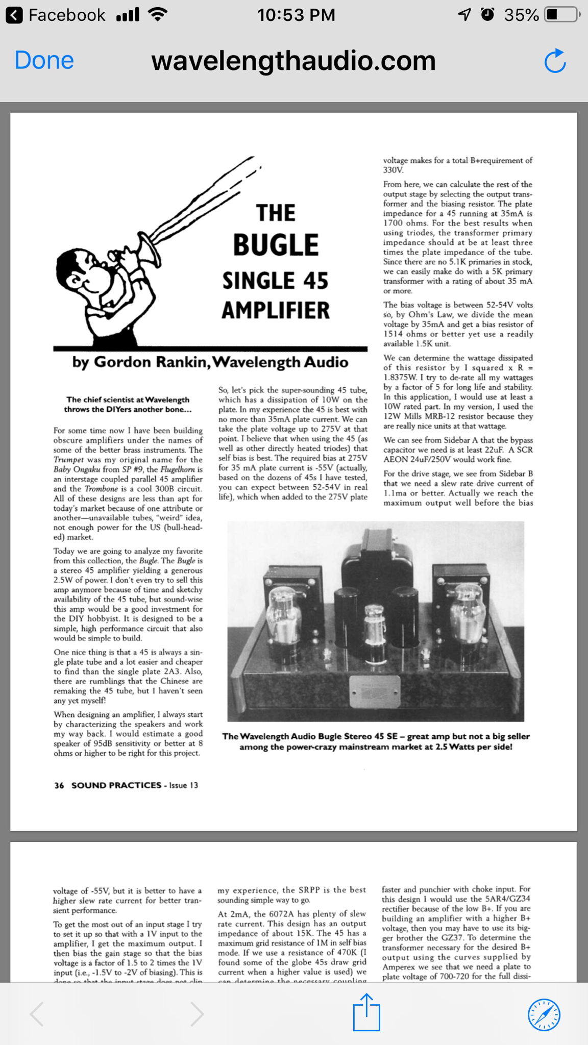

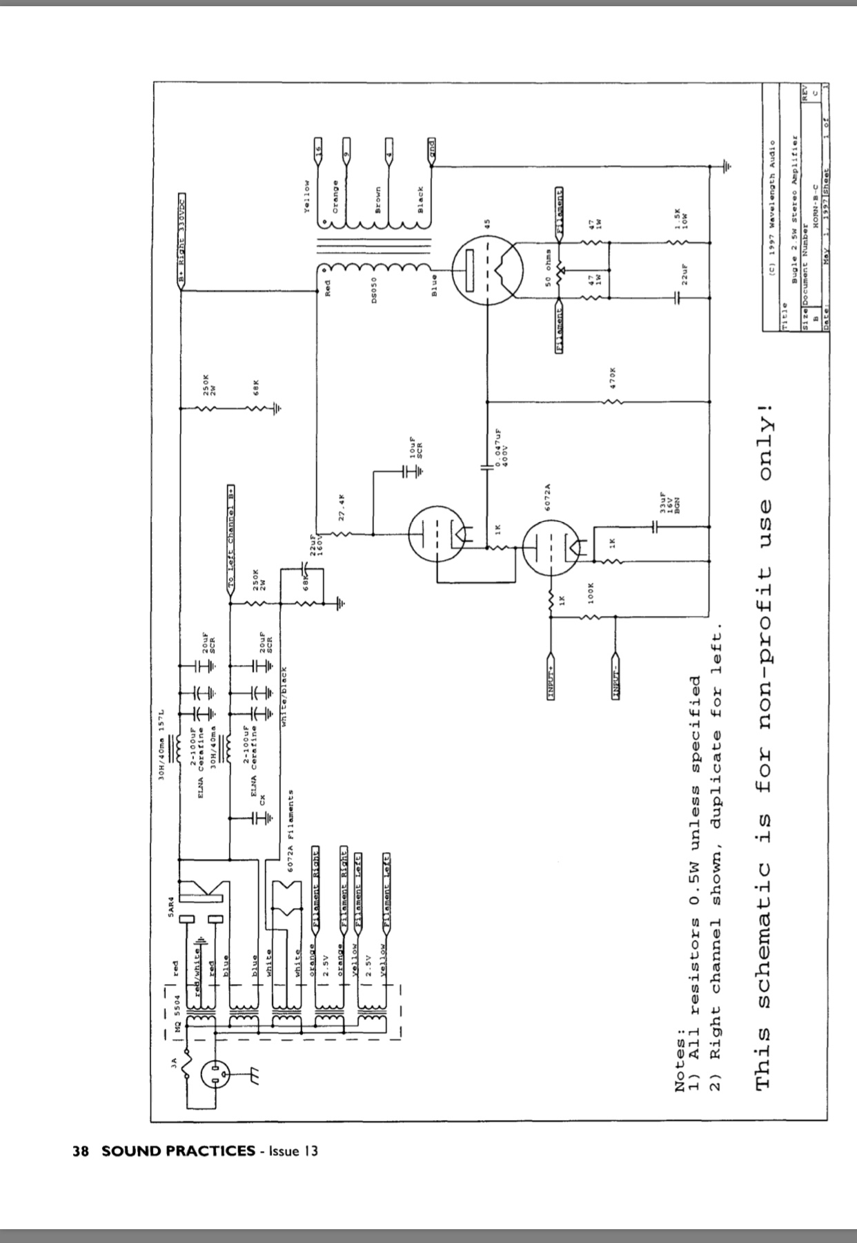

Check this - http://www.wavelengthaudio.com/bugle.pdf

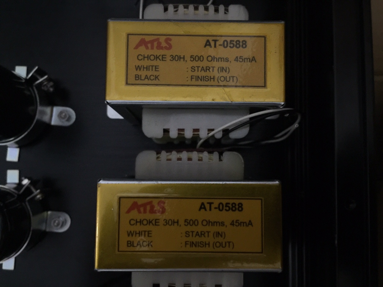

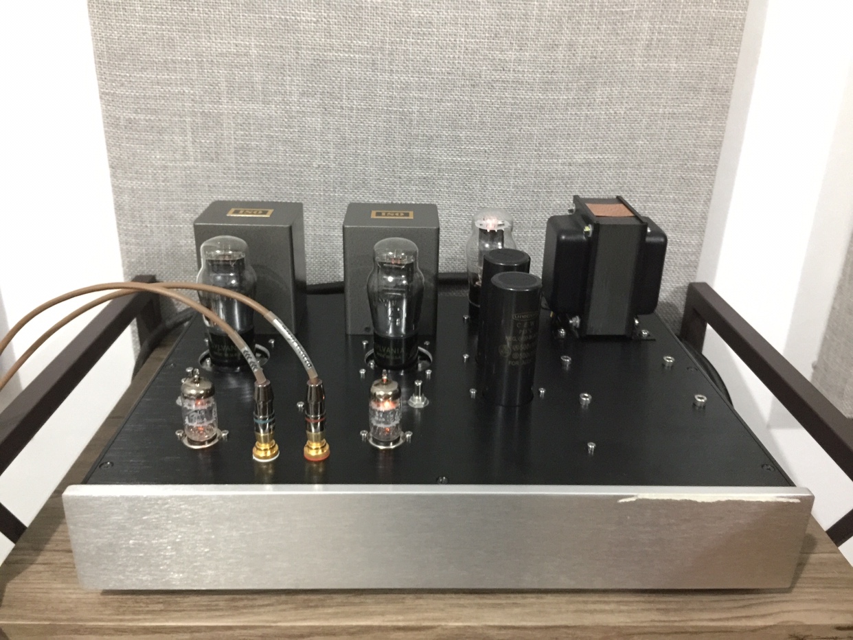

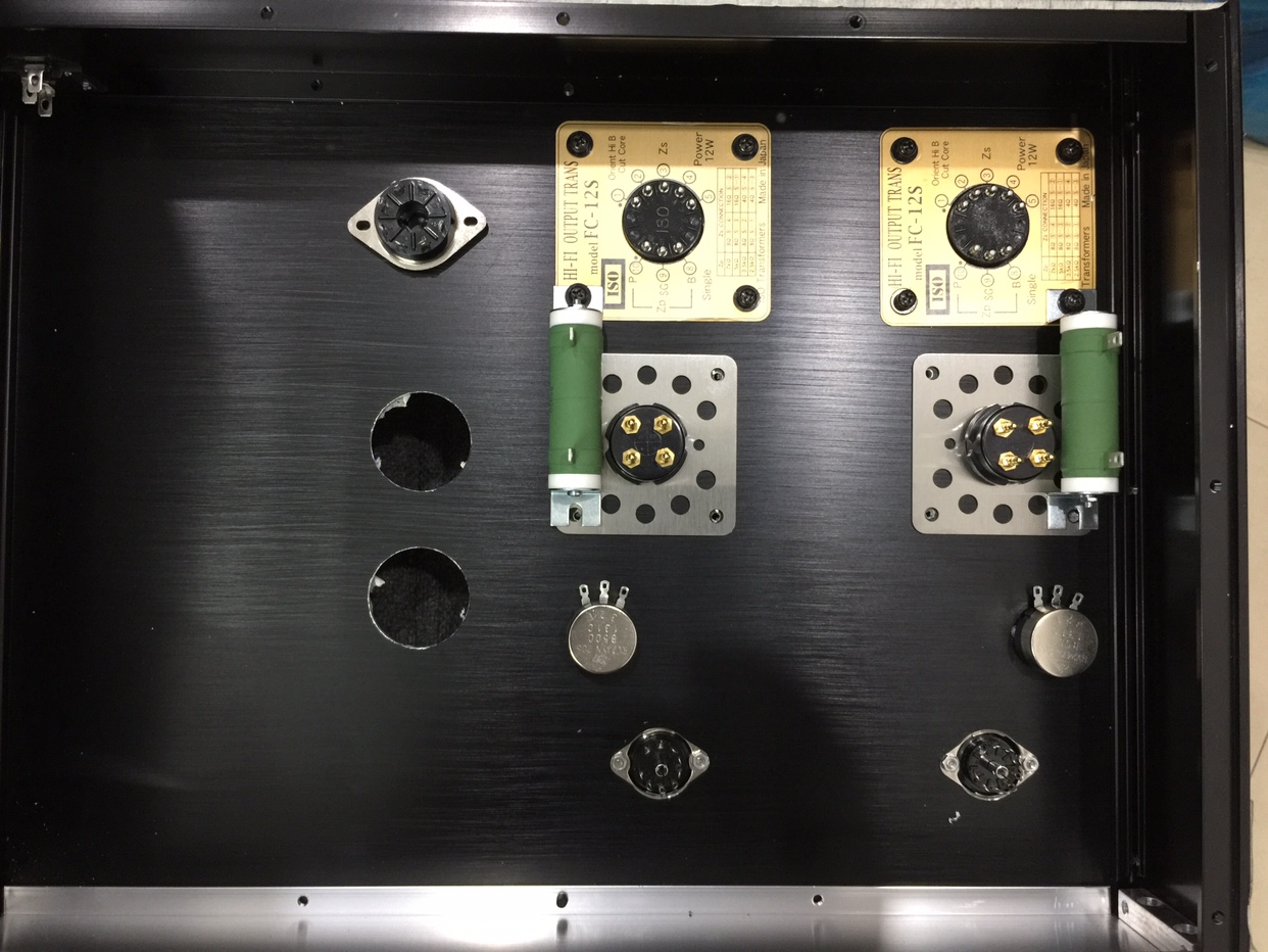

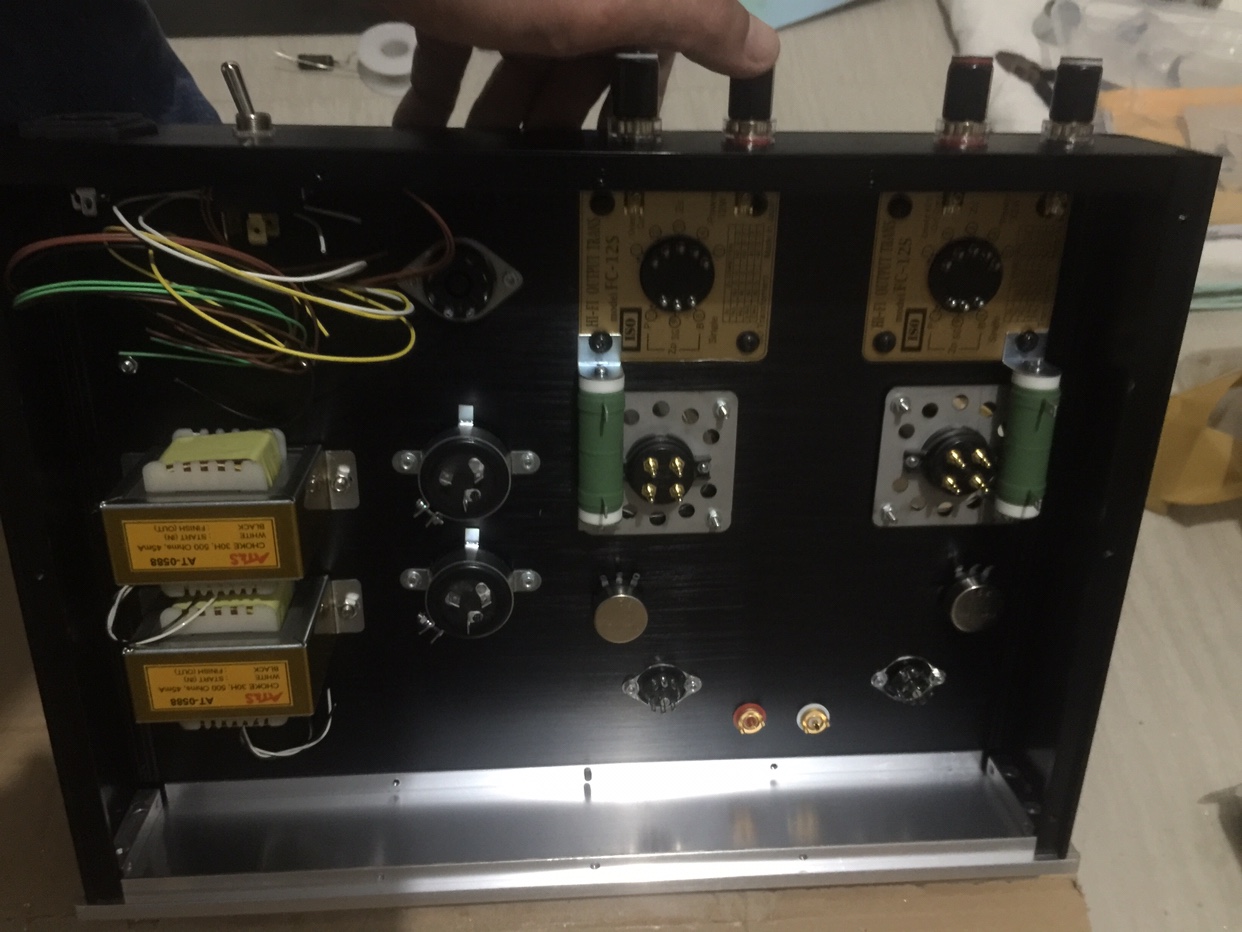

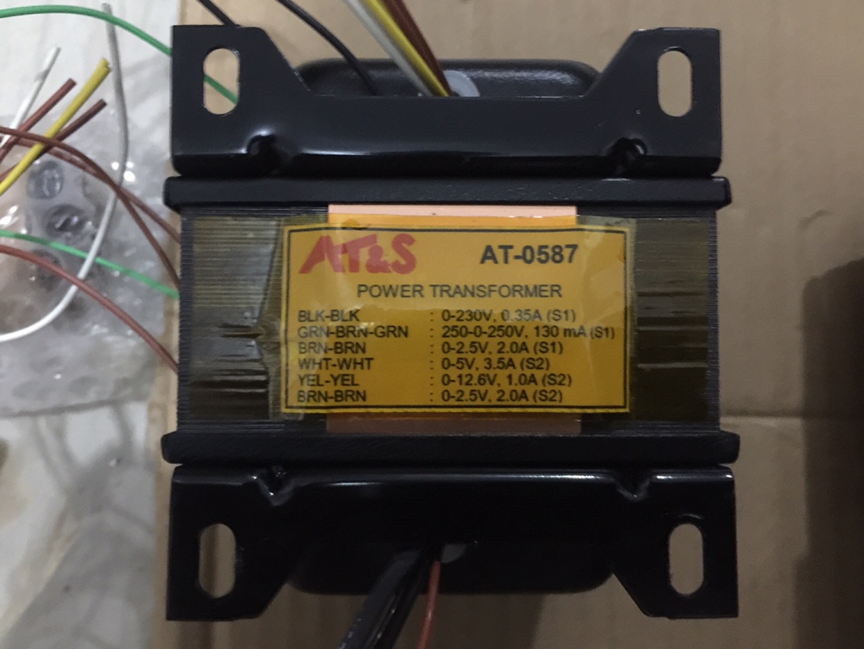

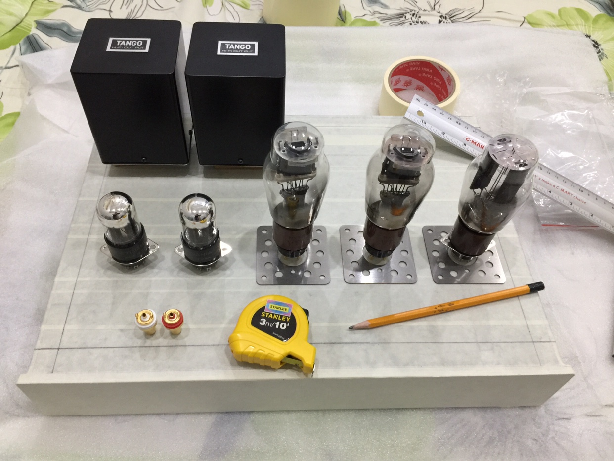

I just finish that project using ISO (Tango) FC12s OPT and custom wound Power Transformer & Choke.

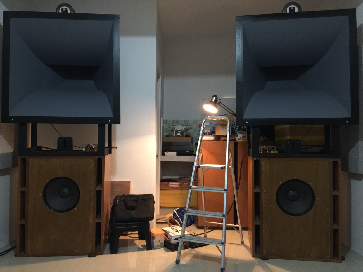

Driving this speaker

Attached is's Jeff's "Old Glory" schematic that he sent me back when I was looking to get into 45's.

Those are Onken 360L with Altec 416 8B, Sato Horn with JBL 2482 and JBL 2405 for HF - Passive Crossover - 2nd Order Butterworth - 300hz ~ 7khz

Craigtone, thanks for that! That's a much better resolution file than I've been able to find. Did you ever build it? If so, what about the TSE do you prefer over the "Glory" when paired with your K-Horns?
I never built it. The TSE makes sense on many levels so I don't think Glory would be able to top it. The TSE basically drives the 45 with very high impedance which no typical driver tube can do without trade-offs. THis is why some of the best sounding DHT SE amps use interstage transformers. The caveat there is you spend as much on that transformer as the rest of the amp BOM and if you don't ... well then you might have well just cap coupled it. 🙂
View attachment 737605View attachment 737606View attachment 737607View attachment 737608View attachment 737610
Norelco,
That is a beautiful build. Great Job... and the horns are impressive.

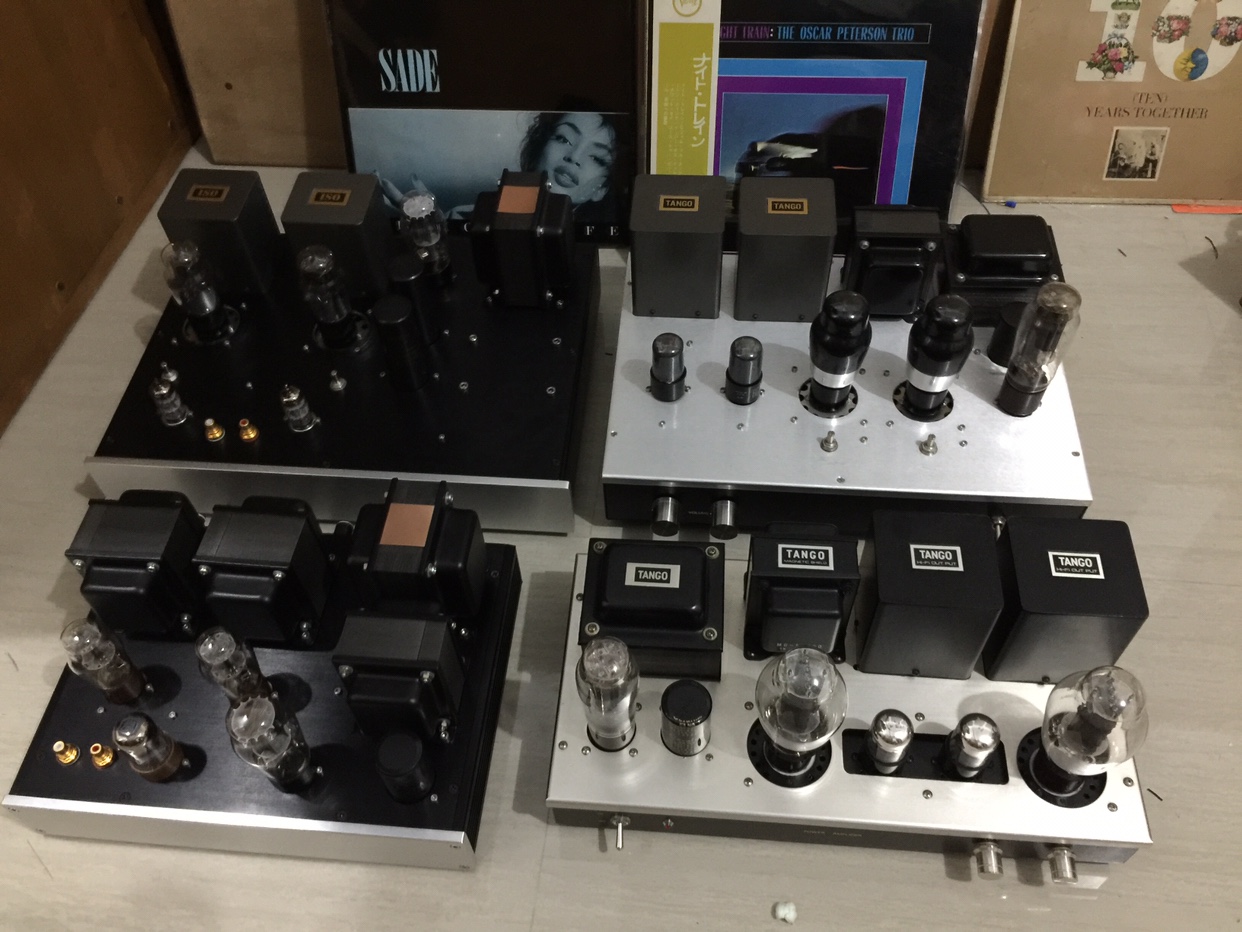

I have built the korneff 45 which is based on the single ended glory circuit and the bugle 45.
Both amplifier sounds nice but the bugle is more dynamic. The korneff will benefit more with a preamp.
Good to hear it from you Sir.. [emoji4] my SET addiction starts when i have that horn speaker set up..
Upper Left to Right
12Y7/ 45, 6sl7/ 2a3
Lower Left to Right
6sl7/1626, 6sn7/300B
Current project
6SN7/VT25 (based on Sun Audio VT25), OPT - Tango Hirata FW20 14S (14K Primary)
Upper Left to Right
12Y7/ 45, 6sl7/ 2a3
Lower Left to Right
Current project

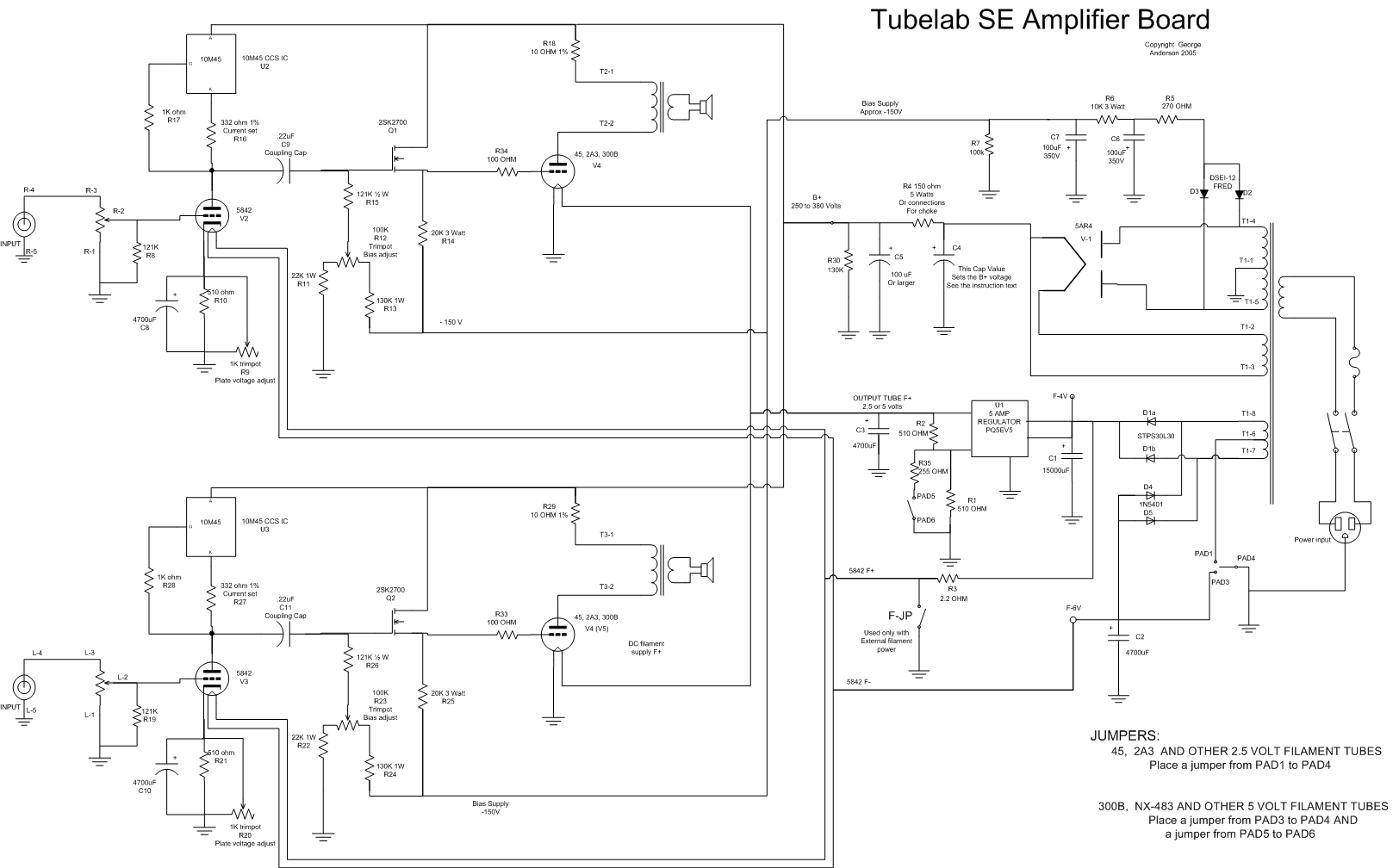

Would it be threadjacking if I asked questions about the TSE 45 schematic in post 4?
Technically the TSE drives the 45 grid with a low impedance source. It can provide grid current to avoid clipping or blocking distortion if the amp is driven near clipping.

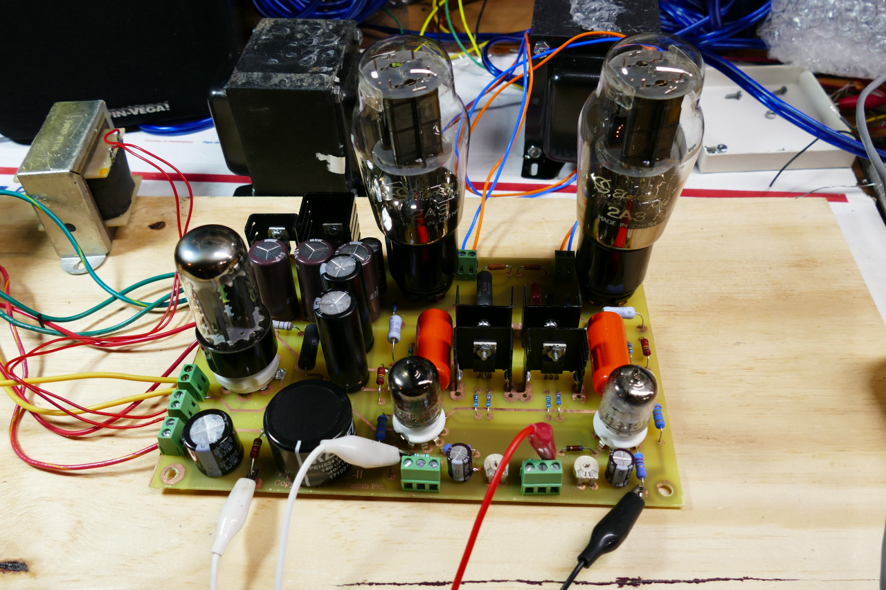

That's not a TSE, it is the Bugle which was fairly popular in the days before the TSE existed.

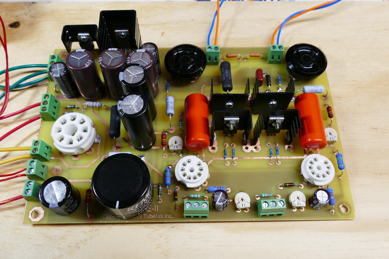

The TSE is here:
http://www.tubelab.com/images/AssemblyManualTubelabSE/TSE_board.jpg
Tubelab SE | Tubelab
The TSE is a great build but wait for the new version that is due out soon as the existing heater regulator is unobtanium.
There is a new version coming. It uses a different filament regulator chip, the board has been stretched to better accommodate big tubes like 300B's and fat "2A3's" and uncrowd the area around the heat sinks. Various small changes that have been requested by builders over the last 14 years have been incorporated. The first prototype of the new design is being thoroughly tested now, and I would guess that the first batch of new production boards will be ready in 4 to 6 weeks.
Here is a picture of the prototype and the build thread. The proto is just that, a DIY proto board for verification before I drop a kilobuck on boards from a quality PC board vendor in the USA. The proto does have some quality issues. I made it in my basement, and hand drilled the holes with a Dremel tool. The version offered for sale will be a professionally built board like the SSE and SPP.
