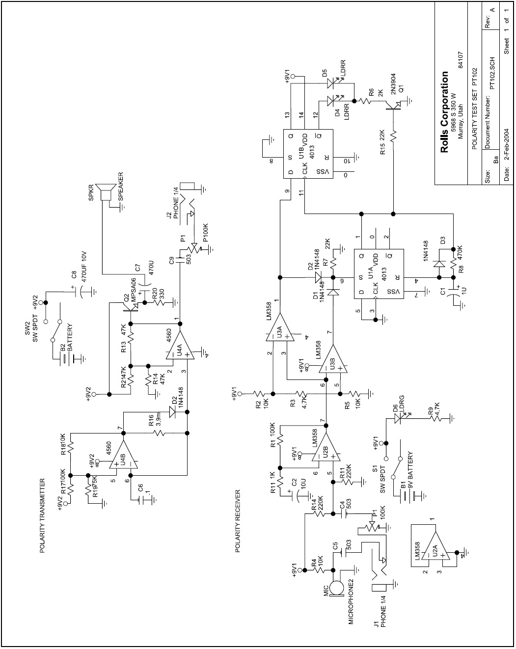

sir, can you share me the diagram for speaker phase checker? thanks
I am not recommending that you use this...it may damage your drivers.
but...here you go anyway...enjoy!

sir jojo,
what are the "other" options for this phase checker that will not damage our speakers. I already saw one phase checker gadget. It has two part parts, a sound generator (not sure of the term) and the one that is brought near the speaker and gives color signs like green or red. is this similar to the diagram you have posted here?
sir jojo,
Smaart...using the Phase and Magnitude Monitor.
I think they are the same...
