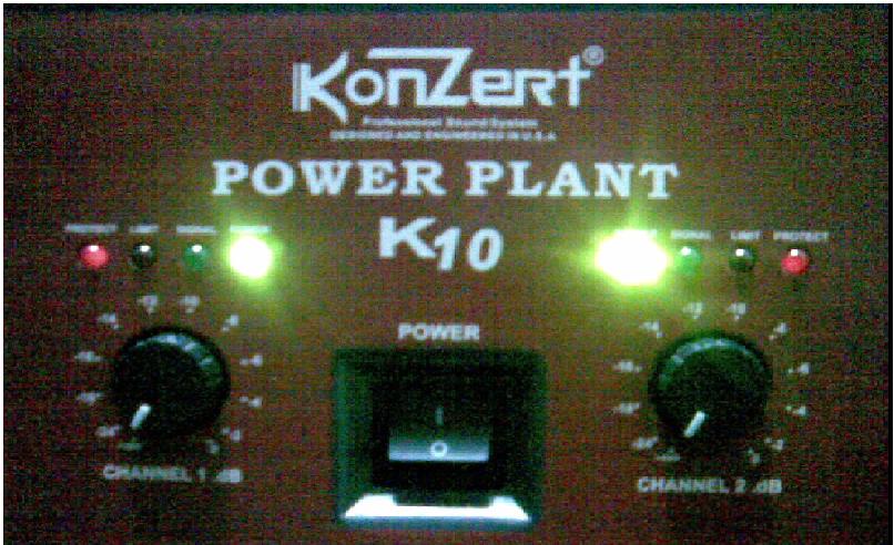

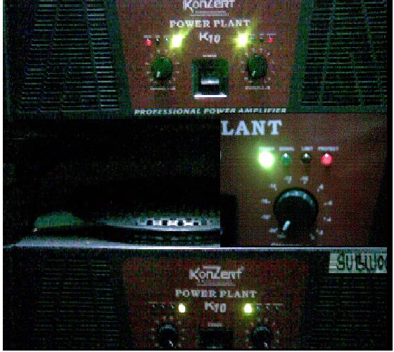

Re: protect
there could be several reasons....depending on the way your protection circuit was designed..
one, there could be a slight dc offset voltage that is below threshold of your protect circuit.
there could be other leds lit up inside your amp...
if your amp operates normally and your speakers are fine, then ther is not much of a concerns here...mere annoyance...
lizgar said:Hi Audiomachine.
Why does my amplifier light up protect? But light isn't too bright. every thing is functioning normally but only the protect light i am curious about 'cause even if speaker is not connected it still lighting...
sir Tony,
Your right it is really annoying, this LED indicators is the only way your amp is communicating with you. Especially in multiple setups, it facilitates trouble shooting on your system. Thats why several high end proaudio amp manufacturer had this system develop, a software base remote amp monitoring system were you could view every operating parameter of your power amp via a PC, temp, load impedance, channel gain, crossover frequency,delay, limiter setting, temperature histogram, current consumption and many more. It is really important that your amp is communicating well with you.
you can check for cold solder, check the trannies, that drives the protect LEDs, they share common reference voltage (on the power supply board) that might be slightly lower or higher than normal , that could be the cause why both of them are slightly lit. Then to be really sure that no "very slow cooking of your speakers" is occurring, check the dc output offset of the amp, set the input gain control of both channel to full kill, then set your DVM to the DC range and measure the dc output voltage of the amps speaker output, It should read less than a fraction of a volt +/-. Though it is very very remote that both of your amp channel is putting out a small dc offset than normal, slightly lighting up the protect LED but failing to deactivate the output relays but HEY it could happen you know where these amps are from keep me posted
