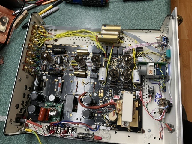

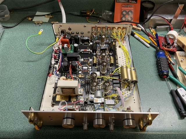

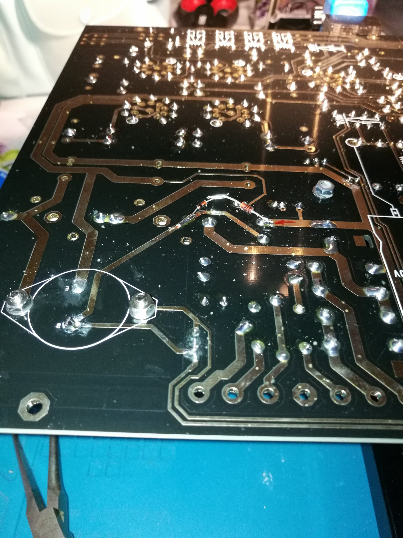

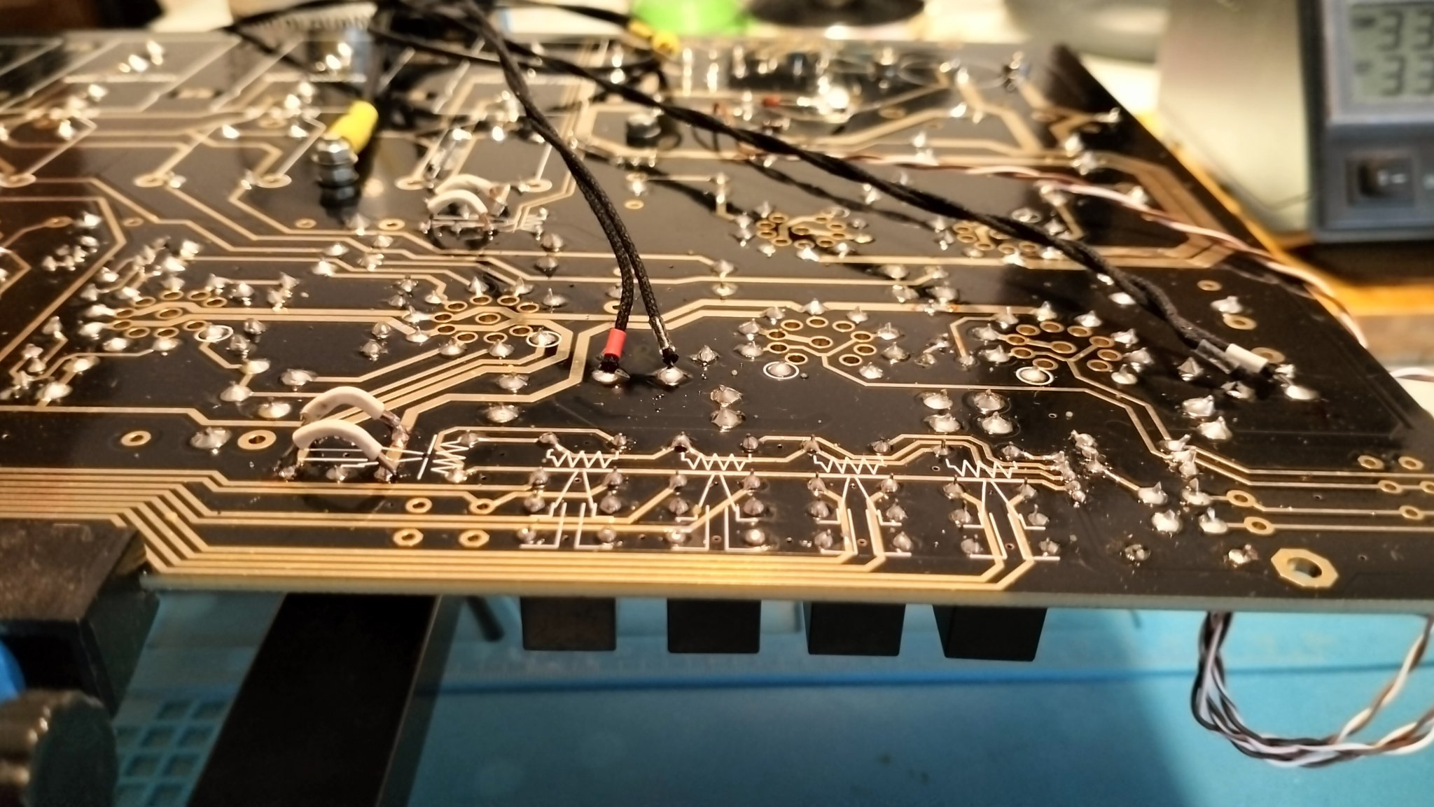

I used this same K77 board to build a preamp last year and have never got round to documenting it here. I did not stick to the original recipe and used the board as more of a basic platform to work from. It is certainly a well made board with good quality traces and lots of room for component changes etc. There are certainly some strange choices made in the power supply especially the filament supply as noted by others.
I wanted the cascode phono input in particular. This allows high gain in the first stage without high input capacitance. I am using MM cartridges and having high input capacitance can cause problems with many cartridges. I have not been disappointed with the results. The phono pre sounds fantastic without the rough edge that my solid state OPA2134 based preamp seems to add to the sound. I had to re calculate the RIAA network to get the curve right. I used different tubes. 6N1p with the option of using other 6dj8, 6922 types. I had lots of them around and they are inexpensive. The phono stage is very quiet, having inaudible noise from the listening seat. It may even be quieter than the SS preamp I have. Gain is 36db in my configuration. I made a few changes to circuitry. I used mosfets for the cascode elements saving a tube. I also used single tube sections for the gain stage in the line stage resulting in phono and line stage using 3 tubes each.

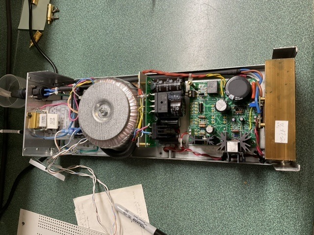

To derail with the filament supply I wired the tubes in each amp section, line and phone, in series and power them with 18.9volts. This reduces the current to a manageable 600 ma per section or about 1.2 amp total. Wired in parallel it would be 3.6 amps for 6.

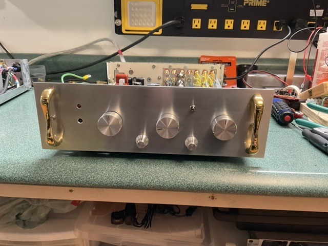

I also included a wireless remote alps volume control and input selector, fine gain adjust controls for each channel and a High frequency level control similar to what Festo audio puts on their preamps so you can reduce the HF energy for bright recordings. I used a separate power supply and a regulated B+ With delayed startup and I am just now adding muting circuitry to prevent turn on /off bumps in the output. I’m very pleased with the results and the boards proved to be well made during all my trace cutting and modifications made to get the result I wanted.

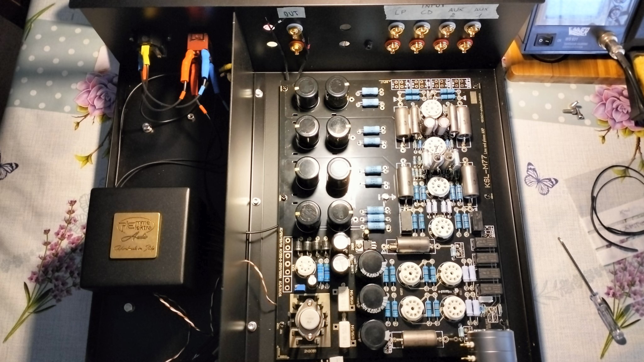

Some photos

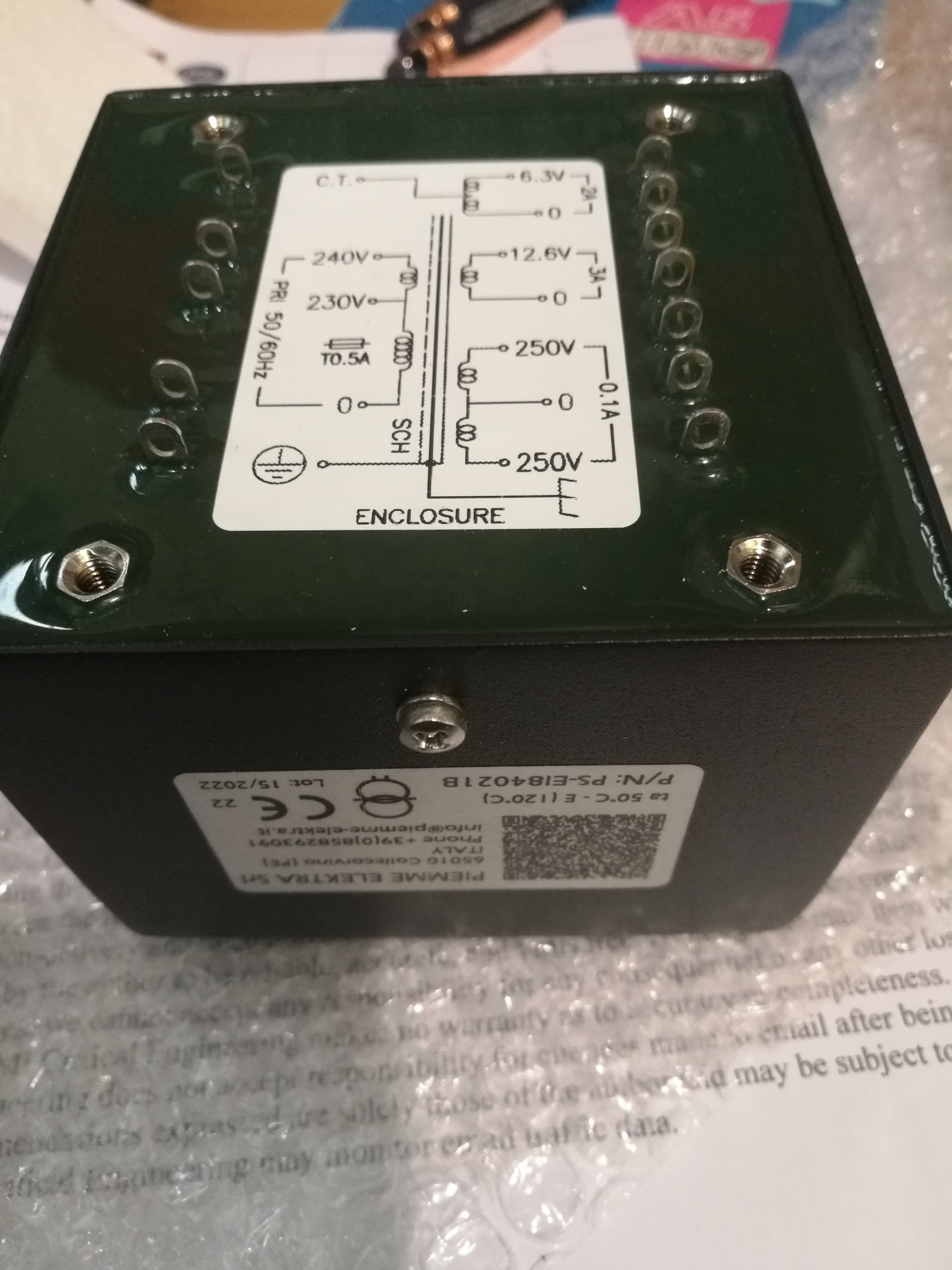

I had the transformer built on purpose by a specialized company here in Italy

Looks like you spent a lot of work on your design, even with an offboard power supply, very nice!
What kind of RIAA and coupling caps did you use? (I noticed three different types....)
Thank You. It’s was a pandemic project. I got back into vinyl big time during the pandemic and after building a SS phono pre I remembered the issue of input capacitance causing HF boost in MM cartridges. When looking for a tube phono pre I stumbled across the K77 board and decided to order one. Many of the choices I made are the result of parts I had in stock. The capacitors in the RIAA are .01uf CDE 400v (the little yellow tubular ones). I got them from Parts Connexion here in Canada and they are supposed to have a vintage sound, whatever that means. I also used a 800v Mundorf .1uf gold Supreme that I had on hand. The RIAA is quite different than what the original was. The stock circuit would not work at all with the 6N1P. I got the RIAA within +- .2db with some tweaking. The interstage and output coupling caps are either Oblligato gold or CDE 940 series. I have 2 sets of main outputs and the phono outputs. I have small and large output caps connected to the 2 sets of main outs. I have a shorting switch on the back of the chassis that allows me to parallel the outputs or I can have the small/large caps on the outputs for use with mains/subwoofer biamping. I used Solens as power supply bypasses. The PS transformer is huge, perhaps 300w rated. Again, I had it on hand and the windings gave the right voltages. I also had the main chassis on hand. I repurposed it from another tube pre that I didn’t like, an Aikido that I built some years ago. I made the PS chassis from an old computer UPS enclosure cut down to the same height as the main chassis. I’ve been doing this DIY audio for a long time and have a good supply of “stuff” for use on my projects. Right now I am doing a muting mod and some other tweaks to the tube pre and I really miss it in my system.

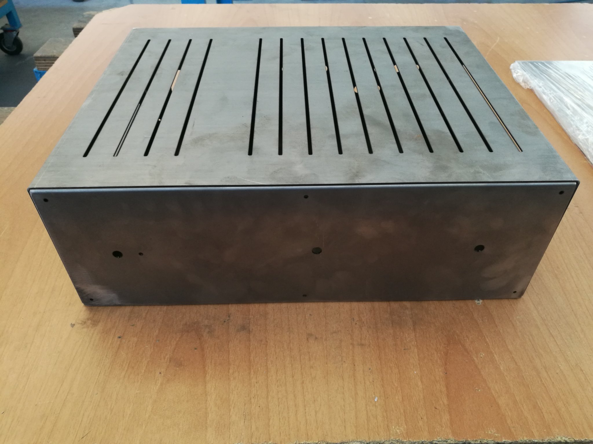

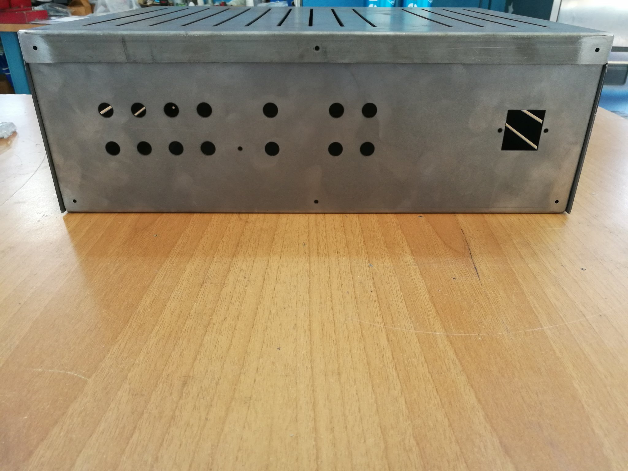

Hi hesener, I soldered the wires on the two relays, plus I made the other modifications you recommended, I hope they go well.
