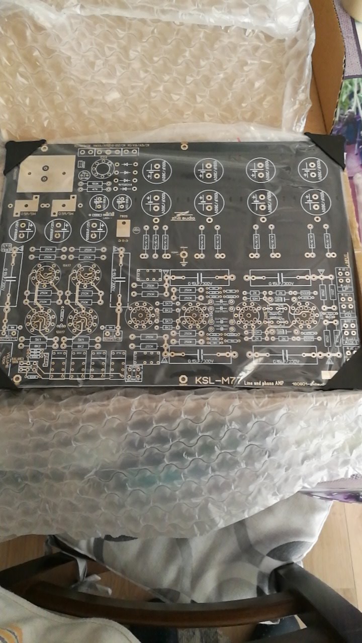

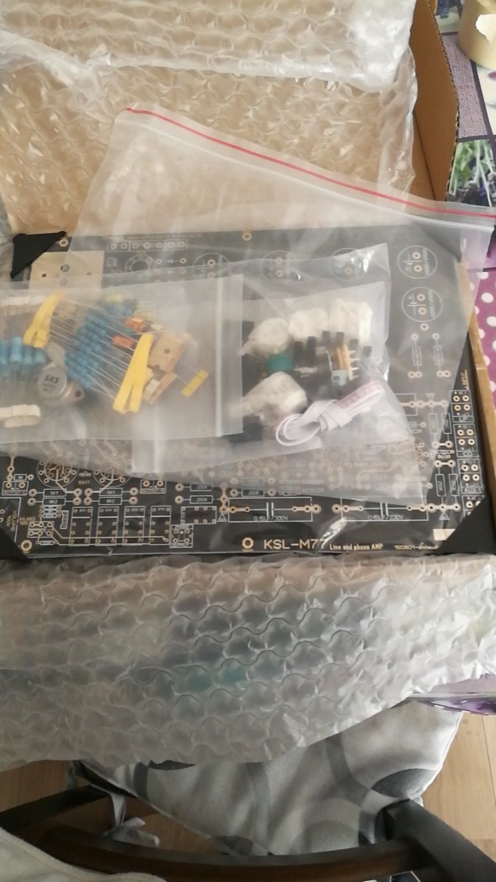

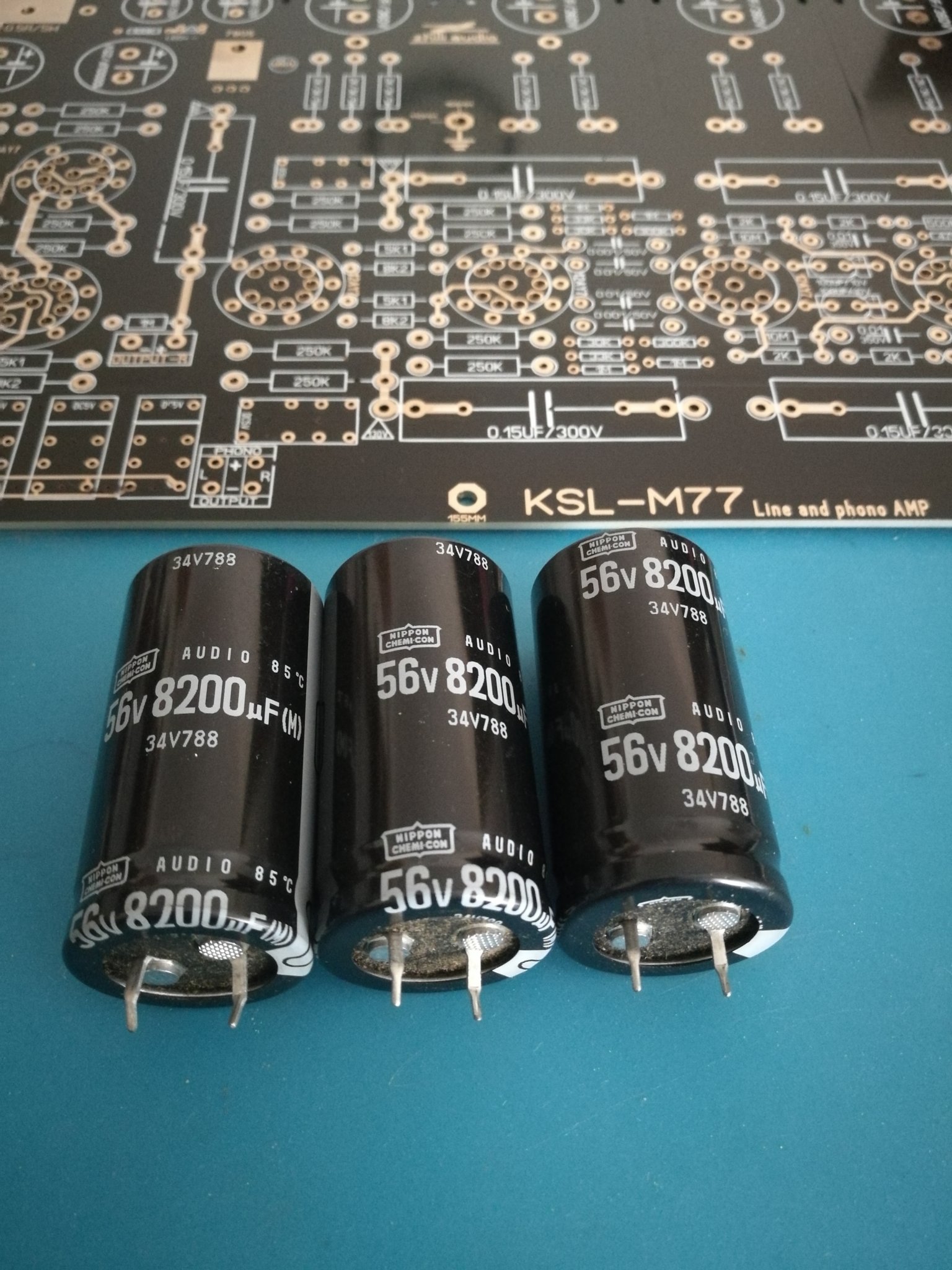

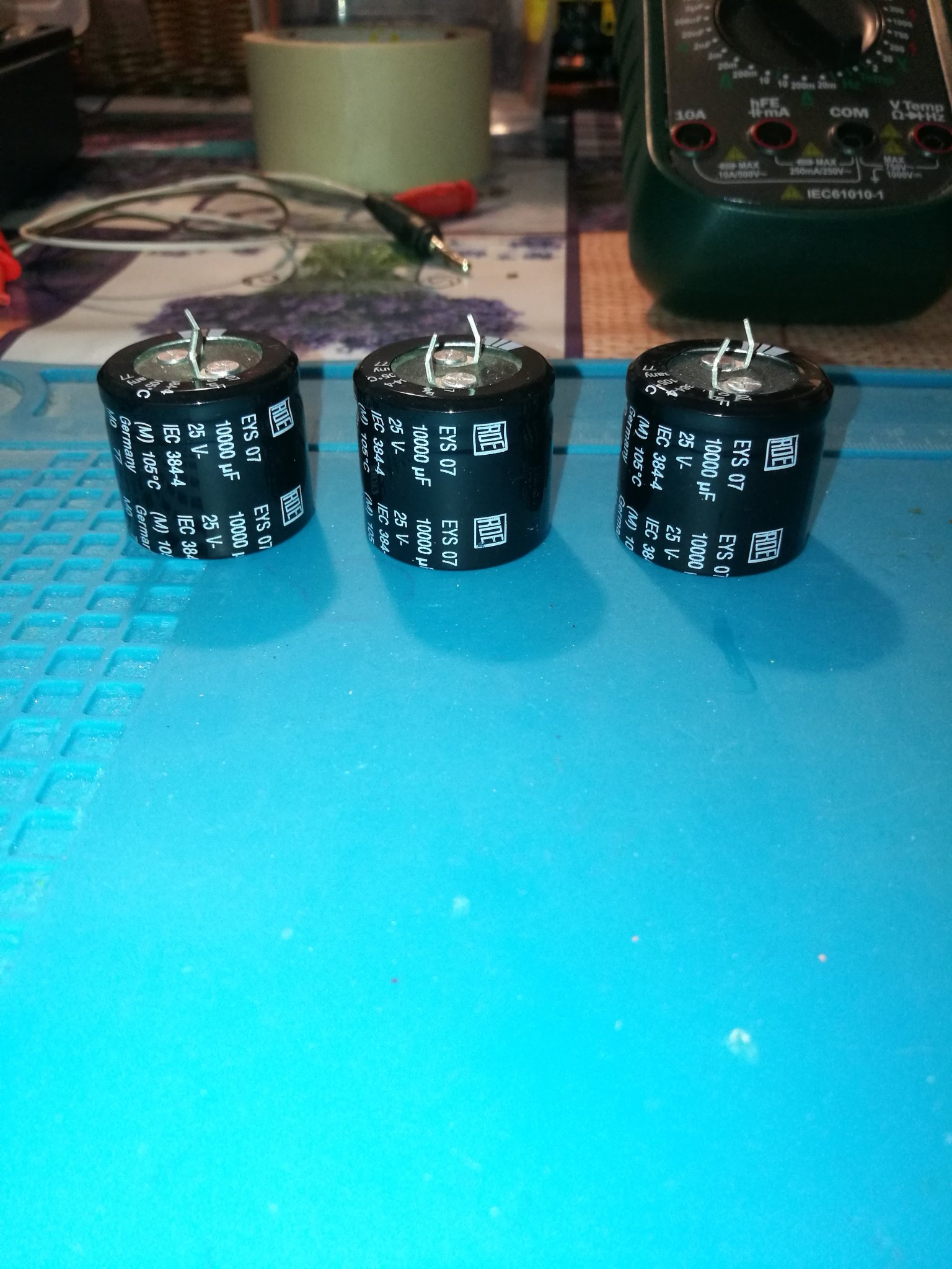

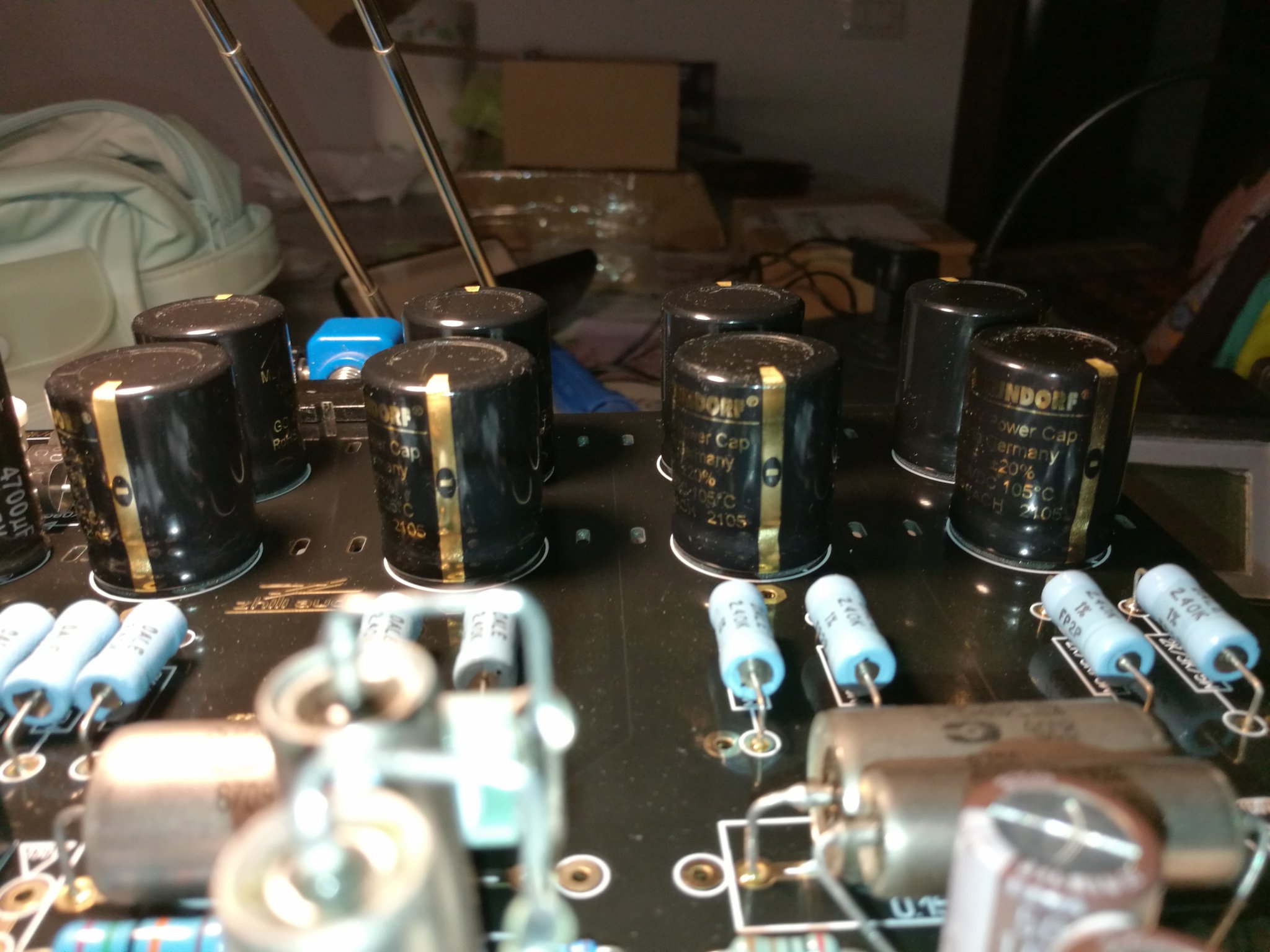

Hi Hesener, pcb board arrived early.Can I use these capacitors I had in spare or are they too old? Thanks

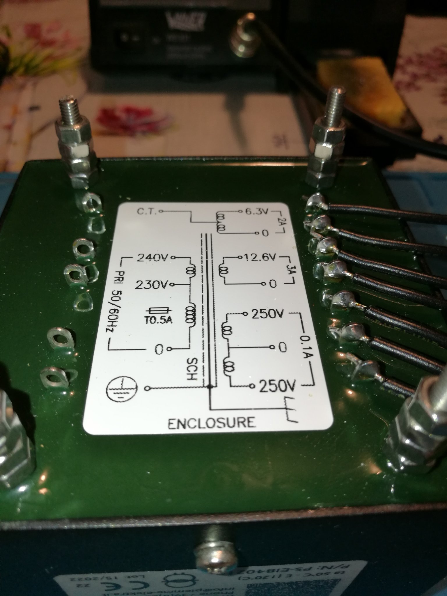

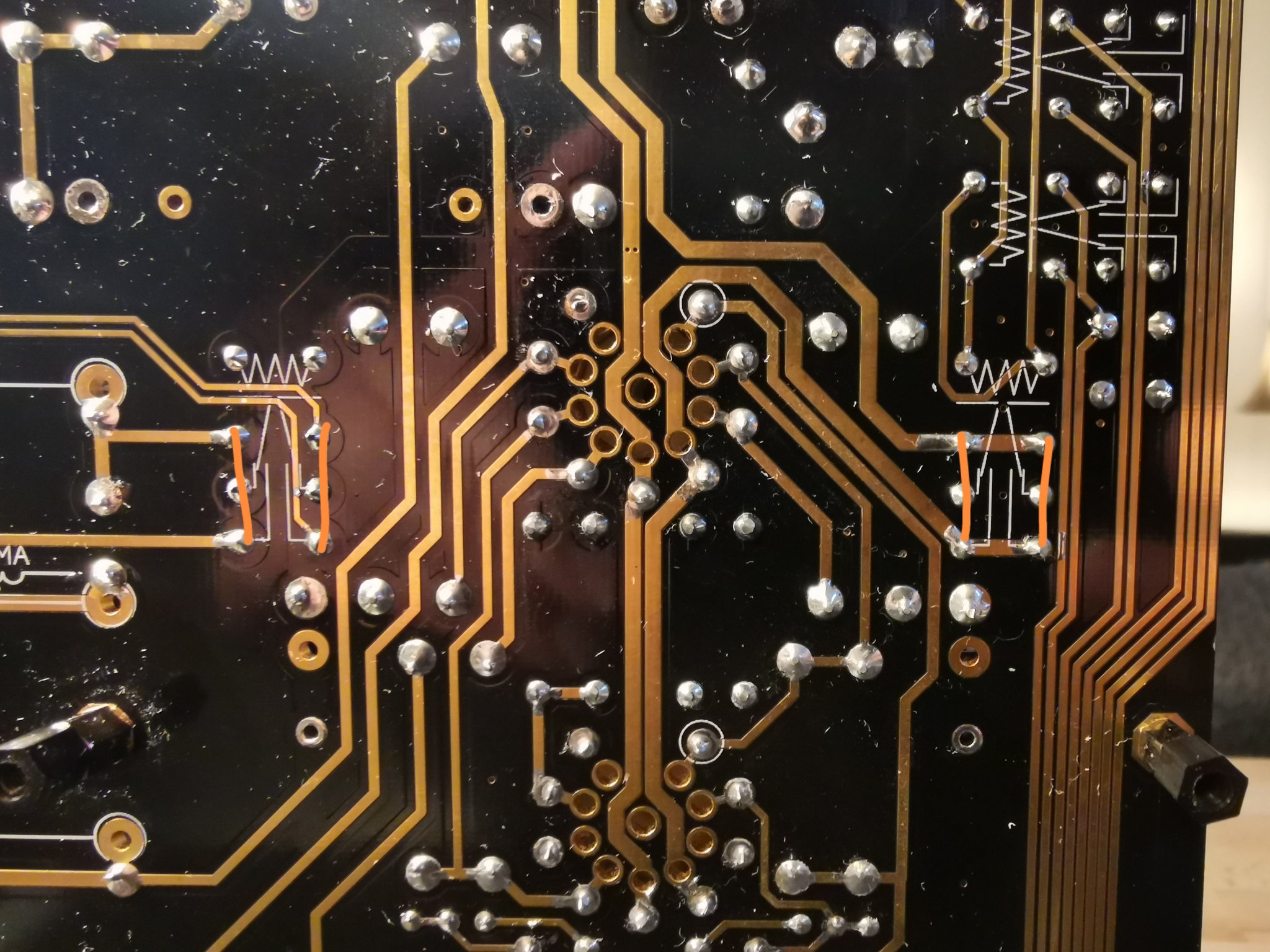

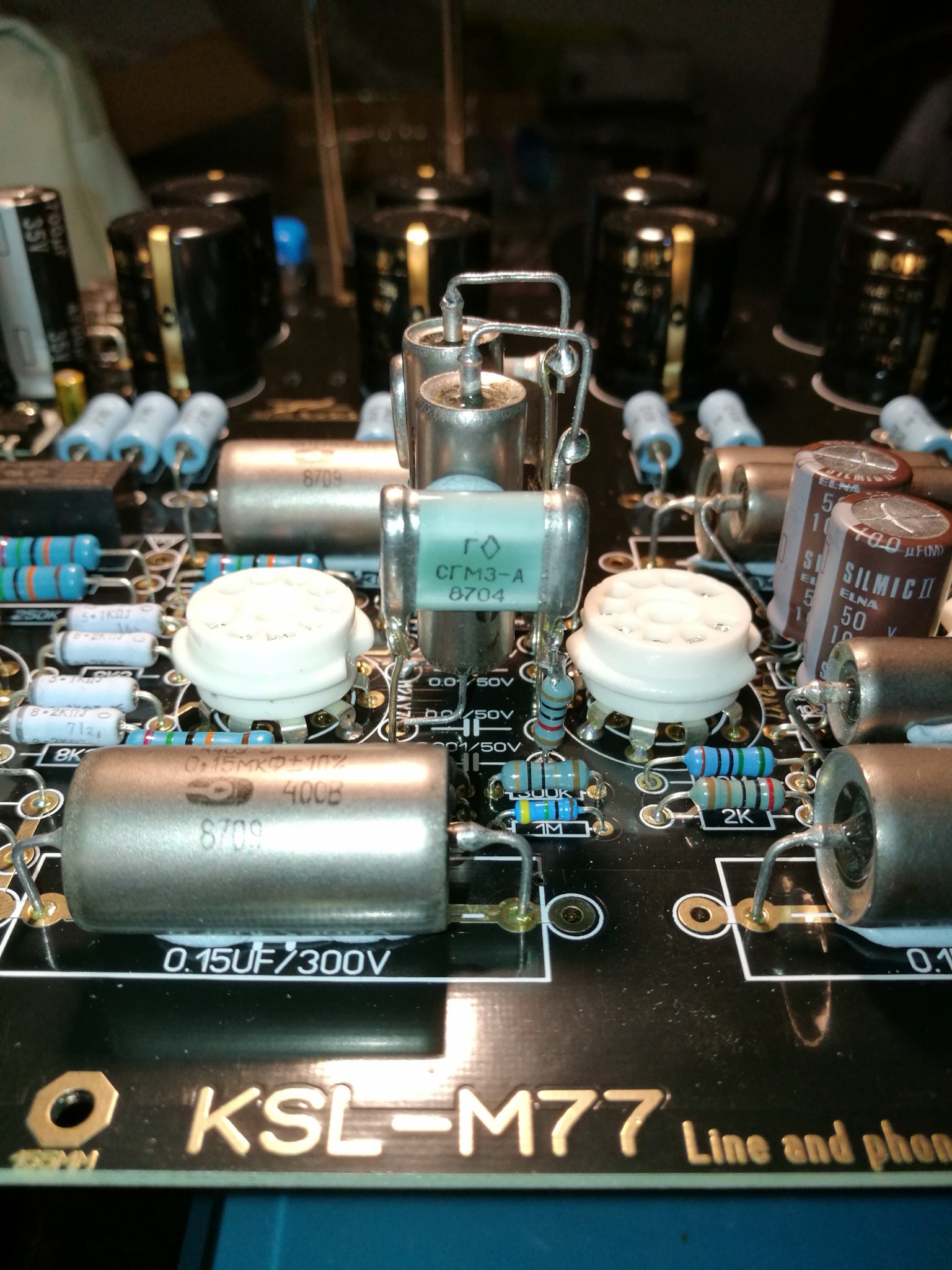

Much have been said, forum style (= chaotic). Here's a somewhat organized take:
  • Heater supply: the original sin, from Kondo-san, I believe: using a 2N3055 as a cap multiplier means the voltage can change significantly with the load. Plus, using the base current to set the output voltage is beyond crazy
  • Switching on and off the phono section can change significantly the operating conditions: this, and everything below, are from the butchers
  • The heater elevation is taken from where the ripple is the highest
  • Shorting the phono output when not in use is beyond crazy
  • The PCB is known to hum, due to the traces for the heaters
  • The input traces are not optimum
  • The PCB real estate is poorly managed: parts are very cramped in the RIAA section, where adjustments need to be made
  • Poor choice of part: 10% polyester caps for the RIAA is beyond crazy
  • The power transformer shipped with my kit has 6.3V/2A, 6.3V/2A, 5V/2A and 15V/2A: beyond crazy
  • Anything I forgot?
You can try to wake up slowly with an external adjustable power supply.
Connect the power supply outputs to the condenser respecting the polarity and in parallel put a load (a resistance) and salts slowly with the voltage.
Watch out that if they really gone could burst so keep hands and face away.

Most of these issues have been addressed in this tread, as you say. I have done the Darlington/Zener-diode modification and modified the RIAA-section (as specified by Hesener). And the preamp is now silent and sounds (thankfully) very good.
I wonder, if I want to keep the phono section on all the time. What do I need to do?

Hi zung, I think your list is pretty good. Personally I was most frustrated by the RIAA section, but thats not complicated to improve, fortunately. I would also add that switching the phono tubes on and off will shorten their lifetime.
I am not sure if Kondo-san intended to use grid biasing in the input stage of the phono section, but I am not a fan, as this (as well as a few other design choices you mentioned) is making operation rely on parasitic device characteristics, which are neither guaranted nor measured, and will drift over time. Rather prefer to have bias conditions locked in.
Not all is bad, though - the PCB is working and an OK starting point, from where to optimize, and learn in the process. Mind you, maybe the guys doing the PCB are listening in here, and may improve their design in the future?

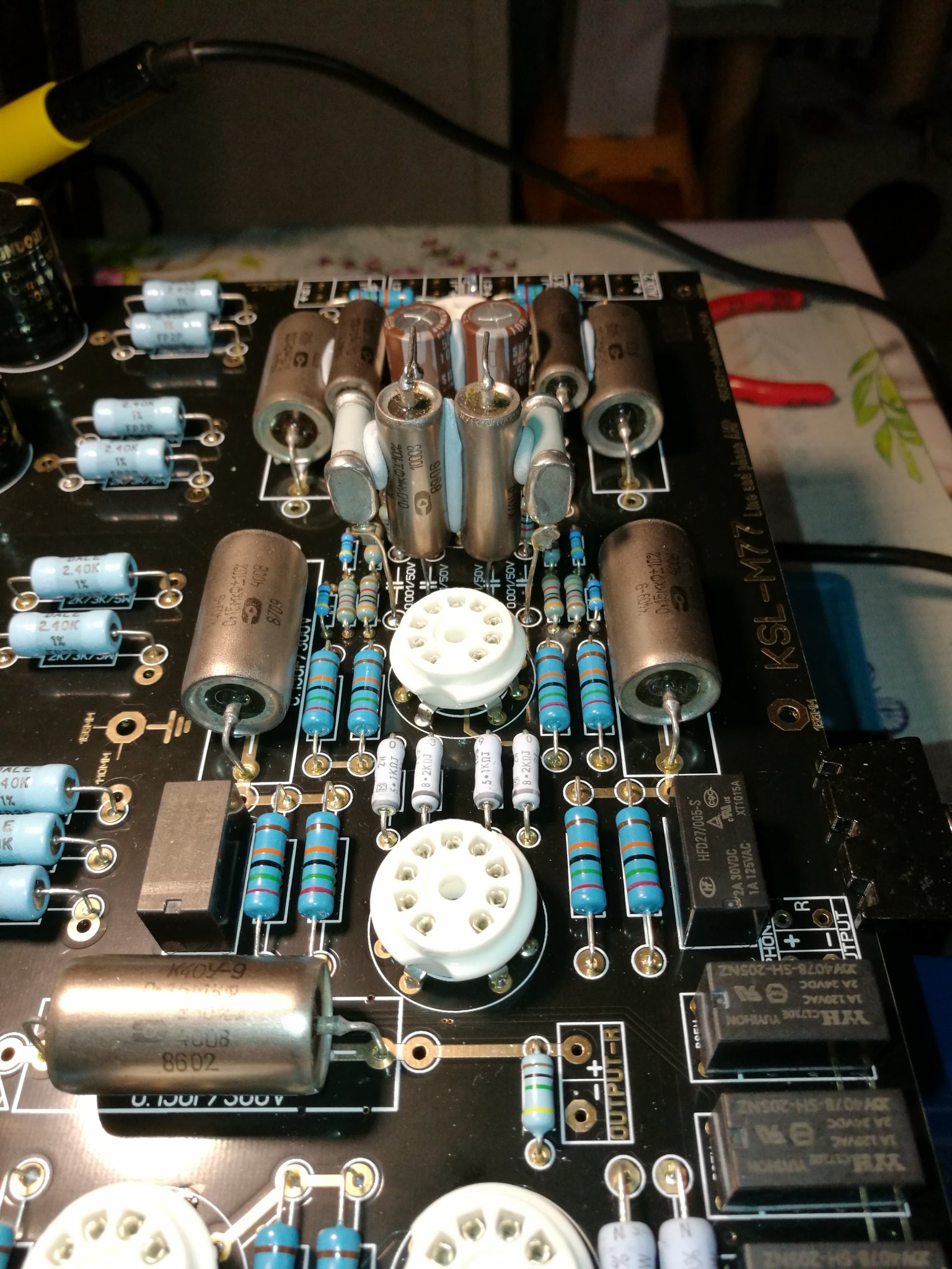

Does anyone have a good supply of reasonably priced 12AY7/6072A tubes? I'd sure like to pick up a minimum of four and get that many reject 12AU7's out of my KSL. But the prices of them these days!
However I did go and buy an ALPS volume pot after discovering my current one wasn't doing it for me. It'll be a little while as it makes its way out of Germany.
But I do wonder about the 12AY7s. My Amperex and Mullard12AU7's sound perfectly fine to me..... will the 12AY7s sound..... better?

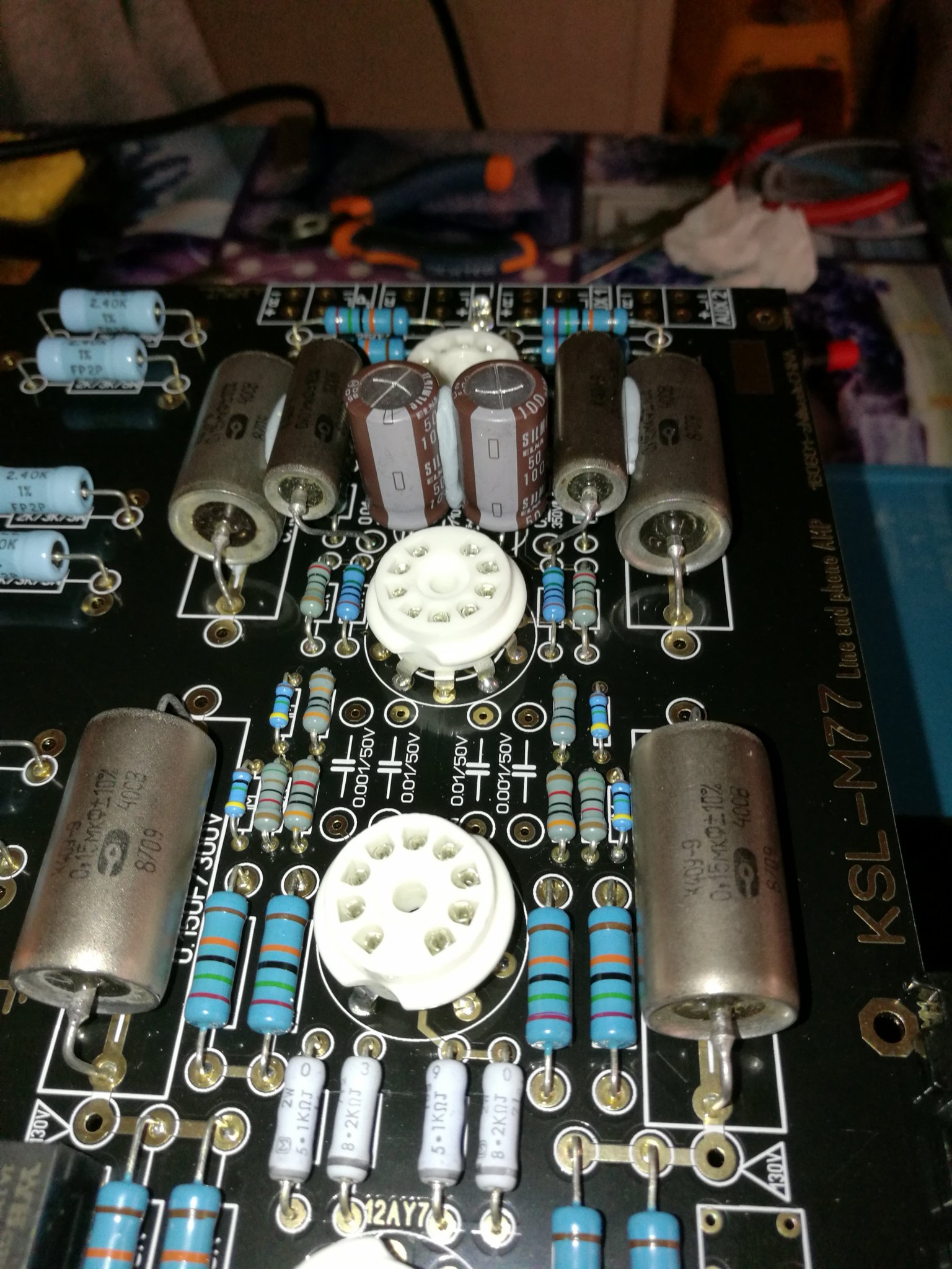

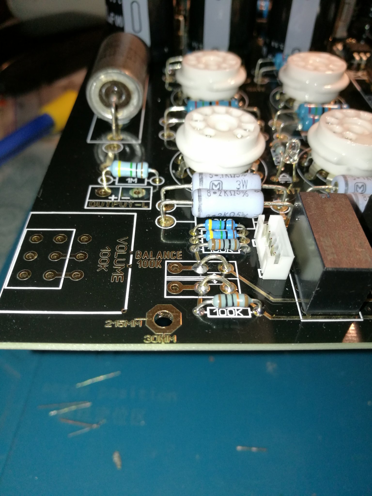

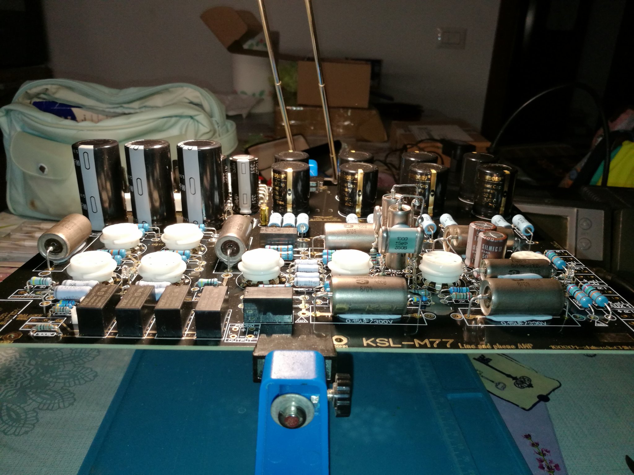

Yes all 6 relays need to be soldered in. But the most difficult soldering job which must be done, is soldering in the ribbon wire connectors. It was at this point where I decided the soldering was beyond my capabilities and for $140, I bought an assembled PCB.
I decided to put the 6X5 back in after I found a source for 7-pin ceramic sockets. The arraignment makes B+ much more steady and predictable.. Besides the cheap 7-pin plastic socket which came with the PCB is pretty trashy and doesnt' belong.
I also put my new ALPS Volume Pot in!! Now that thing is seriously nice. One could even say that the ALPS pot correct many of the problems that cheaper POTs have.
And that's it! I am now a proud owner of a fantastic, and fully functional and fully functional KSL-M77 preamp! I have ben at this now for 17 months and its FINALLY done!!
Except for one thing (Its always something) .. The TUBES!! I have three 12AY7s and five 12AU7s. I'll put another five 12AY7s some day...

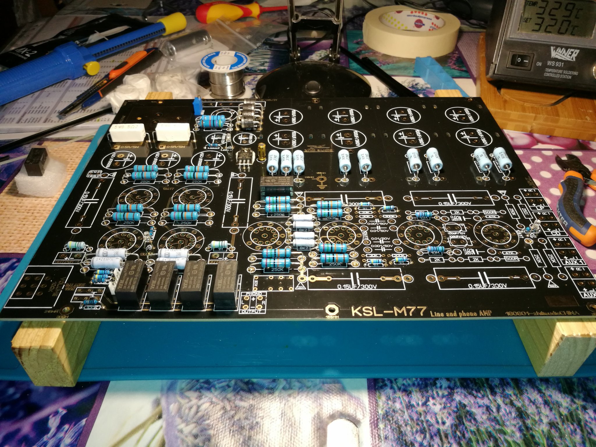

Hi, I'm almost finished soldering the board, I miss the container that I have to make a company I know, and the Eizz potentiometer that will arrive shortly, and then the valves.
Post some photos.
Bye thank you.

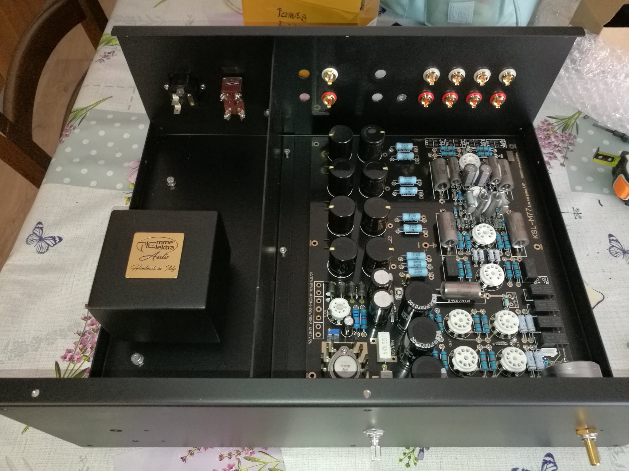

Hello everyone, I present to you my almost finished work.
