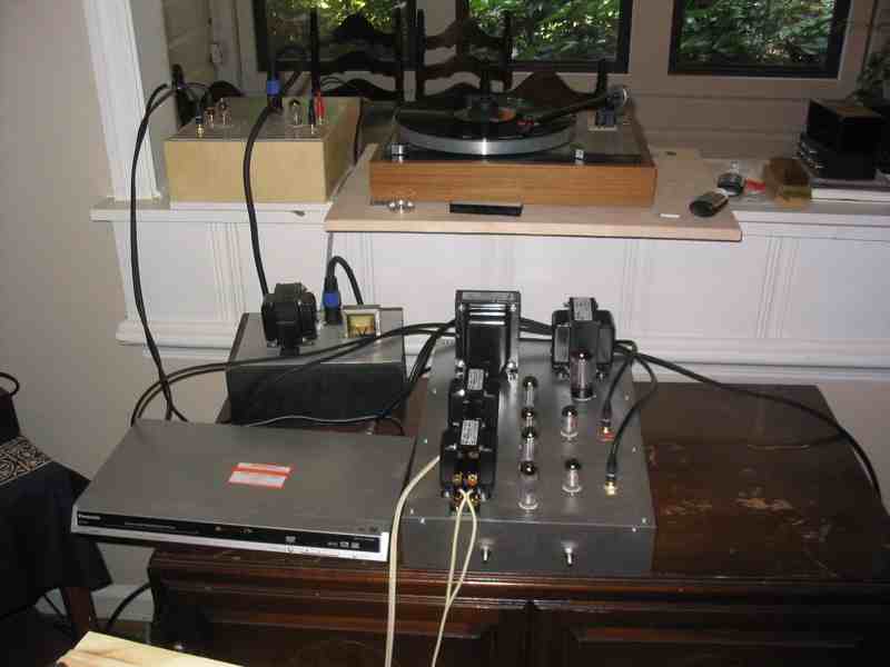

IT'S ALIVE!!!!!!
I have a moderately bad hum in one channel that I'll chase down later. It's one of these deals where when I turn the pot all the way on or off I get a funky ZZZZZZZZZZZZZZZZZZZ sound. I think there's a bad ground somewhere, but if you've got any ideas about that one, I'd love to hear it.
Right now, I just think it sounds so nice. Very detailed and a ton more bass than my SETs. Mingus's bass is really plucky and some of the glare I had before is all but gone now.
Thanks so much to SY, Sheldon, Johan and everyone else. This has really been a great project.
I'd show you the guts, but I'd just get embarassed. It's a better layout than I've had before, but it still ain't good.
More to follow as the amp breaks in.
Really, honestly, this is the greatest community. I just can't imagine doing this without your collective help and incredible patience. You've helped make me very happy and I appreciate that.
Kofi

OK-- so I found part of the problem... maybe.
I was resoldering the 300R input resistors to get them as close as possible to the pins and then both channels started doing the potentiometer ZZZZZZZZZZZsqueakpopcrunch. So I started to reassess the situation and here's what happened.
When I take the NFB resistor / capacitor out of the loop, the potentiometer squeak goes away completely. I seem to remember that the feedback loop needs to be short and mine is pretty long, as in, there's about a foot between the speaker binding posts and the input cathode for the E88CC, which may be causing oscillation, maybe?
Also, it looks like the buzz I'm hearing in the one channel may be independent of the squeak / oscillation issue. I'm continuing to persue this, but what are my choices with respect to the NFB?
Kofi
OK, I'll try that, but I'm sure that I hooked everything up to the correct terminals. Could it be the length of the NFB loop?
Also, I added 50K log pots to as volume controls, but the first 2mm turn rattles the windows and the second turn detroys mankind, so 100K log pots would be better for me, right?
Also, what's the harm in running these without the NFB loop? Would I need to change the cathode bias resistors or is the NFB loop exclusive of that?
Getting closer, but still need help...
Kofi

Good question. I'm using Fostex 206Es in a backhorn. They're 96dB out of the box and maybe a bit better in the horn enclosure, so this is hopefully the issue. I'd like to continue to use these with the amp, but I need to de-sensitize-i-fy the volume control.
So, I'll experiment with the NFB loop and see what I can come up with. All of the RF noise is gone as well, so it seems that the NFB was the culprit in both instances. I'll try and keep it way the hell away from everything and see what we get.
Thanks!
Kofi

I checked the pots and they seem OK. I can check for DC on the input grid, though.
But this could still be instability. You mentioned curing this - is the "pot noise" still there after the cure?
Nope. Pot noise is gone and all RF interference noise is gone too. Sounds dead quiet even on 96dB horns.
Running without NFB will of course give too much gain, and is not a solution - the NFB is there to get distortion down. (This is getting difficult, not being there to see what a scope shows.) About the question of long wires: The length is not so much the thing (talking within practical limits) than where you run it. Is your output leads away from any inputs, also the NFB lead. Again, pardon me for being lazy and not run back through all the posts to see whether you have access to a scope; it might become rather necessary as you run into more complex problems. Any hope there?
I'll try and re-run the NFB loop to and get it well away from all other noise-bearing components.
I do not have access to a scope and it's unlikely that Mrs. Annan is out getting me one right now, so I'm stuck with what I've got, which isn't much.
The Bevois Valley schematic is in Morgan Jones' Valve Amplifiers and might be a copyright thingee to post this here. If it's not a problem, I can mock up a schematic and post it.
I'm running it now with after a phono pre that does not have as much gain as a line-in CD player, so there's a better feel to the volume control, but I know I need the NFB back in. I'll work on that.
Kofi
