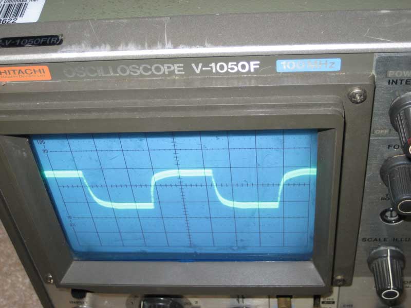

OK-- so Kofi did a little investigation today and it seems that the feedback is playing a substantial role in the crappy square wave. With the feedback disconnected, here's the new square wave.
I admit it still sucks and all, so I'll need to know how to fix this problem, but my greater concern is how I'm going to keep the feedback instituted and get rid of the oscillation.
Take a look and let me know what you think.
Kofi
Kofi

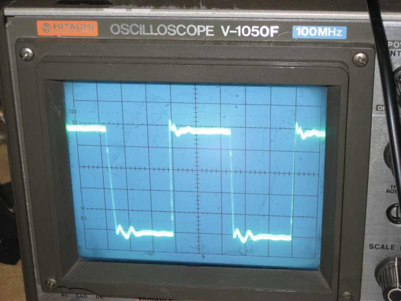

OK-- so some experimentation today.
I hooked up the air capacitors / variable resistor as instructed and I'm beginning to understand a few things:
It looks like adjustments to the variable resistor regulate the spike on the leading edge of the square wave. More resistance makes the spike go down.
Also, I thought that the variable resistor would form a parallel resistor combination with the load resistor, so I initially didn't understand how this would be helpful. Now I know that this is incorrect and I believe that the variable resistor / variable capacitor in parallel with the anode load is acting a a sort of a filter.
I know my assessment isn't quite right, but I'm getting there.
The super-crazy oscillation appears to have diminished significantly, but I need more resistance to calm the initial spike on the square wave-- the 10K just isn't doing it. I added a 1.2K job I had laying around and we're closer, but not quite there yet. I need to head to the Rat Shack to pick up some additional high-wattage resistors to add in series (or maybe a 25K variable resistor).
Also, also, the actual vertical components of the square wave look thin and mostly straight, but the horizontals are a little "thick", which I believe indicates some oscillation. I'm guessing all of this needs to go away, but maybe some is normal?
Also, also, too, I found I had to parallel sections of the variable air capacitors to get any impact. Again, this may be OK, but some commentary here would be welcome.
I did this without a capacitance-o-meter, which I recently bought from eBay and may be here in the coming week. Once I get that, I should have some additional insight regarding the capacitance.
Anyway, that's the update. More to follow as I assemble the rest of the testing rig. Comments would be most welcome.
Kofi

Sounds as though you're going in the right direction. You don't need to worry about the power rating of the resistors (they're not passing any DC, so they won't dissipate much just from the signal), but you will need to make sure that the final polystyrene capacitors that you fit in place of your variable capacitors have 250V rating or more.
I would guess that the fur on the tops and bottoms of your square wave are hum. Try slowing your 'scope down and triggering it from "line". If it all becomes stationary, you know it's hum.

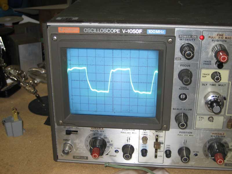

So, I added some resistance in series with the 10K variable deal, fiddled and got the attached square wave.
I think things look pretty good on the leading vertical edge (looks pretty straight) and on top, with the exception of some hum. The following vertical edge and the bottom look like they could use some improvement, however.
I guess at some point you just stop and say, "good enough". I'm thinking I may be close to that, but if the following edge / wave bottom are so troublesome that they need some attention, I'll keep pursuing it.
Also, I noticed that my plate voltage for the first stage is a little high-- about 310VDC. This could also be causing a problem, I'd guess, so maybe I need to drop a few more volts.
Comments?
Kofi
