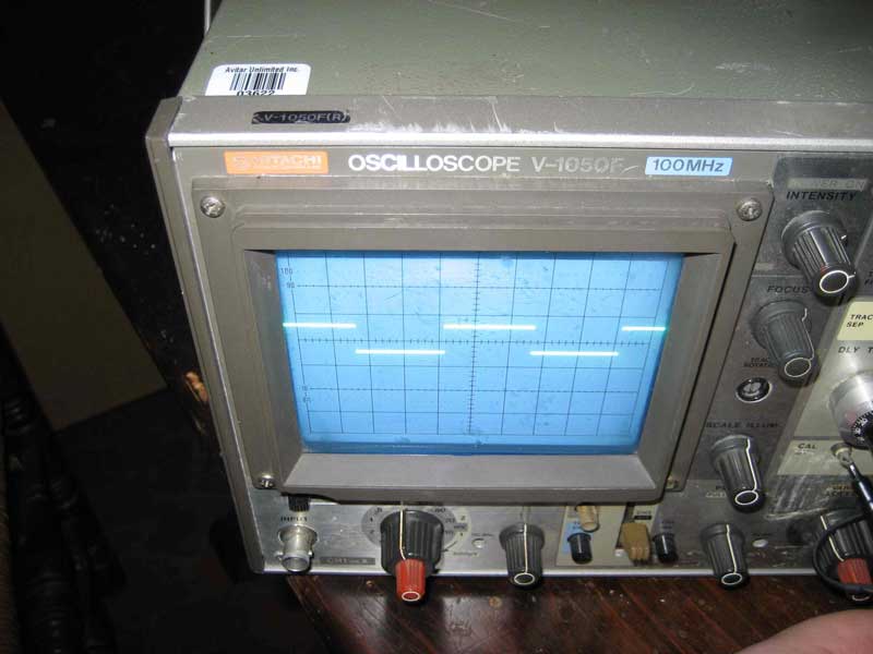

OK, so it ain't a Cadillac, but the price was right. Now I know that I should have consulted the community first, but this was cheap and staring me in the face, so I pulled the trigger.
Now you may advise as to why I should have never purchased this model or bought from this vendor or paid this much, etc., etc.

Alright! Scope and probes have arrived and everything appears to be in working order!
So I used the self-calibration lug (.5V) to try and test the square wave and it looks like the sort of square wave Picasso would draw. Its not flat-- its angles quite a bit. I looked for any controls that I thought might help to calibrate and nothing doing.
I'm guessing I need to calibrate the actual probe, then? Also, I can get the probe pin to read the the .5V signal, but not the attached alligator clip. So, there's something else I need to do there, right?

Theres should be a screw setting on the probe to let you tweak it for optimum square wave response. Usually it's on the part with the BNC, but sometimes on the probe body.
Alright! Thanks!
I see where the adjustment is necessary to make the edges of the wave flat, but the wave still isn't really a square wave. It goes like this...
...with one leg shorter than the other, then inverts and repeats.

Kofi,
to test the scope you could link from the test point to the bnc connector, that'd prove it was the probe or not

Heres where I find out I'm lucky the 'scope hasn't gone 'pop'

Sounds like an open probe. You might try wiggling the BNC connection a bit, and/or make sure the probe spring tip is properly seated on the probe body.
Sorry to ask you obvious questions, but are you sure the settings for each channel are exactly the same as the other? Especially, make sure both channels are set for DC coupling, not AC. Are you using the same scope probe, and merely moving it from channel one to channel two? If so, it would appear that something is out of whack.
Sorry to ask you obvious questions...
That's funny. Its me, man. Kofi. There ain't no obvious questions here.
...but are you sure the settings for each channel are exactly the same as the other?
Well, I thought I did, but apparently not. I checked them over and I was able to play with the vertical and horizontal on the "bad" channel and get a dead-on square wave calibrator like they have in the pictures!

Kofi Annan said:OK, so I have some pictures for you guys. First, channel one using the calibration square wave on the scope. This one looks bad:
Did you try to calibrate the probe? (small screw-driver-adjustment in the blue plastic-collar of BNC-plug)
