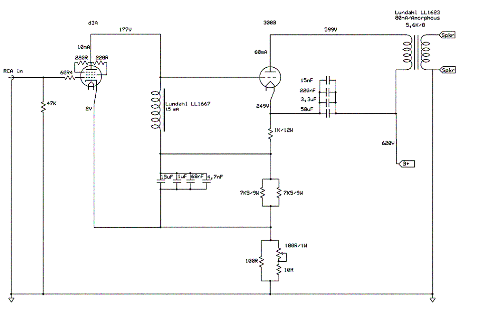

Some questions that popped into my booze-addled mind are as follows:
If I wanted to add one of them fancy panel ammeters, where should I connect it in the circuit? I'm just thinking that since a trimpot will adjust the output current, it would be nice to make the adjustments and monitor the current through a panel meter.
Any recommendations on where to get a nice, cheap panel meter would be much appreciated.
Also, I'm thinking that this meter will be in the signal path, which may be a bad thing, but maybe not.
Thoughts on this one?

A current meter has to be inline, IE the current has to flow through it unlike a voltage meter which can measure the difference in potential between two points.
On most amps the meter would do inline somewhere between the cathode and ground. This schematic is a bit different but putting the meter either above or below the 1K/12W resistor would measure the 300b current. Putting it between where the 100R and 10R resistors connect and ground would measure total current including the input stage.

OK, got it, I think. But would the meter be able to handle the voltage? I'm guessing you mean that the meter would not be parallel to the 1K resistor, it would be the path the current had to take to get to the 1K (assuming the meter is affixed above that resistor).
Am I making any sense?

Kofi,
A few notes on putting in a meter.
I assume you want to show the bias current in the 300B tube.
In assume you also do not want to show the AC (audio) currents.
You already have a 300B current sense element in your circuit which is that 1K resistor.
A quick look at the circuit shows that you have 245 - 177 = 68 volts across that resistor (at idle) indicating that you have an idle current of 68mA. (Carefull - in reading this off I ignored any voltage drop in the grid choke, but it doesn't affect the calcs below).
For simplicity I would then choose a meter with a 100uA movement and let the 68 Volts cause a 68uA current in the meter (to show 68 on the meter).
From the top of the 1K wire a 1Meg resistor to the +ve of the meter and connect the -ve of the meter to the bottom of the 1K. (1 Meg gives 1 uA per volt)
Now to filter out the AC and just read the DC you need a cap across the meter. Unfortunately the meter by itself has a very low impedance and so a very large cap is required.
So we pull a "stunt".
- instead of that 1Meg resistor use 2 x 500K in series (not common value so use 470K + 470K + 56K or similar).
Wire your cap from the mid point of these resistors to the -ve of the meter. We are now talking about at least 500K impedance that the cap goes across and so for say 1Hz response a cap of 330pF will do the trick.
As far as shunting the 1K goes we have 500K and 330pF in series. It will have negligable effect on the amplifier (actually it will cause a 0.2% increase in output above about 1kHz - the frequecy at which the impeance of the 330pF is equal to about 500 K ohms). You won't notice. If we were going to be total "smarty backsides" we could even manipulate the R and C values in the metering circuit to help optimise the high frequency response of the amp - BUT we won't.
You may have to recalculate according to the meter you end up using but you get the drift.
Main message is that you want to be using a 50uA or 100uA movement meter such that the meter current is negligable with respect to the current that you are measuring. I suggested the 100uA so that you don't need to overwrite the scale - just change "u" to "m". If yu used 50uA movement meter you'd then need 2 Meg of series resistor to give 0.5uA per volt and you'd have to change the meter scale printing.

Excellent explanation, thanks! I think I understand what to do here, but unfortunately the meters I ordered are already in mA, so I think I need to use it inline without the divider network.
It sounds like I can place it above or below the cathode resistor and make it work OK, so that's the plan for now.

gingertube said:In assume you also do not want to show the AC (audio) currents.
Correct me if I'm wrong, but a DC movement with AC superimposed on it will not register. The AC will essentially be placing forward and reverse forces on the movement, with a net movement of zero. Only the DC will physically move the needle.
