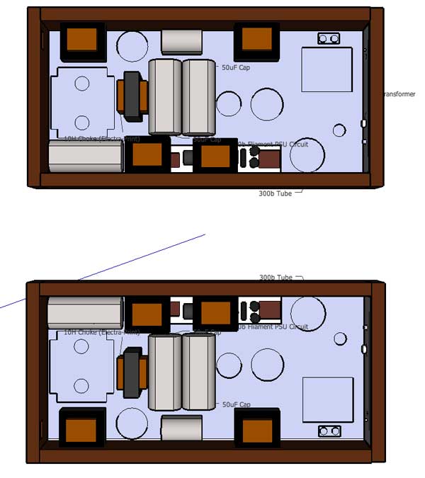

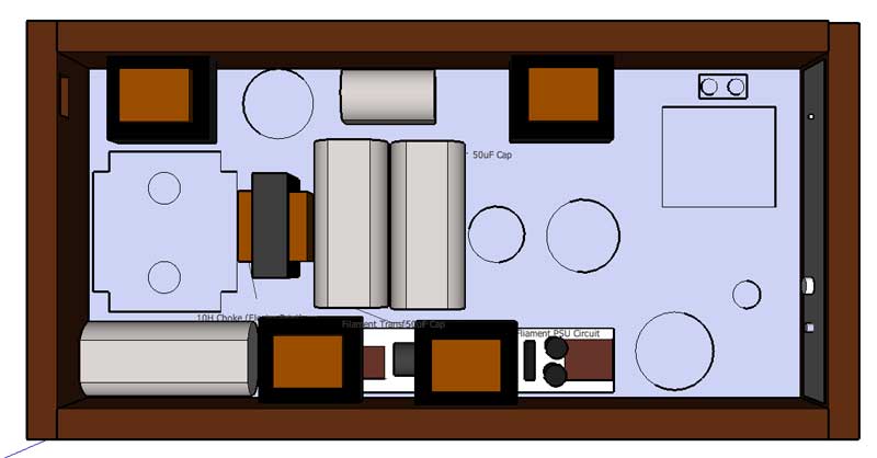

OK-- last go 'round, I hope.
I'm trying to leverage aesthetics with a desire for a short signal / wiring path, so I did as suggested with the cap-n-rectifier swap, but I couldn't quite realize the center-of-the-amp presentation for the OPT and 300b.
Anyway, I think this marries a reasonably good look with an allowance for a short wiring path. As long as everthing looks hunky dory with the transformer orientation, I think this will work.
Have a look:

Sheldon said:Now for some fun, do a mirror for the other channel.
Sheldon
Zzzzzzzzzzzing!
garbage said:
Will do! Thanks!

To make best use of the aesthetics, why not turn it through 90 degrees, with the controls on what are now the 'onside edges'?
More space to see the pretty glowing things.
Of course, depends on the shelf space you have for them.
James
James
I'd really love to, but as you mentioned, shelf space causes a problem. These things are going to be 12" x 24" and I'll likely have to knock out a wall once they're complete.

Hey Kofi,
Looking again, the 274’s that I mentioned looked so good were the TJ meshplates. Pretty but spendy. I don’t think the more conventional ones give as much of a light show. So, it may not be worth the redesign. Still, size and shape wise it is a good balance with the 300B…John

Yeah, the TJ 274s have been removed from consideration due to price. I am using the Valve Art 274B (it's the one on the right in the picture). At $18 a pop, its priced to beat the band.
I'll probably leave the layout as is, although I wish I could compact it more. I just got a 12" x 24" piece of aluminum sheet to play with and realized how huge this motherfather is! To put it in perspective, it's going to be twelve inches (one foot / 30.48 centimeters) by twenty-four inches (two feet / 60.96 centimeters).
If you made a scaled-down drawing of the distance from the Earth to the Sun such that this distance was one foot in the model, then the length of my amplifier would equal twice the distance from the Earth to the Sun! For ONE CHANNEL!!!
Holy cow!
