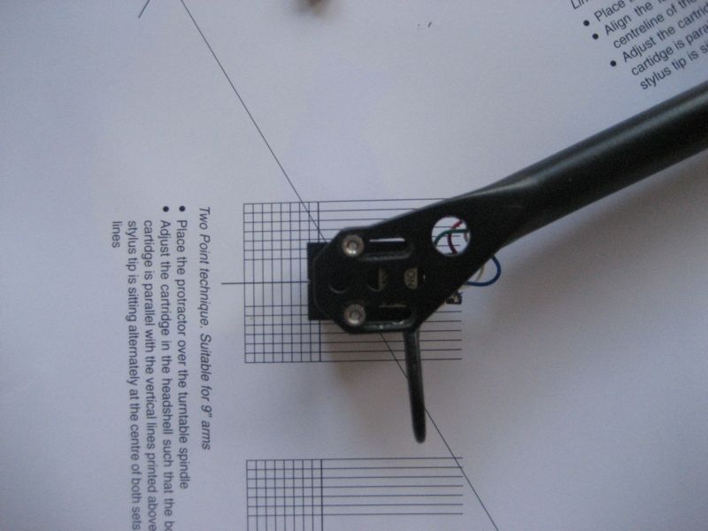

1. The Rega arms appear to not allow (at least initially) the proper overhang for the Denon cartridge-- it misses it by about a millimeter. Like Mrs. Annan, the DL-103R is built solid and really old school, i.e., the mounting inset is located really close to the needle, leaving not much room for forward adjustment in the Rega headshell.

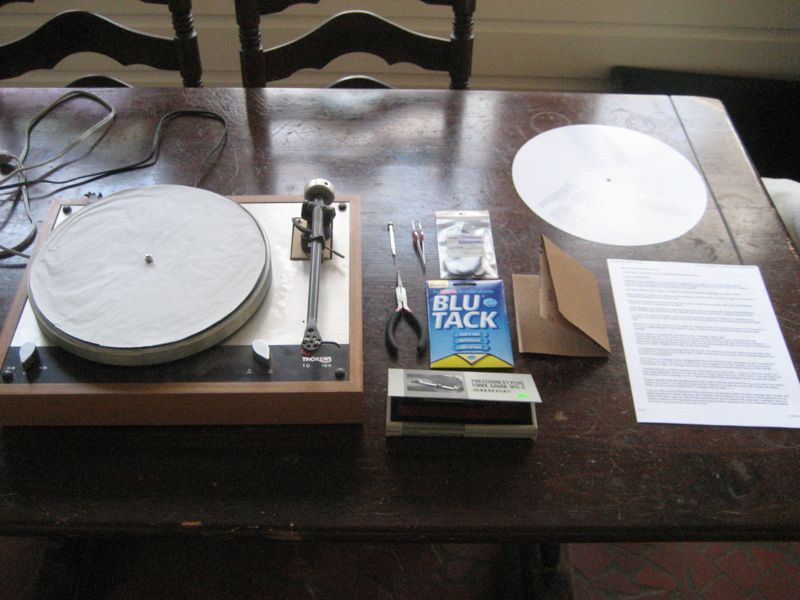

After building the MC stepup, I ordered the following:
* Denon DL-103R (these guys were really fast).
* Hi-Fi News test record
* Shure tracking force gauge
* Blu-Tack
* Rega VTA Adjuster
Once all arrived, I started the installation process...

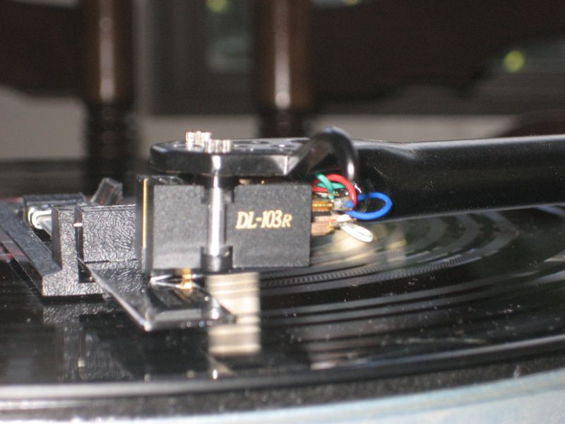

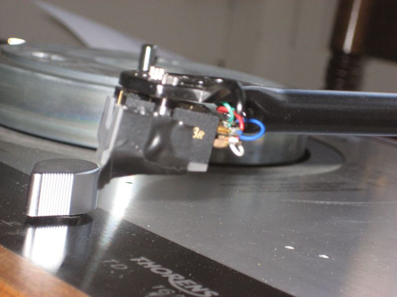

Getting the old cartridge off was a piece of cake, but they don't make it easy to mount the Denon. Not only are there are there no threaded insets, but there's no actual "hole" either. There's just a half-moon indentation where the screw goes.
Furthermore, it's not an allen key-- it's a tiny slotted screwdriver head that faces downward, where almost no screwdriver can go. Try that with only two hands and a hangover.
My solution was to keep the screws in place with a little electrical tape lightly affixed to the cartridge. I just needed to get the nuts started, so the tape worked perfectly.

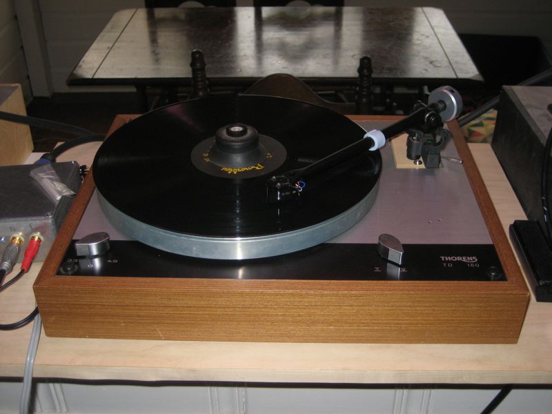

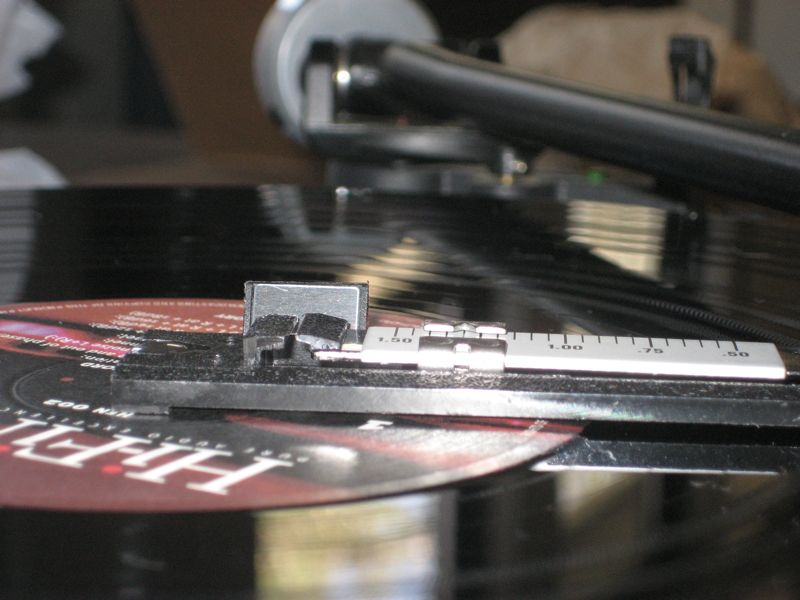

Finally, I used the Hi-Fi news record to fine tune. I was able to track all of the first side except for Track 9 (the "torture track"), which was expected.
On the second side of the LP, I had expected to find that that the resonant frequency of the arm / cartridge combination was too high, which is exactly what I did find.
The initial results were that the resonant frequency was about 17Hz. I was looking for something in the 8Hz - 12Hz range, so I needed to modify the arm to add some mass. Here's where the intense customization came into play.
This took lots of time and lots of cash. I bought a milling machine to mill about two grams worth of perfectly-balanced titanium which I then sent through an electrolytic bath (which I also purchased) to ensure proper molecular alignment (good for proper resonance).
I affixed the final product to the tonearm at the impedance / resonance peak which was found using the following formula:
w = ∫ HdB + ∫ EdD 1 + αT 1
With the help of an electron microscope (eBay) I then fused the mass to the tonearm at the precise point above using a small, but powerful laser (found in trash outside apartment complex).
You can see the results below.
I admit that it looks like a $.07 blob of Blu-Tack wrapped around the tonearm, but in reality, it cost about $1.8 million after all parts were purchased. Well, in retrospect, I guess you could just use the Blu-Tack.
I had to readjust the downward tracking force and the anti-skate once the mass was added, but I was able to get the resonant frequency down to about 11Hz, which is good enough for government work.

able to get a two-point agreement using the Hi-Fi news protractor, but again, the overhang was short by 1mm
I never failed aligning DL-103s in Rega arms using any of the standard templates. Is your arm base to spindle distance correct?
Well, I'm right at 222mm base-to-spindle distance, which puts me short on the overhang by about 1mm. Hopefully, this is no big deal as remounting the arm would take some frustrating work. I had to make my own armboard out of MDF, so I'd need to make another one to shorten the distance by 1mm.
