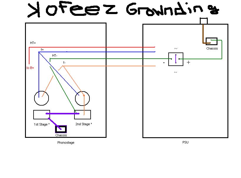

OK, I will then. Check out the attached pretty picture of grounding. Drawn with precision using an Industry Standard drafting program(me).
I think I had the right idea initially, but what blew my injured mind was that the HT- supply was attached to the unnaturally-acting diodes that were then attached to the Earth connection in the PSU box. I'm betting that once I ground the HT- supply in the phono stage box, this effectively gives me the safety ground I need back to the Earthed PSU box, right?
Please say right. I can see paradise by the dashboard light, here.
In case some aspects of the meticulously crafted drawing escape you, the brown wire in the PSU box represents the Earth ground. The square doo-dad in the PSU box are the sinful diodes with the AC connections shorted. The round thingees in the phonostage box represent the tube sockets.
[One question about the filament wiring-- I think I need to tie pins 4 and 5 together in the ECC83 and ground pin 9 rather than have the filament + on 4 and the filament - on 5. I know there's a reason I'm wrong on this, so let's hear it.]
That should explain everything in the draft image...

Hopefully, this is correct, but as always, let me know if its not. I'd love to have understood this at last. I really would like to hear this thing someday...
Yes, the -HT line brings throuh the Earth.
Your drawing is all right, EXCEPT, the bridge rectifier is wired wrong. Short the +/- terminals and connect one ~ terminal to the -HT line and the other to the chassis.
Learn to draw safety ground always as green/yellow.
this needs rotating by 90 degrees to work...
Kofi Annan said:
[One question about the filament wiring-- I think I need to tie pins 4 and 5 together in the ECC83 and ground pin 9 rather than have the filament + on 4 and the filament - on 5.]
More or less. Remember, you do not ground the heater anywhere near there though, you just reference it to ground elsewhere.
So, short 4 + 5 together and connect it to +F and pin 9 to -F,
Will do. Should have remembered that.
Got it.

Then you ground pin5 on the ECC88 to the ECC88 star ground with the pins 3&8 and the 1M, 10M and 22uF. These are all connected together near the ECC88 valve. THis star point is then connected to the ECC83 star point which is grounded at the chassis.
Pin9 on the ECC88 is not connected to anything.
If you then connect your meter -ve to the chassis and the meter +ve to pin 4 on the ECC83 you should get 6.3V. Connect the meter +ve to pin4 on the ECC88 you should get 6.3V. ANy different you've done something wrong.
Kev
OK-- just fixed that. Both filaments are checking out fine and I still get no sound. I believe the filament issue is resolved, but I wonder if I blew a tube. Both filaments are lit, but that may not mean they're not blown.
Bright side: NO HUM!

Well-- new morning. Clear head. Actually, its more of a hungover head, but whaddaya want?
So, I planned to retrace the entire schematic, but that journey came to an abrupt end when I got to the third passive component and realized I LEFT OUT THE MOTHERFATHER ANODE LOAD RESISTORS FOR THE INPUT STAGE!!!!! Apparently you're not supposed to have any parts left over when you're done.
Quick solder here. Quick solder there. Plugged in and...
Beau-T-ful music. Leonard Nimoy's version of "You Light Up My Life" never sounded better.
There is absolutely no trace of hum at all. Gone. Completely gone. And the sound: Wow. I am absolutely floored by how good this thing sounds. I will never disobey Thorsten's instructions again. Well, maybe just once in a while-- the ALL CAPS RESPONSES crack me up sometimes.
