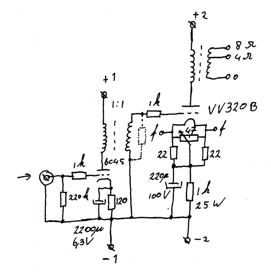

I have a D3a / 300B amp with a interstage transformer. The D3a is in triode mode. Is it useful to try the d3a as a pentode in this application ? Or can you say on forehand that the sound will be worse ?
Is hanging a CCS under the cathode of the d3a a useful idea ?

Hi Jaap (and others as well),
Kinda nice to see an old doodle I drew up years ago pop up once again. Now to adress your question... A pentode has a very high source impedance, which may even be considered to be infinite in "quick and dirty" type calculations. If you connect a choke (being the primary of the interstage) to an AC source with infinite impedance, you'll get a response that starts at 0 (or minus infinite dB) and rises with 10dB per decade ad infinitum. You made a mathematically perfect differentiator. Of course, in reality the tube has a finite impedance and there are more impedances as well which play a role, but generally an interstage transformer will deliver better bass when driven by a low impedance source such as a triode.
Or, you could also load the interstage with a resistor at either the primary or the secondary side (i'd opt for secondary). This makes the -3dB point well defined, and guarantees a more constant gain figure above the -3dB point. As you have a 1:1 interstage, the minimum value for the load resistor can easily be determined: it is the voltage swing required to fully drive the power triode, divided by the standing current of the driver tube. Experiment with values going up from there. As you already have the tubes wired up, I'd suggest just doing the experiment and let your ears decide what they like best.

Konnichiwa,
While the ultimate answer broadly relates to personal preference, in a limited sense.....
No footballing way.
Basically, pentodes like strictly resistive loades, triodes just love reactive loads.... (okay, it's the exec summary, reality is slightly more complex, I know, so don't beat me too much.)
Depends upon use. In your case, most likely no.

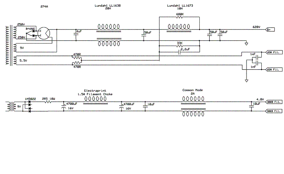

I faced my demon-- Jack will wind the opwer transformer, but he questioned the 5.5V secondary, so I just wanted to make sure that this is correct.
Should that final secondary really be 5.5v?
Schematic attached.
Thanks,
Kofi

Konnichiwa,
You typhically want to "underheat" valves at the datasheet limit.
If you do, they live longer (400%) and vary less in terms of Gm etc. over their life. The datasheet limit for 6.3V Valves is 5.7V.
In my case the 5.5V winding on the lady day transformer gave me nearly 6V under load, so even a little high. Get the transformer wound any way you like, just make sure to heat valves at the lower datasheet limit (+/-5%).
