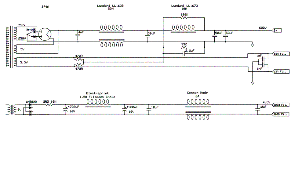

Now I have some power supply questions:
Attached is the PSU that Luis uses and I think its neato, so I'd like to implement it. What my dim brain has noticed is that somehow, he's using a 250V secondary to get 620VDC out. I'm thinking that this means maybe the diodes at the plates of the 274A rectifier are acting as a voltage doubler and the bootstrapping (is this the right term?) of the 5.5V supply is helping increase the voltage as well.
It could just as easily be pixie dust, though.
Also, I know that the 274A is one hell of a rectifier, but its also got one hell of a price tag. Could I use another rectifier here without much modification to the PSU circuit?
Also, anyone ordered parts from Jac Music before? They have a pair of TJ "Full Music" 274As that aren't go-knock-over-a-liquor-store expensive (about $150US), so they may be the ticket.
Kofi
Kofi Annan said:Attached is the PSU that Luis uses and I think its neato, so I'd like to implement it. What my dim brain has noticed is that somehow, he's using a 250V secondary to get 620VDC out. I'm thinking that this means maybe the diodes at the plates of the 274A rectifier are acting as a voltage doubler and the bootstrapping (is this the right term?) of the 5.5V supply is helping increase the voltage as well.
Kofi
That transformer is mislabled. It's actually a 250-0-250 center tapped transformer. But the center tap is unused, so the sections are in series, giving a 500v secondary. Since it's used that way, it should be labeled 500V.
I think that the 274b is the same internally as the 274a (confirm that with the experts here). If so, the 274b might be the better choice, since I believe its pin configuration and socket (octal) makes it easier to sub in other rectifiers. The 274b has a higher internal resistance than most of the substitutes, so you would get higher B+ by changing to something different. Also, some of the other tubes will tolerate a larger input cap. The best way to look at this is just plug that circuit into PSUD and play. You can't model the hybrid rectifier directly, but you can model a SS bridge and a tube bridge and split the difference in output voltage.
Sheldon
Wow! Thanks! I coulda made a bad mistake there.
So are the secondaries really 5V and 5.5V respectively? These seem like odd values. If they are, that's fine-- I can have one wound, but I'd just like to know.
Good news! I'll wait for the verdict from the experts, but I might just go ahead and do the 274A anyway. I always cut corners on these projects and just once I might build to spec...

The PSU has a 4uF cap in the first section, which I believe is appropriate for the 274A rectifier.

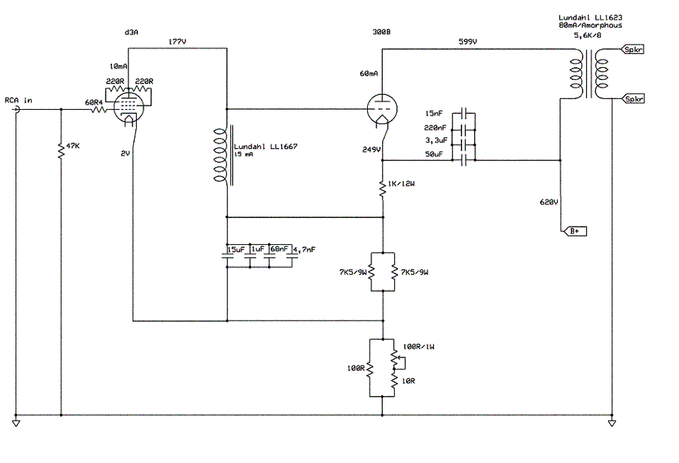

OK-- in the interest of understanding this design, I have noticed that the plate is putting out 60mA (quiescent current, I guess) at 599V, but that seems like waaaay too much voltage. I have been trying to plot the loadline and for a 5.6K primary and a 60mA Ic, we should be at about 336V, but we're not.
So the question is, how dumb is my next question, which is how can we have almost 600V at the plate of the 300b?
I know I'm gonna get slapped for this one and I'm gonna deserve it too, but I gotta know.
Kofi
Kofi
Actually you are at about 336V. The question when talking about voltage is; voltage with respect to what? Voltage is the potential between two points. When we are talking about plate voltage, we are talking about the voltage between the plate and the cathode. Your cathode is at 249V above "ground". Your plate is at 599V above ground. So your plate voltage is 599V minus 249V, or 350V.
