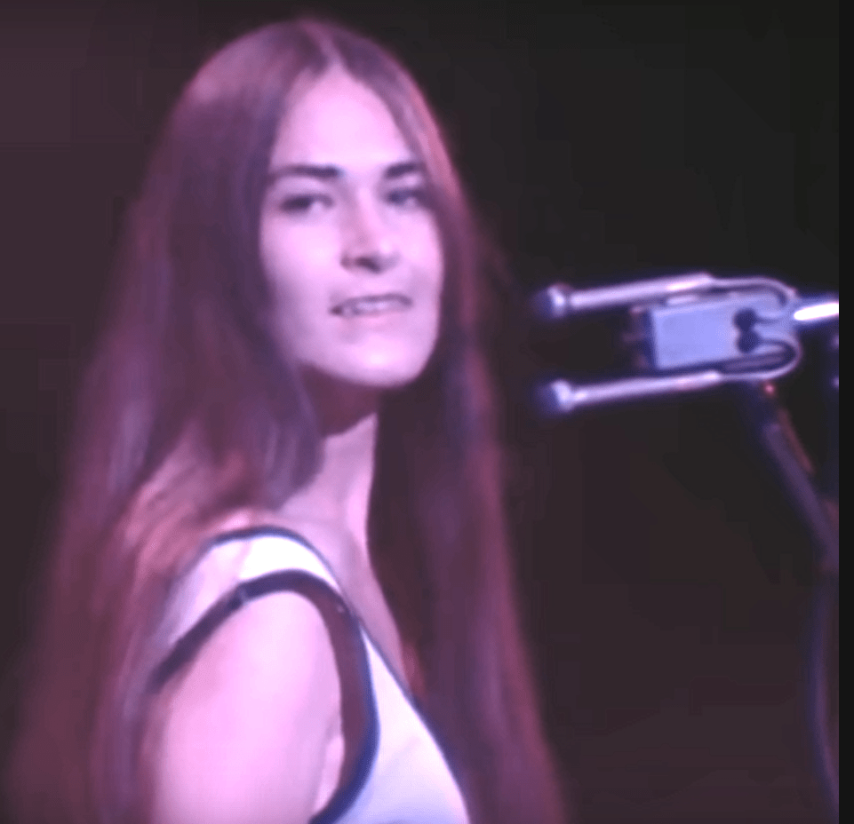

The above photo is an example of a far field cancelling mic setup. The singer vocalizes into just one of the two mics. Sound from well beyond the singer's position arrives at the two mics in phase; one of them is wired out of phase so that sound cancels. In theory at least; obviously a re-arrangement would be needed for acoustic guitar.
