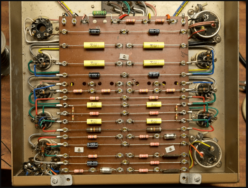

The opportunities for size reduction in a vacuum tube amp are limited. Each tube will generate considerable heat. It would not be easy to stuff them all into a single housing and remove all the excess heart with a water cooling system similar to what's found in a high end PC today. Each tube needs some space to shed its heat. Some space could be found by swapping a pair of octal output tubes for the quad of EL84's, but that might change the "tone."
The layout techniques used in that giant phenolic tag board can easily be put on a size reduction diet by the use of a modern PC board without changing the tone, but the tubes and transformers still need considerable space.

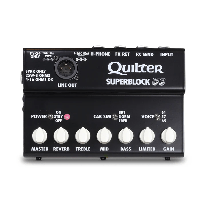

The Quilter boxes look neat, but most of his stuff is beyond my price range. The PC board looks deceivingly analog, but the crystal in the lower left is the give away that there is a digital clock running in the box somewhere. It could be a simple delay chip, or a full on DSP.
Reactions: Jim-Mellon
As a comparison, how much smaller/lighter is a Quilter Super Block versus a tube based preamp or even a complete low watt tube amp? Not a massive difference I would think. Actually it would be pretty comparable to them. The older gear with big watts (heavy transformers) and big cabs with 2 or more speakers, now those were heavy and bulky. The actual chassis of a say a Fender Blues Jr, minus the cab and speaker isn`t that massive. I am building a 5 watt tube amp right now that chassis weighs well under 10 lbs. It`s bigger than it needs to be to fit the controls on the front and back panels, and I wanted a bit of breathing space for future add-ons. I may add in another preamp tube, or a Jfet Boost, and maybe a reverb driver circuit.

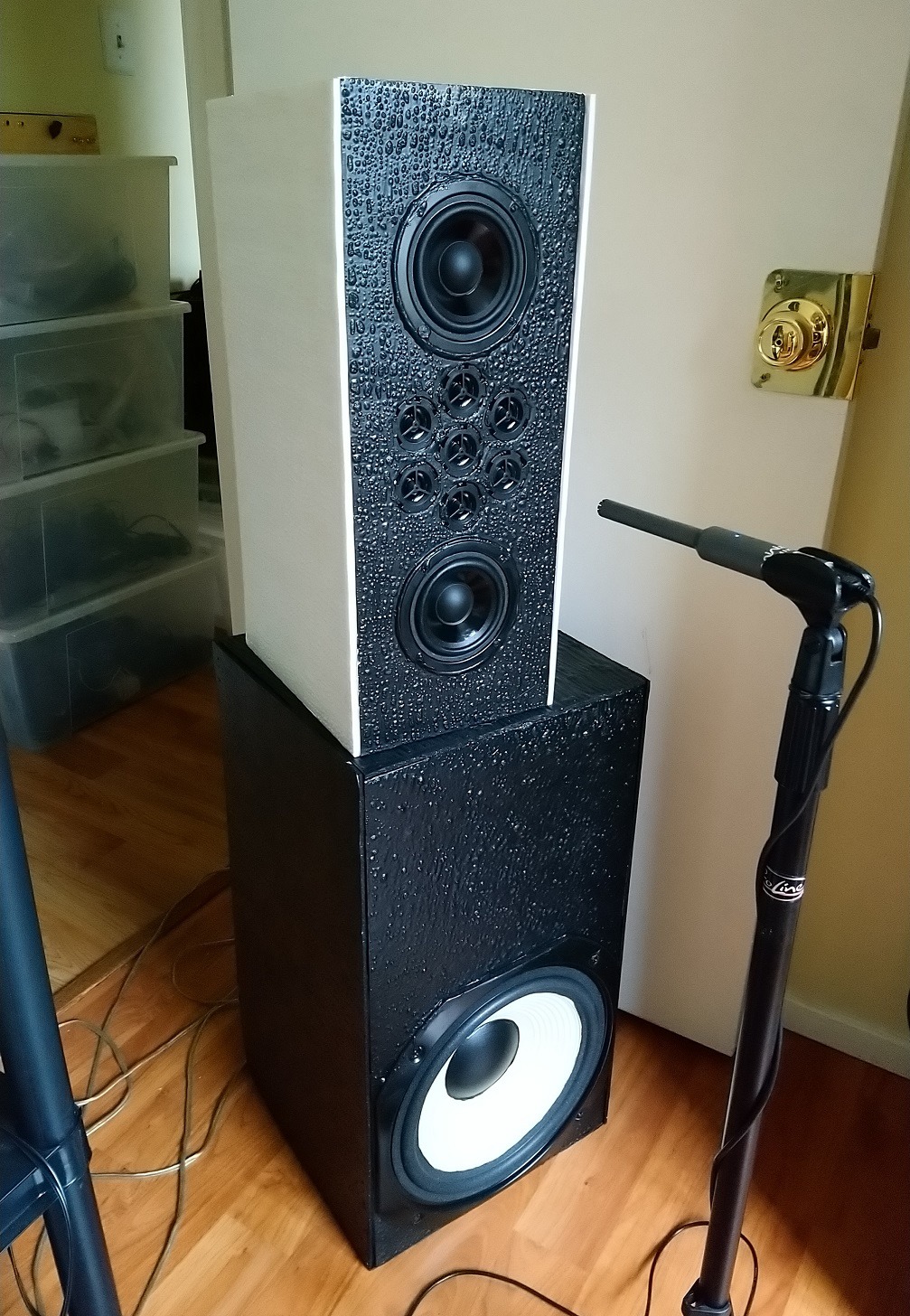

The hardest thing to really emulate properly is the speaker. You’d have to hit a cute little 4” full range with 200 class D watts to get the raw output of a 12 driven by a 5W tube amp. You need one that will handle it, which further reduces the sensitivity. And you will never get the same off axis nulls, even if the breakup peak on axis is perfectly modeled. Baffle diffraction won’t be the same either with a smaller box. For typical guitar cabs it’s in the midrange, not the bass part of the spectrum, too.

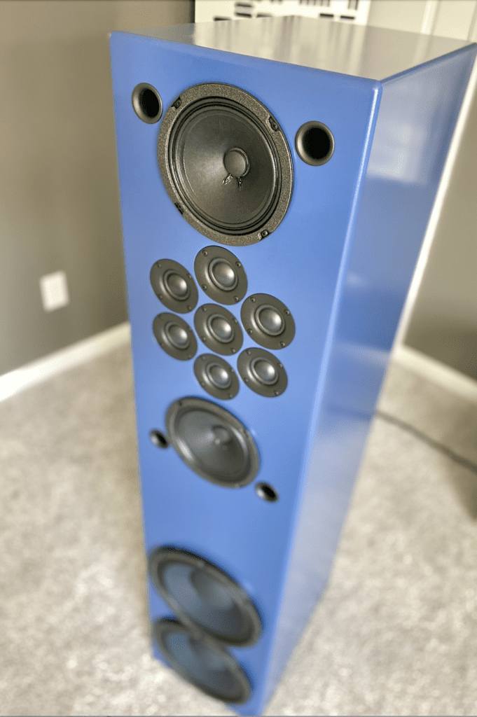

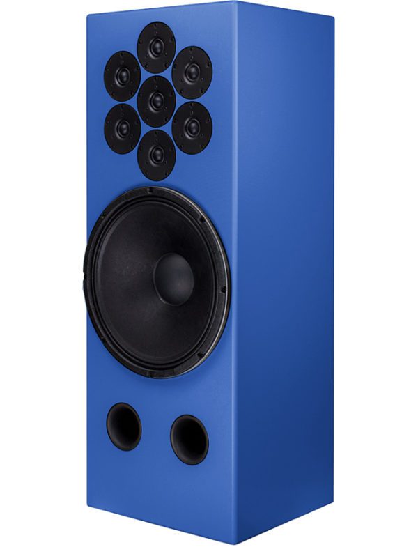

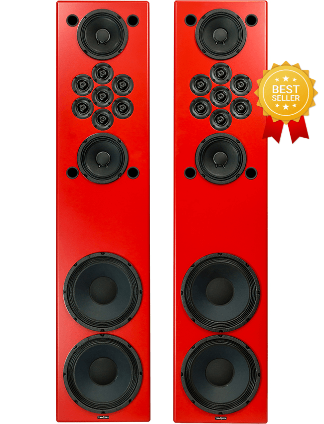

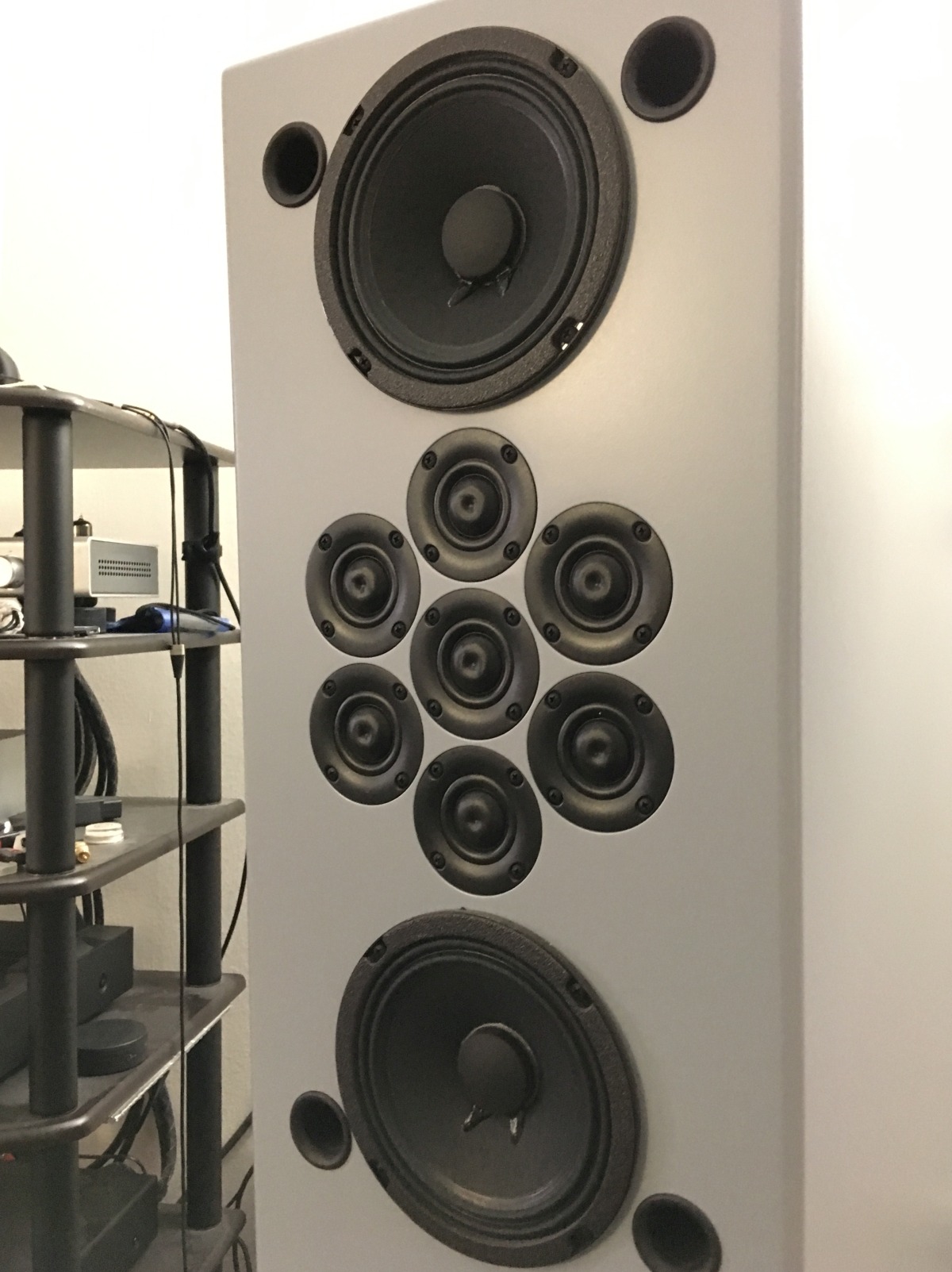

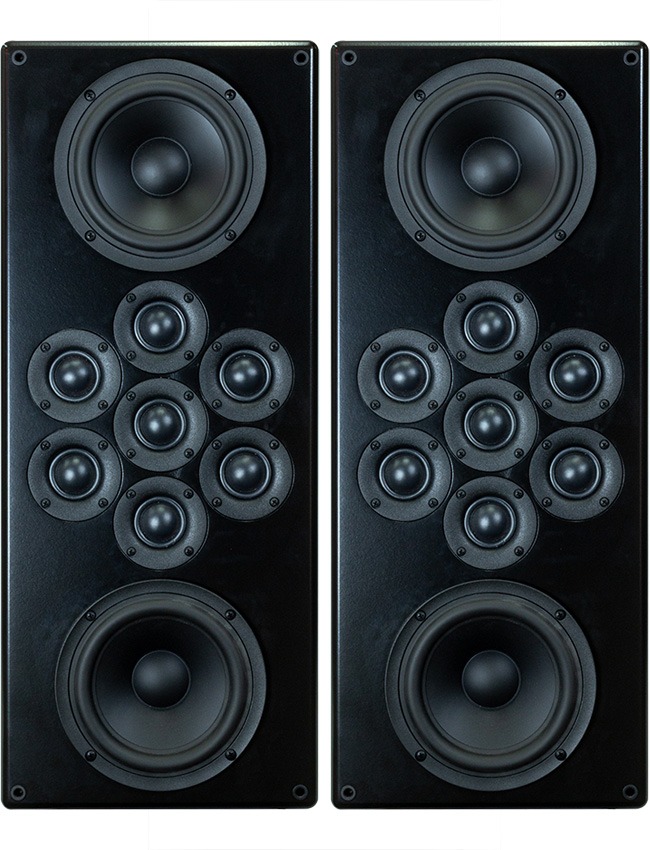

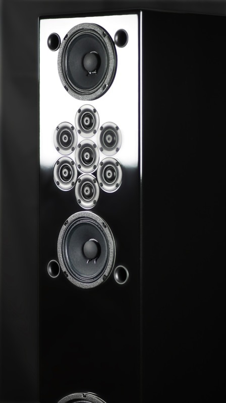

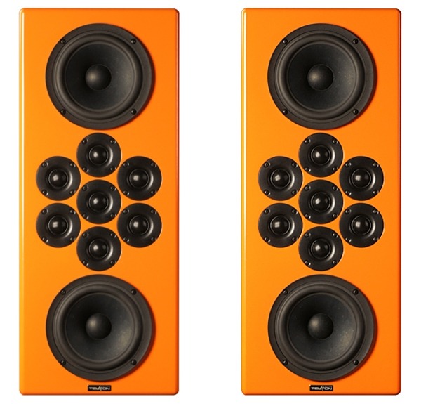

So you are curious about tekton array? Have you heard it? Measured it? Built it?
Why are you posting my tekton speakers?
I built probably hundred other speakers. Why these?
