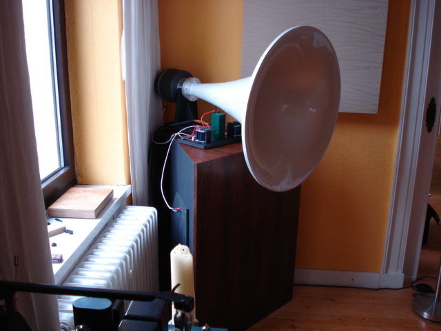

I hope it's a 511. It would tough to think you could get 800Hz from the woofer off the walls and such. Even 500Hz seems a bit of a stretch without it being a trifle washed out or muddy and as John says:
400Hz to pass the torch? I might think even lower than that would help. But, as everyone knows, if it sounds good... 😉
Time alignment is a REAL problem.
I meant - as highest usable F ;
once - in a previous life - I made tube pre , tube PP monoblocks (for squaker and tweeter ) , tweaked some sand amp for woofs and tube 2-way xover ;
all that for KH , what else ;
I made a mistake listening to owner ( not measuring original xover ) - he told me 500Hz is good point ;
some 400km later , I decide that 375Hz is best I can , for both woof horn and original K400 ( if I remember correctly ) ... even if K400 is running of steam that low , on 18db/oct electrically
remaining elements from passive xover were just matching xformer and cap on tweet
Yes, I was wondering if even that might be a bit high.
Cheers.

I am puzzled in looking at that picture. Don't you need a top (something solid, covering the bass unit and running from wall to wall, covering at least as much area as the mid-range assembly) on top of the Klipschorn bass? I thought the design required it and Klipsch wanted it?
Yes you are right, the top plate is removed in the picture.
As concerning the bass it's not critical. Some even prefer the KHorn slightly pulled out of the corner. The weak point of the bass horn is it's upper end; it hardly reaches 400Hz. By crossing the Jabos at about 200Hz this problem is also much improved.
It' s important having real room corners, not some sort of room divider.
