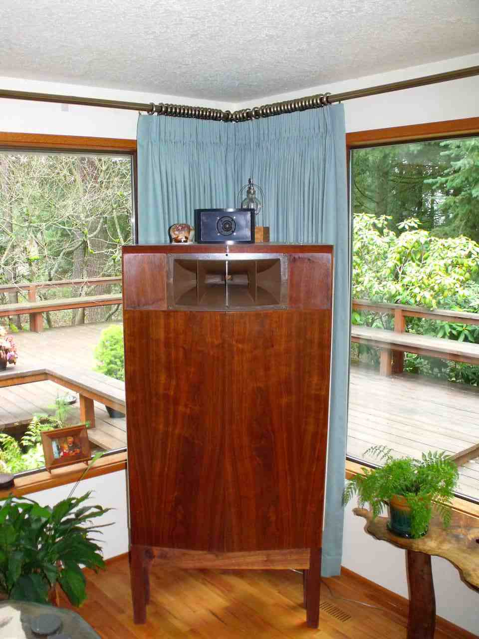

I built a pair of Klipsch "K" horns from plans. They are BIG! As I remember, the LF is an Altec 415 15", and HF is a 608C driver with their #511 500 Hz sectoral horn. An additional super tweeter sits on top in its own box. The super tweeter doesn't add much that I can tell.
If anyone is crazy enough to build these things, the plans are probably available. My plans came from Radio & Television News, April, 1955.
Beware! There are MANY small pieces, many of which have compound angles--not a job for a beginner in woodworking!

The Klipschorns are classic...but are they truly a good horn to build anymore? I'm asking, I really don't know offhand. A lot more theory and art has been ascertained since those were designed...and the original horns, being rectangular, will have time-response problems...
Mr. Unit,
The Klipschorn is an excellent horn, which is why they're still being made. The advance in theory and computer modeling has certainly made it easier for ordinary people to design horns. However, Paul Klipsch wasn't an ordinary person and laid down a lot of the foundational work on horn theory.
BTW: Your last sentence doesn't make any sense theoretically or in the real world.

To all. Thanks for your good thoughts. These K-horns are actually "corner" enclosures. The LF sound comes out the back, and the corner walls act as the final part of the horn. Since the LF wavelength is so much longer than the corner (or the room, for that matter) phase differences are non-existent. The HF horns face straight out, toward the listener.

Is there 'another' version of K-horn? I've never seen an 'elevated' one like this. (and floor-standing by itself is so tall, already!)
The bass sound is supposed to exit from both sides of the cabinet in the original design, the cross section area of the path (in this part) is defined by the top plate, walls and floor. Now the whole cabinet is elevated, the 'terminus' would be larger - the floor is now further away... How does this affect the sound?

To CLS. For many years, these Horns stood on the floor. When we moved to a new place in Oregon, the speaker locations happened to sit on a needed air vent on the floor. The "feet" were added so the air conditioning would work!
I should mention that the plans in Radio & Television News were called the "Georgian", by Electro Voice, and the author was Gene Souther, an employee of EV.

Thanks for the explanation. How do they compare? I mean floor-standing vs elevated.
I've had some very brief experiences with K horn (and I was very much impressed). I remember the bass sounds were quite different between [right at the corner] and [slightly pulled away from the corner]. The corner helps a lot.
So I'm curious how the feet works. Also, in the picture above, your horn seemed not been pushed into the corner. Is it because of the glass and curtain?

You know, I really haven't done any experimenting with placement. My old house had solid corner walls, and I just spaced the speaker about 6" away from the corner. This place, as you see, has glass but also drapes (that I can do nothing about!). Again, the spacing is mainly for practical reasons to be able to move the drapes.
Since the bass is already powerful (!), I really don't think it could be any better by moving the box around some.

Couple of things I noticed:
I think the LF drivers are the 416's not 415's as I can't remember a 415 and the 416's are very common.
The HF are likely 806's or perhaps 808's not 608's as again I don't recall a 608.
That horn looks to be the 811 unless my eyes are not adjusting to the scale of those cabinets. They look pretty much the same but the 511 is bigger than those look. The 511 is 24" wide. Could be wrong though, those are truly big magnificent speakers. I just wish I was allowed something like that inside. I'd be in heaven.
