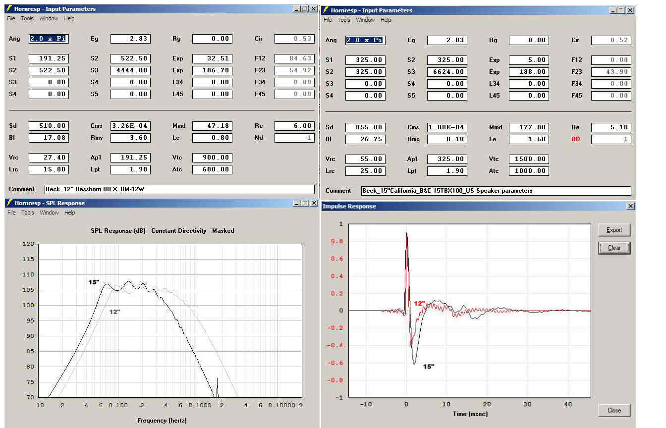

Beck's Horns in Hornresp
Hi moray james,
You asked for a model of the Beck Horn:
BEC2Biex
I modelled it and the:
15" Bahorn
in Hornresp. The speakers used are listed in the input screens. I used Nd for the 12" and OD for the 15" to reflect the difference in throat position. Both horns would benefit from more length and a larger mouth, but then, what else is new. They also are a tad wasteful in their use of internal volume, but should be relatively easy to build. Not as easy, or going as low, as jbell's SS15s though.
Hope you'll find this useful.

Thank you Oliver: they look ok and yes the JBell cube is an easier smaller build and does go deeper. I will file this away and keep them in mind for a guitar cabinet for later. I think I will take the advice of William Cowan and DJK and look into a PPSL cabinet to run with the Unity horn. The idea of adding some small 6.5 inch woofers with serious travel onto the unity such as is done with the Danley SH50 is also an attractive idea. Then all the drivers would be coaxially loaded down to well below 100Hz. and a sub such as JBells cube could handle the bottom octave and a half. Thanks for the help here. Lots to consider. Best regards Moray James. l
